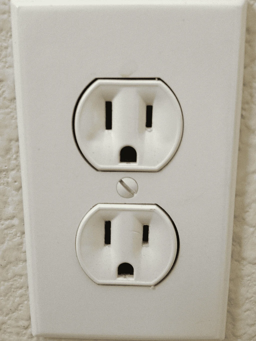

Well, I should have also stated that a 5-15 is basically useless for charging unless you only need to add a few percentage points overnight, so I don't consider that a viable option when traveling.

It did come in handy staying in the middle of georgia nowhere. Chattanooga was the closest supercharger, stayed in the hills at a resort for 3 days it charged it enough to get it to knoxville.

Even charging a 131 kWh Lightning for 3 days on a 5-15 can add more than half the capacity so I agree. It's impractical but doable.

I have used a 5-15 when available, but It's not something I can rely on, especially with a battery that is close to 2x the usable capacity of my S.
Regardless, this thread isn't about what a 5-15 or 14-50 can do since those come with the Ford connector already. This is about being able to charge on a variety of other receptacle types that Ford doesn't (yet?) provide.
