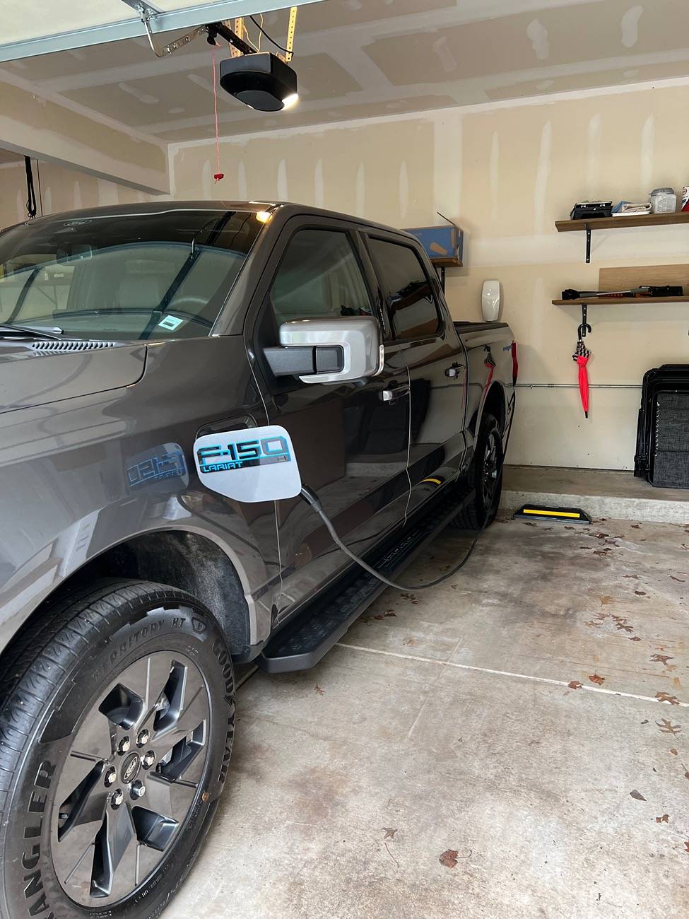

quick follow up and thank you to everyone who replied and provided some amazing feedback!
I was about to order a new Tesla universal wall connector to install on a different wall in the garage when I noticed the cable length is identical to the gen3 connector I already have (for some reason I was convinced it is 18 feet, it's actually 24 feet.)
As soon as I connected the dots I ran to my garage and re-parked the truck in my garage (luckily I had the original gen3 connector installed in between the 2 spots of a 2 car garage door opening I have and was able to fit the truck so that the truck bed would not interfere with the cable and voila!
the wall to bumper distance is about 10 inches and the distance from wall to charge port of the truck is about 18.5 feet so this gives roughly 5 feet of "slack length"... this is using the Lectron adapter I bought. have been testing this configuration for the past few days, seems to work and not put undue tension on the connector at the wall or at the truck when plugged in. So for anyone who can set up this configuration in your garage, a Tesla gen3 WC or Universal WC have IDENTICAL cable lengths and when parking to allow the cable to reach past the corner of the bed will reach the charge port!
Excellent news!
Don't kick yourself for the misunderstanding. Some original Tesla Wall Connectors only had 18' cords.
It's also nice that you have a built in wheel stop when backing up so you don't hit the wall. Just remember to not hit the tailgate release button after backing up. :)

Thanks! I bought those wheel stops for my wife to keep her from scraping the splitter on her Mercedes on the concrete step. I just "borrowed" one and have since put it in correct position to let me know when to stop. They're the Pyle ones on amazon, pretty cheap and sturdy. Have been using them for about a year.
