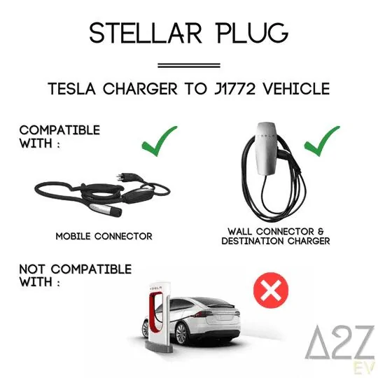

What Tesla adapter? There is NACS to CCS1, which you use at Superchargers, and there are NACS to J1772, which you would use with the "wall connector".
They are not interchangeable. If you are trying the NACS to CCS1 adapter you got from Ford for SuperChargers it won't work. You need to get something like a TeslaTap or A2Z NACS to J1772 adapter.
If you are using a NACS to J1772, I read there is a compatibility mode that may need to be enabled on the wall connector, it's outlined in the manuals.

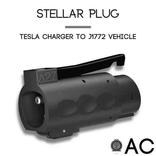

Lots of folks use a NACS Level 2 charger / Tesla destination chargers and pair it with an adapter to use it on their vehicle with J-1772 plug.
I would recommend the A2Z Stellar NACS to J-1772 adapter which is available for $92, compact build, has a built in lock, good customer service / warranty and overbuilt for futureproofing.

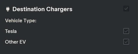

You can use the same Tesla Find Us link to locate Tesla Level 2 destination chargers.

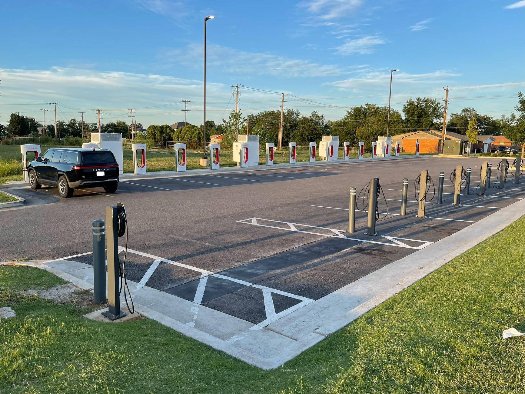

Here is a good example of 10+ free level 2 AC Tesla destination chargers 8 kW - 16kW charging available at a grocery store only if you have an adapter. This is commonly found at malls, shopping center, movie theaters, etc.
The Rivian you see is using DCFC level 3 with an adapter
