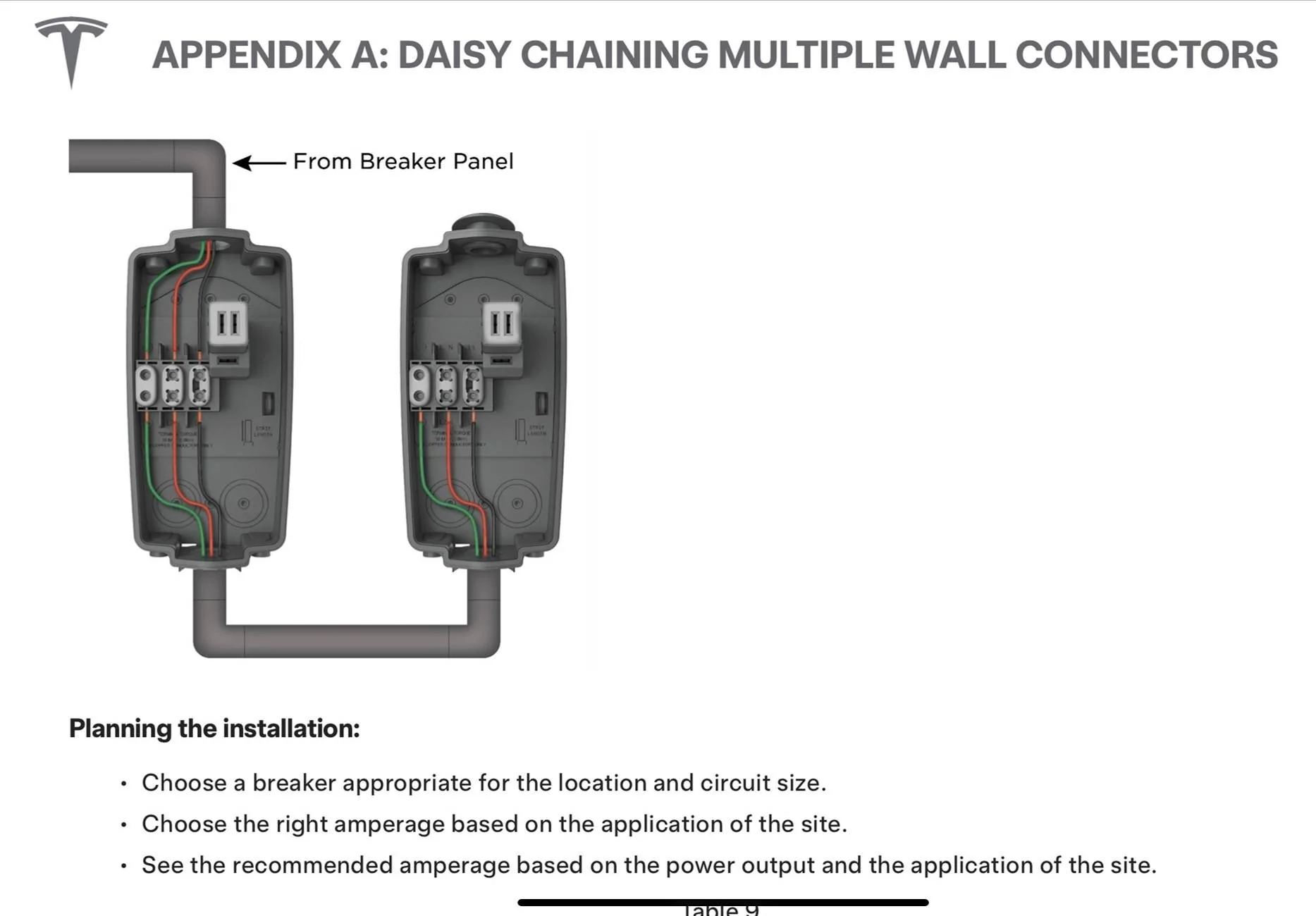

I have 2 Universal Wall Connectors, both on their own 60A circuits.
If both are active they use wireless power sharing to limit themselves to 60A total. Otherwise, if only one is charging it gets the full 48A.

I got a Tesla UWC and it’s power sharing with a pre existing Tesla Gen3 WC,
daisy chained. Awesome setup.

What code would that be?
On page 35 of the most recent Gen3 installation manual shows that you can use " GROUP POWER MANAGEMENT" Group Power Management Setup With Single Branch Circuit..
A Gen3 at the end of the daisy chain line only requires one lug per wire input, so essentially it isn't daisy chained.
The beauty of the Universal Wall Connector is that they provide 2 lugs per connection to easily facilitate Daisy Chaining them
https://digitalassets.tesla.com/tesla-contents/image/upload/gen-3-wall-connector-manual.pdf
Breaker and Branch Circuit Setup Group power management circuits may be installed in an electrical panel that supports other loads. If space is limited or the main power supply is far from the Wall Connectors, installing a dedicated load center may be prudent. See below for examples of Wall Connector group power management diagrams (one with sub-panel and one without). Each individual Wall Connector in below examples is capable of providing 48 amps when it is the only one in use. As more Wall Connectors begin plugging into vehicles, the system will automatically distribute power based on the total power allocated to the site.
@Maquis called it out.
That said, you can still control the Gen3s to load share via the WiFi just on individual branch circuits to prevent overloading. Or if your area hasn't adopted the code, if you don't get inspection, then that would certainly be a YMMV situation for daisy chaining.
