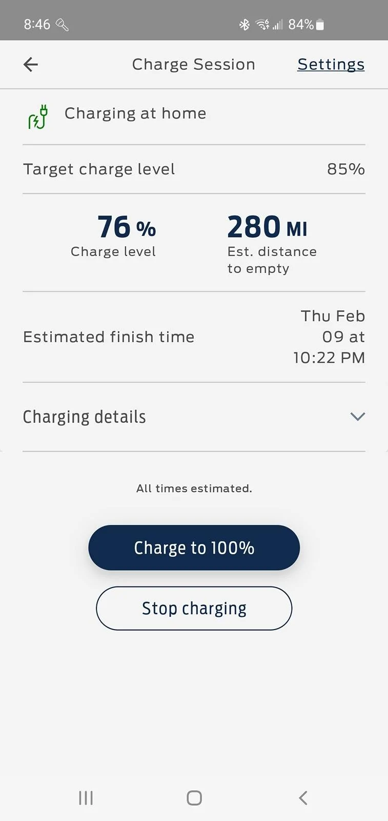

Started a charge session at home within the last hour. Ford Pass indicates an estimated completion on February 9th. Time might be correct but date is definitely not. Anyone else had this issue?

I've seen odd dates in the past, no rhyme or reason, BTW what did the "charging details" window show for the rate of charge? How many KW's?
Thanks for the response. Charge rate at home is 6kw. Just using Ford charger on 50 amp circuit.
Given those numbers, it seems it would take about ~2 hours to charge from 76 to 85%, the hourly value is in line, but the day certainly isn't.
Yes get the wrong date of completion every time. I just ignore it as obviously a future software update no worries
I only got the wrong time/date once, and found that the truck's clock was off.
Now I always get a very close estimate of time, with the correct date.
