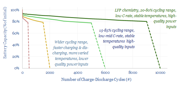

BTW, if the Ford batteries are good for 1,000 charge cycles (0-100%) before degradation (some estimates put it between 1500 and 2000 charge cycles), then...
If a full 100% charge on an SR battery equates to 240 miles (will vary depending on many factors such as driving style, terrain, ambient temperature, etc.), that then equates to 240,000 miles driven before battery degradation.
Of course many factors can speed battery degradation, for example:
For longer life, more charge cycles, it is recommended not to charge an EV battery beyond 80% of its state of charge, or below 20% of its state of discharge, as degradation is amplified outside of these limits, due to the physics of the Nernst Equation.
Fast charging also speeds degradation because of the heat generated.
Summing degradation (to 80% of original capacity) all up in a chart:
Ford F-150 Lightning Ford performance tune for standard range lightning Battery-Degradation-Simple-Schematic
In lab tests:
Battery lifespans range from 500 cycles to 20,000 cycles, depending on conditions.
The best conditions for long life spans of lithium ion batteries are using LFP chemistry, charging within a limited range, at low charge-discharge rates (C-rates) at a stable temperature of around 25C (77F). This might be associated with a decline rate for batteries of around 2% per 1,000 cycles.
