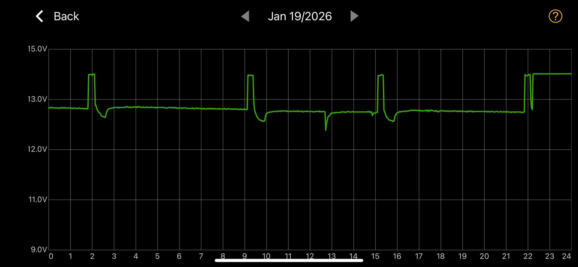

Sorry but that randomness DOES sound like it could be a 12v battery or 12v system issue.
I think it’s worth a conversation. If my monitoring method shows 13.1 to 13.3v when parked and the truck off for hours, how’s that misleading?
Also how is the 15v when running misleading? Does that not mean that the dc to dc inverter is charging the battery as it should?
FYI, I have a trickle charger which I’ve placed on the 12v before, just to rule out this very thing. Guess what still happens? Through this forum and other sites I’ve also received feedback that other non-EV Fords have this same issue. Ford’s that have much more robust 12v batteries. Is it possible in all cases, the 12v could be low? Perhaps. Is it likely? No.

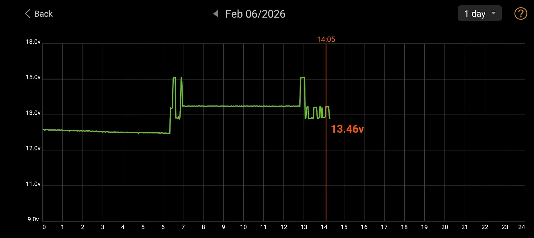

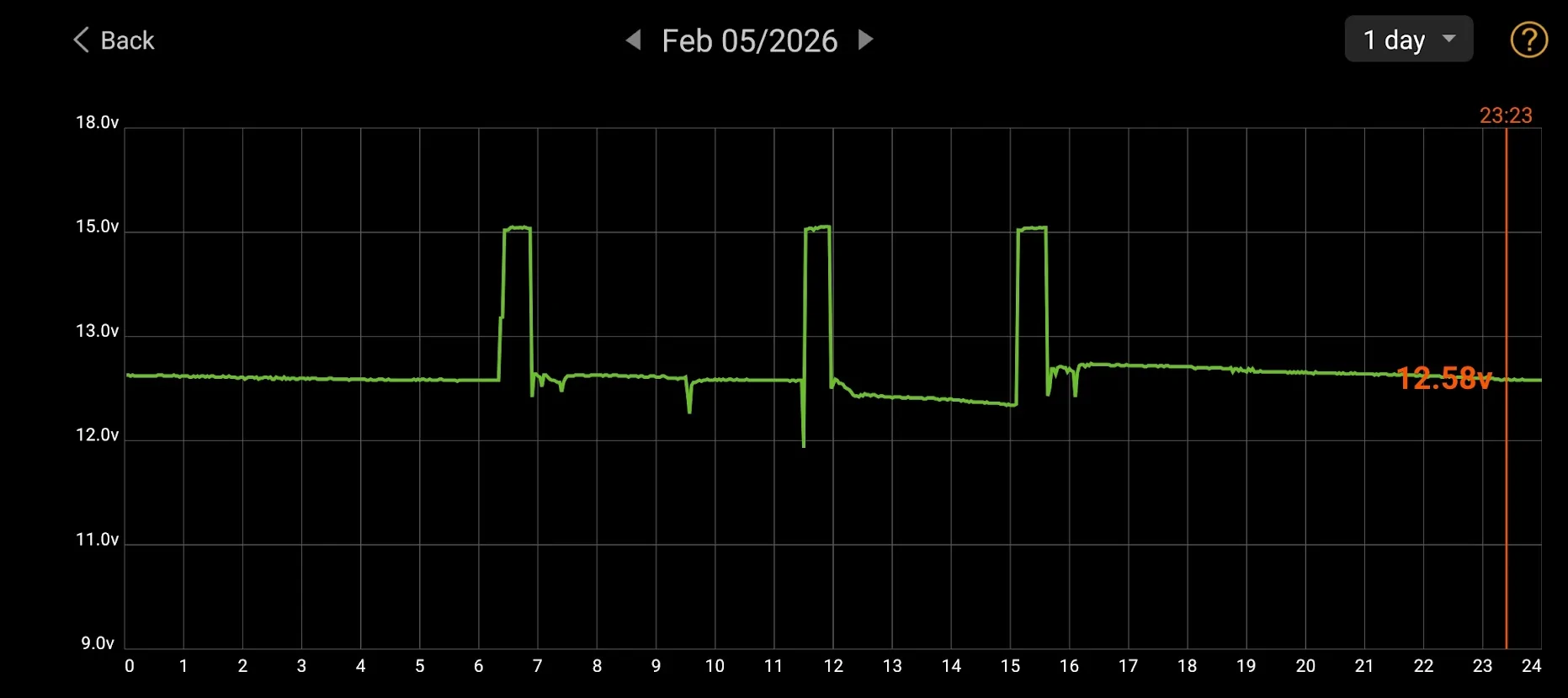

In fact, I see that the battery is currently at 15.4v with the truck plugged into its EVSE in for about 30 minutes or so.
When the truck is actively charging the hvb, it will charge the 12v. Yours must not sit very much if you're usually seeing 13.1. I barely saw that immediately after shutting the truck off much less now that I have a hardwired dashcam.
Yesterday I drove to work, didn't charge, went to lunch and then went home. Looks like it dropped about 12.5V-12.6V overnight. Was 18F when I left this morning. Went to work this morning and charged where the voltage was floating around 13.5V. My drives are fairly short so doesn't do a great job of keeping the 12V topped up. At this point the battery is a little over 2 year old.
Nice! Out of curiosity what are you using to track voltage?

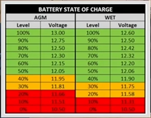

1) 12.6v for an AGM is not fully charged, but more like 85%.
Ford F-150 Lightning Ford Quality Battery SOC chart-AGM vs Wet
2) the real question is how long can it hold that charge...so to determine that you generally need to wait an hour or so after a charge and measure the drop in terminal voltage that occurred, if more than a few tenths of a volt, the battery is suspect.

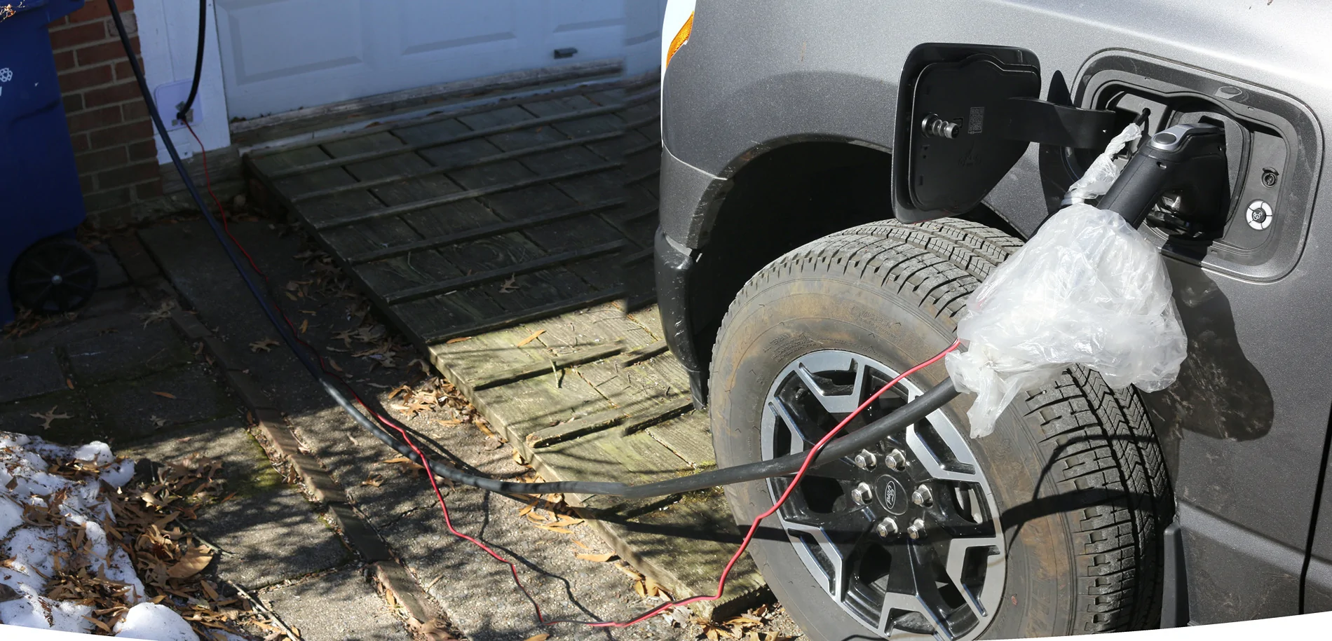

Some of us owners on this forum have made it easy to plug in a maintainer by putting a wire near the CCS1 charge port - no harder to mess with than plugging in the CCS1 plug - actually easier!
I have my NOCO Genius1 plugged in inside my garage and run a 10ft SAE extension cable along side the CCS1 from my FCSP to the truck (the NOCO needs and adapter bc they use a proprietary connector):
Ford F-150 Lightning Ford Quality IMG_6049-50 merge-FCSP and Battery cables outsid
The plastic bag kept the charge port area free from rain ice and snow. Below is a close up without the CCS1 FCSP plug and plastic:
