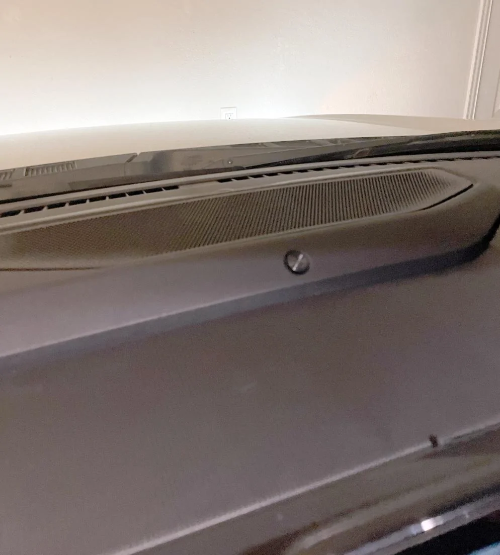

So far the only thing I have noticed is the center speaker grill has started to come off
Mine came like that in case it makes you feel any better... I had the same "at least it doesn't rattle" opinion.

I can see mine start to blink
just took mine off. Six tabs, two close to windshield will split so be careful. Clips in front pop up no problem. There is no flat surface to add double sided tape, none. I’m thinking heat gun next?

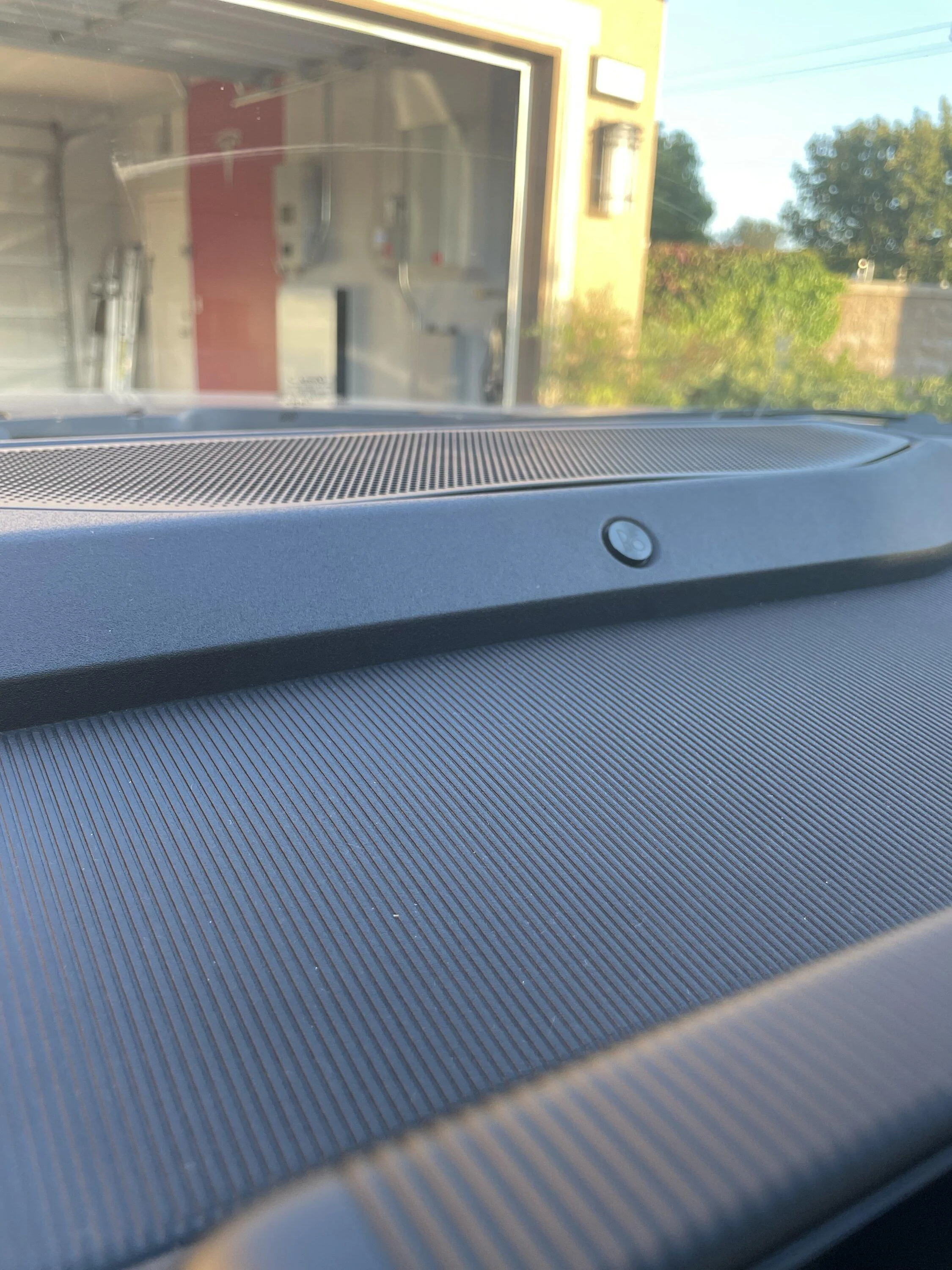

I tried a very small piece of clear rubber double tape, and laid something heavy on top of the speaker grill last night, and this morning it was laying flat.

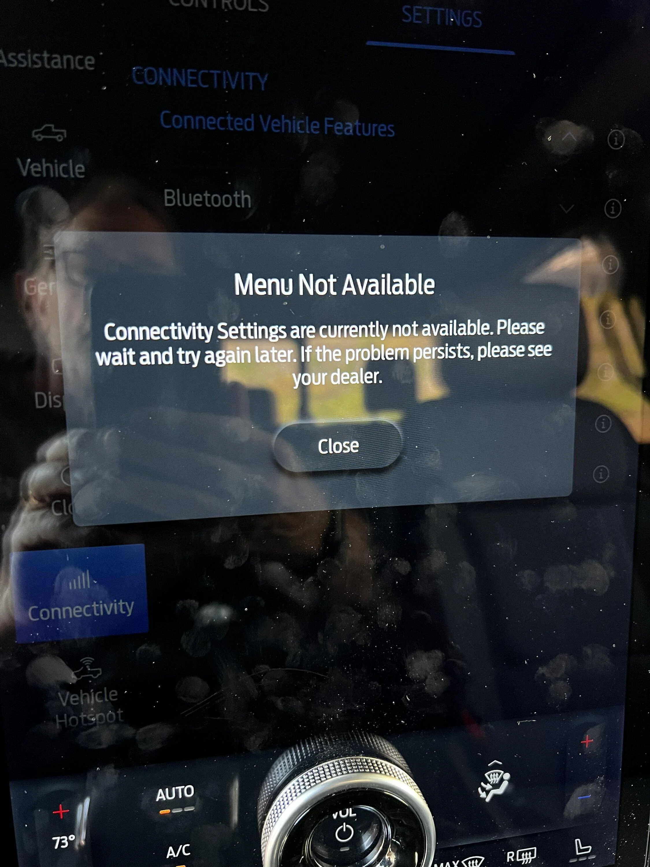

I have had this same issue. Menu not available. No connectivity. I think I know what is happening. They told me the same thing to set an appointment after step 3 below. but I fixed it myself after that by realizing my wife had the Fordpass on her phone... see below.
I think there are two things happening: There is a Fleet Lock that was on my truck preventing the modem from functioning. If your modem is still off, that is probably your culprit. Easy test is to try and connect to your home wifi or go into your connectivity settings and see if you can se any networks.
1: Fleet Locks can be removed by the tech people. They may have already done it over the phone if you called the Ford Tech people. That could be an unrelated item though. The tech people have to get approval to remove it. It was on my truck though so I assume it might be on some others. Came ~60 days after my purchase. After they did this, the modem was able to connect to my wifi at my house. I suspect that this is what is happening with your truck.
2: In my case, I had removed my vehicle from the Fordpass app at some point before. I am not sure this was necessary or not.
3: I had heard that there was an update to the FordPass app during my conversation with the tech people. We tried removing it and reloading it from your phone. In my case, I did this but then could not still add my vehicle back. This is where they told me to make an appointment with the dealer.
4: I then realized that my wife also has the Fordpass app on her's, so I removed the app on hers, as well at that point. Once I did that, I was able to add my vehicle back in my Fordpass App. Everything started functioning again.
Its a long story but I learned how to restart the system and a lot about how the Fordpass app and the modem work.
How to restart the system: Hold the down volume and the Skip button on the steering wheel and hit the lock button with the car on. You get a honk and flashers twice. Forgot if the door needs to be open...
Anyways, hope any of this helps someone going through the same issues.
Edit: Of course, after I post this the connectivity monster pops up again. Again I go through the same issues with not having the modem working for some reason (or it was actually working but not allowing me to see my home network (or any network for some reason). After troubleshooting, they came to the same conclusion that I need to take the truck in to have the modem "hard reset". Of course, after I get off the phone I then realize that there may be something going on with the Fordpass App being on two separate devices. I asked and the guy (for what it's worth) said it can only be on one (not sure if that's true though). SO I redownload it on my wifes phone, remove the truck from that phone. Remove the truck from mine again. DO the key switch thing where you hold the volume down and track skip (right) button for 10 seconds, open the door and hit lock and then close the door. Then add the truck back on my phones FOrdpass app. Then activate it. FYI... The truck cannot be on when you hit the activate button I guess either. Everything loaded right back up and all is working again. Keeping it off my wifes phone for now to remove another variable and we'll see what happens. Still planning on getting the truck into the dealership next month (next appointment available)...

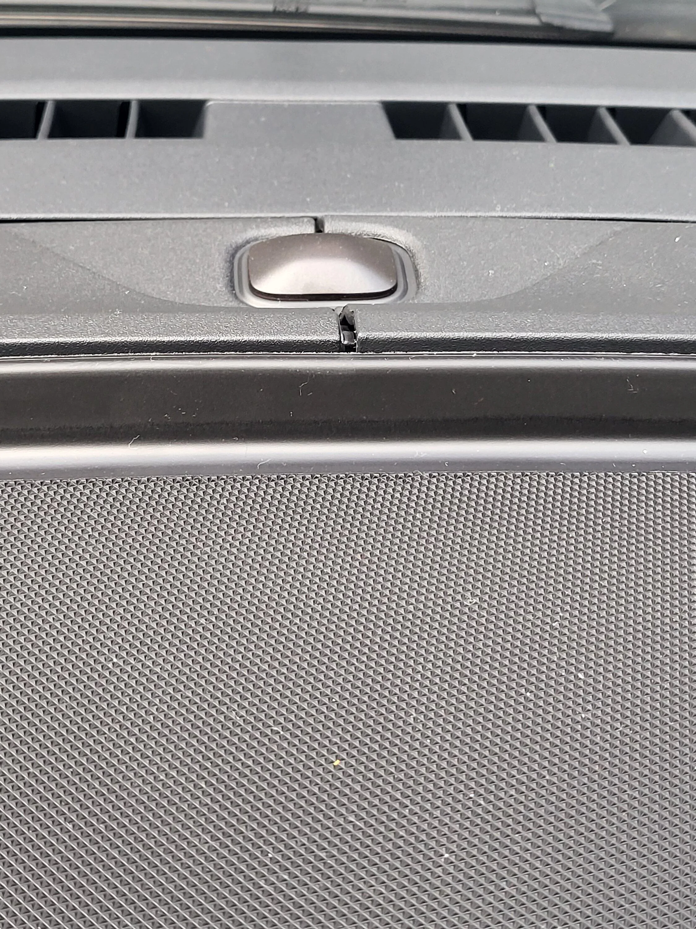

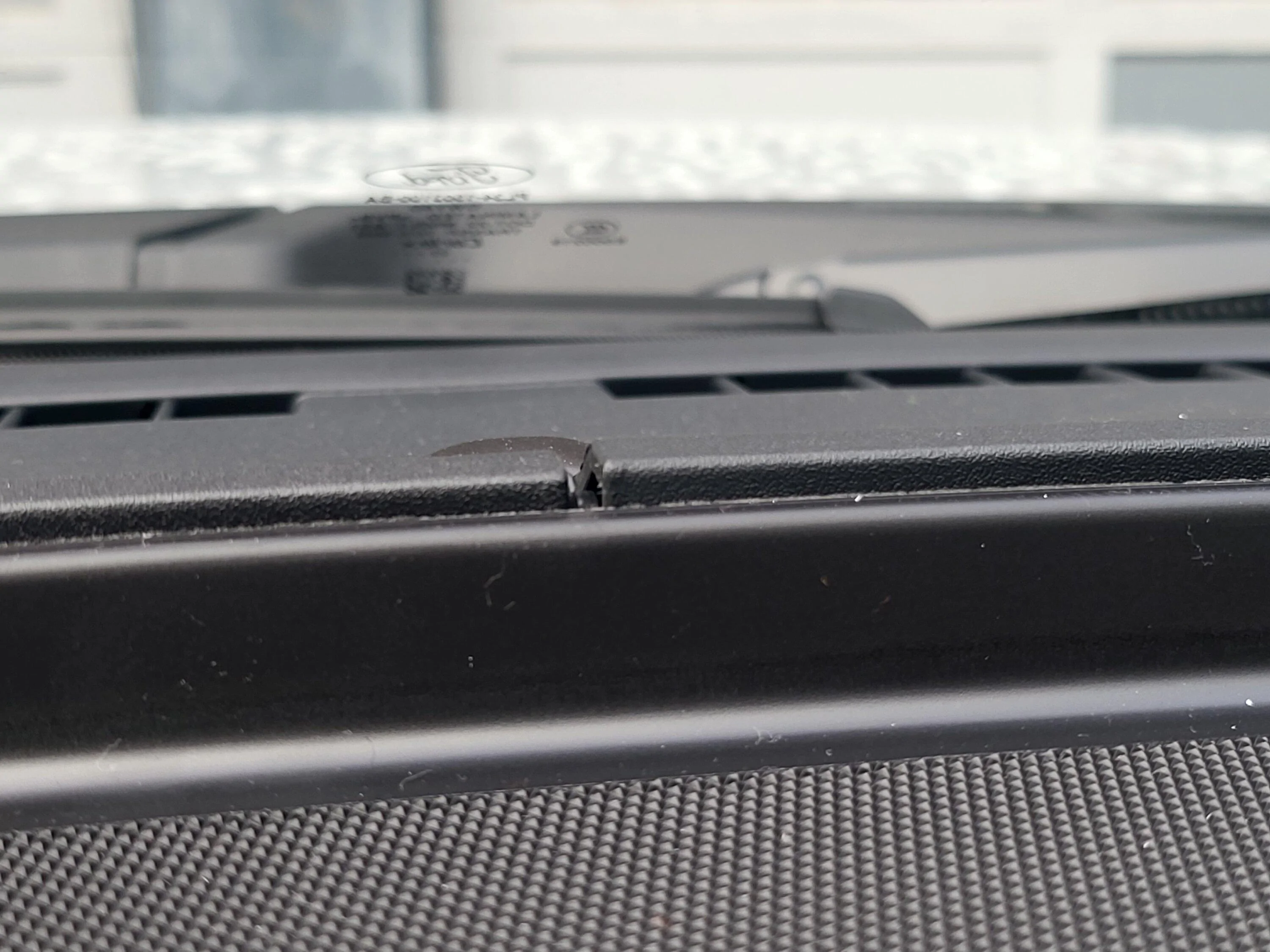

Curious if any other Pro/XLT owners have this wide and rough of a gap on top of their dash?
Ford F-150 Lightning To the Owners - Any Build Quality Issues Noted? 20221212_134701
Ford F-150 Lightning To the Owners - Any Build Quality Issues Noted? 20221212_134706
Yellow Buddy
Feb 5, 2022
2,511
3,372
Mid-Atlantic
Smart Ass
You do know that if we do, we're all going to hate you for pointing it out to us right?
I mean I haven't noticed anything and I'm really hoping I forget to check the next time I jump into the truck.
