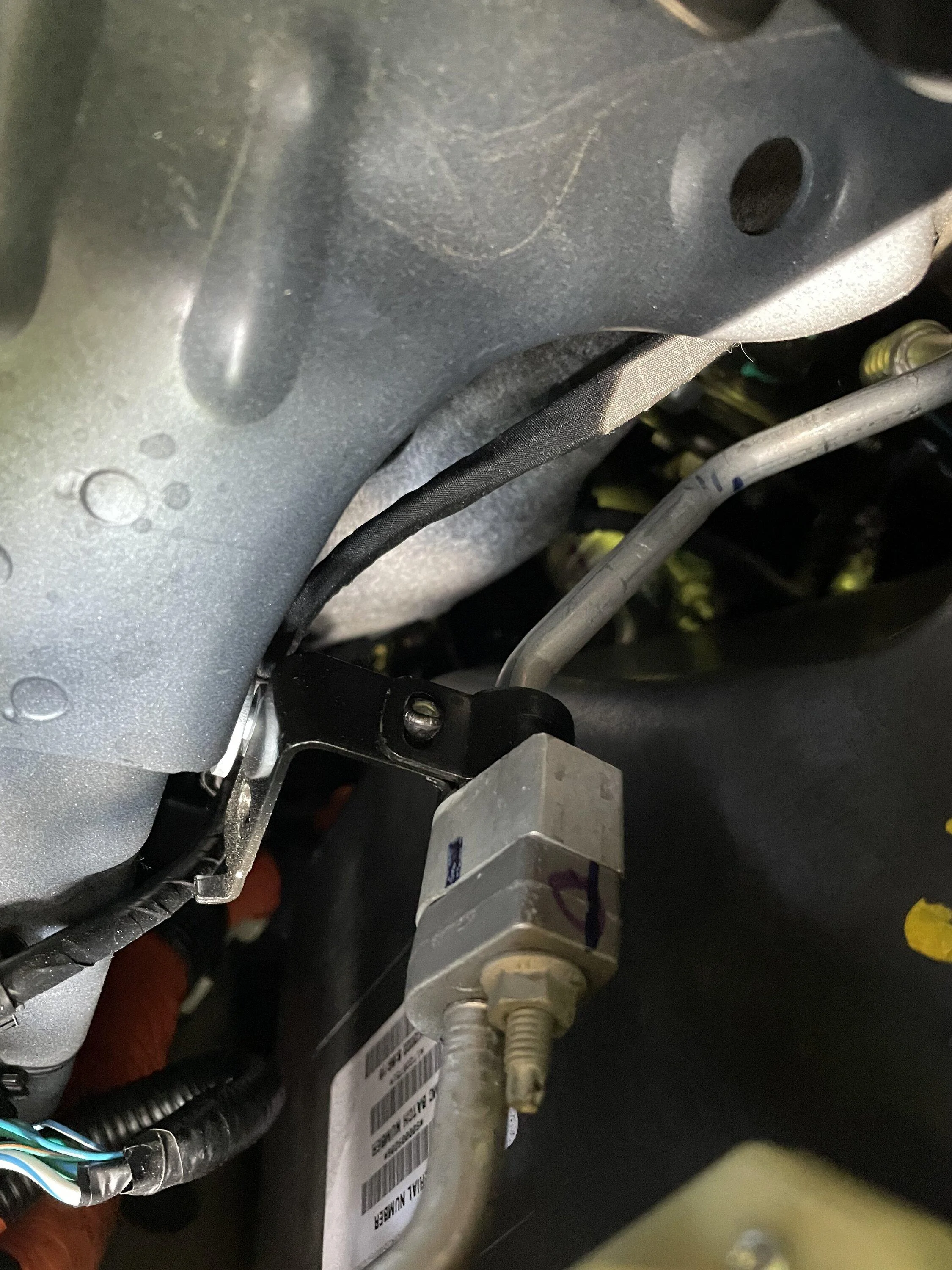

There was a rattling noise when using the AC that was bugging me on my first weekend of ownership. I was in the woods camping with my family and didn't want to track down a dealer, so I started poking around. I found two coolant line bracket bolts that were not fastened, it looks like at one time they were installed in the production process, but were removed for some reason and never put back together correctly. I fastened them and the rattling went away.

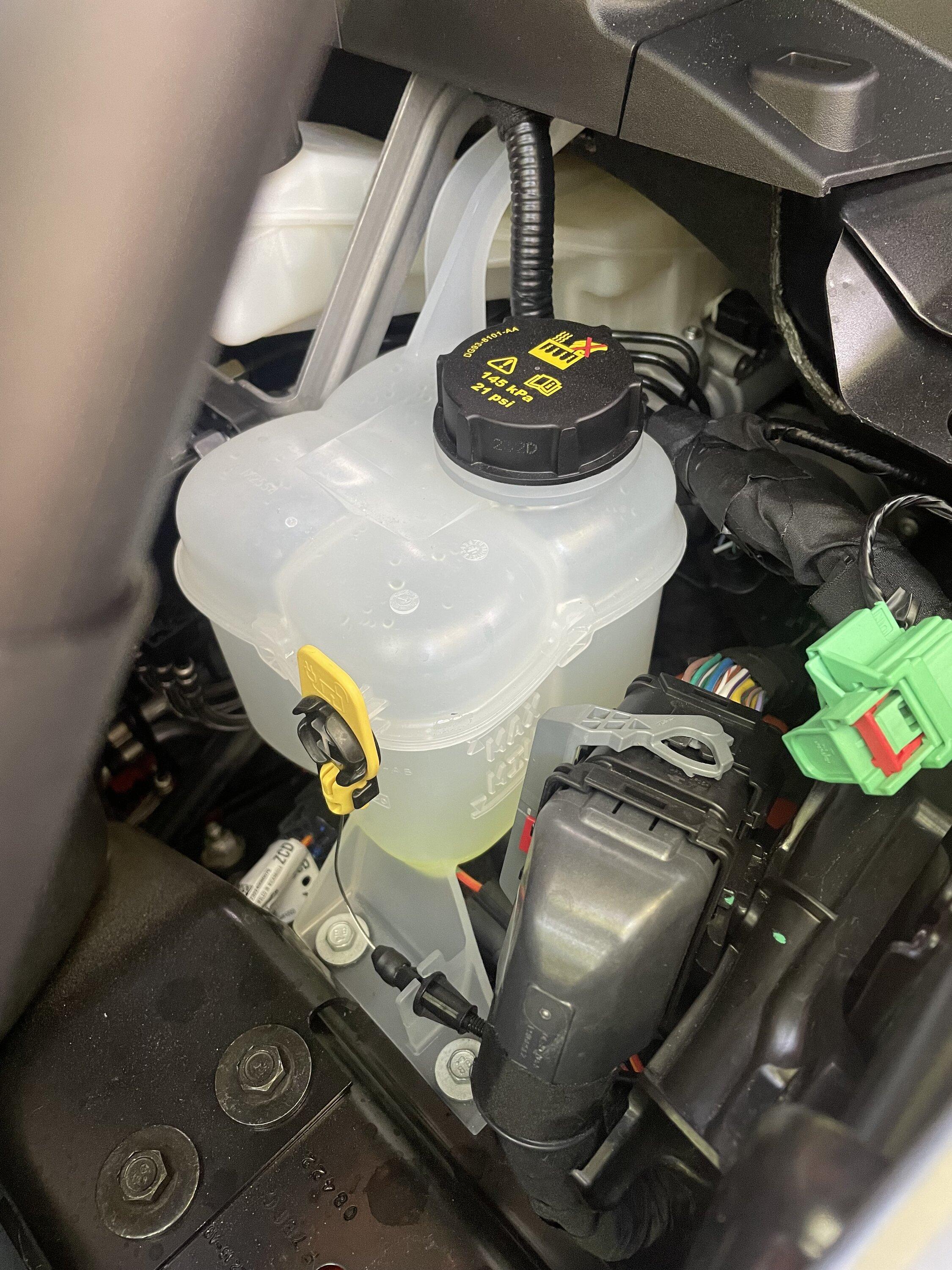

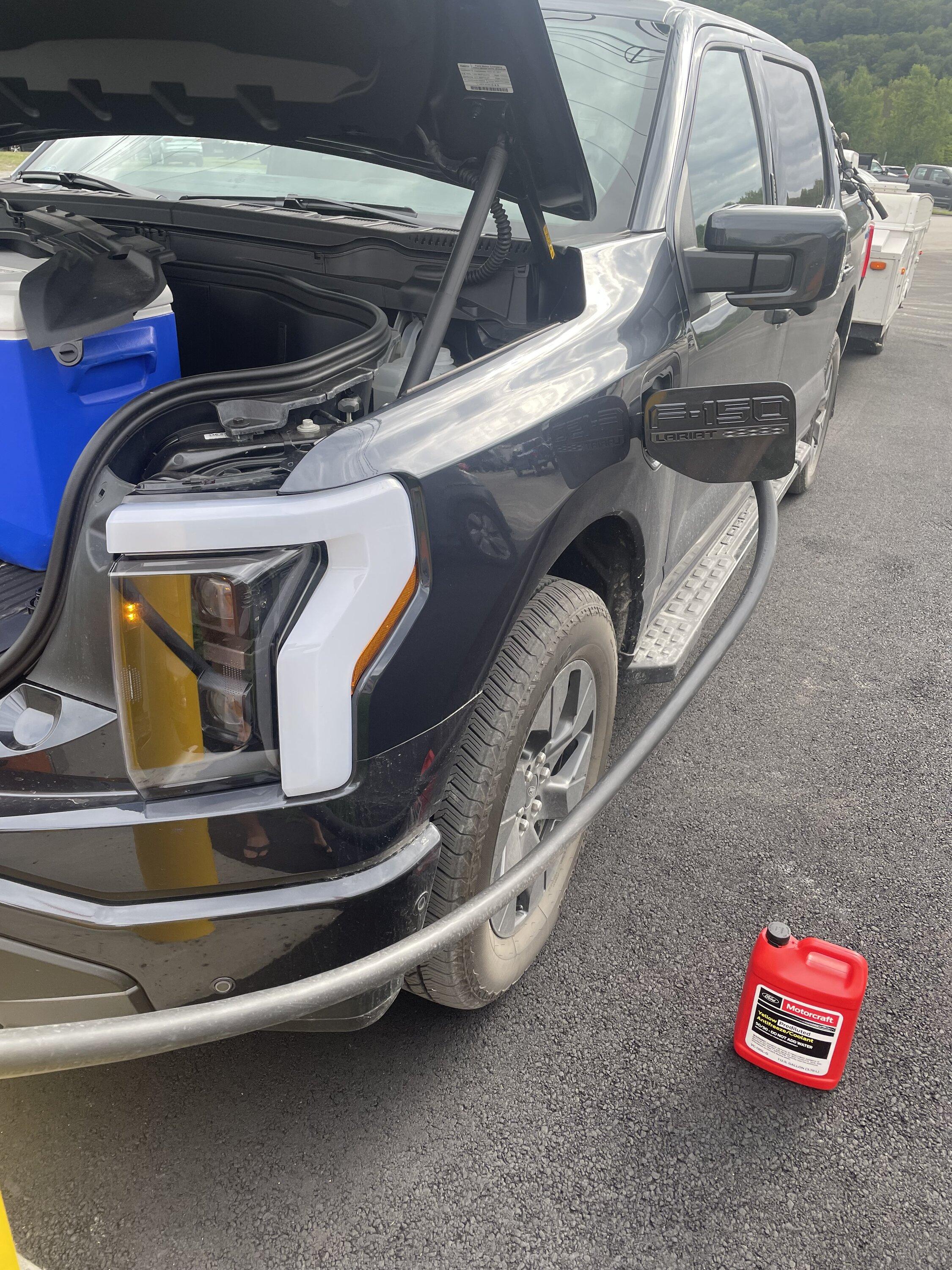

I had an "almost" empty battery\HVAC coolant tank, Fortunately a planned stop at a dealer with a fast charger allowed the service folks to come out and fill it up for me. It has held steady since, so I suspect it was never filled completely at the factory, and is hopefully not leaking.
same here. Checked it the day I purchased only out of curiosity. Not low enough to have needed to refill just yet, but far closer to “min” than seems proper for a truck being Delivered

Mine is at the “Min” line as well. My expectation was that it would be at the “Max“ line when cold. How are the MMEs set up?
4,418
5,930
Just the opposite. Coolant expands as it heats up. I’d expect to see closer to the Min mark when cold with the level rising as it heats up.

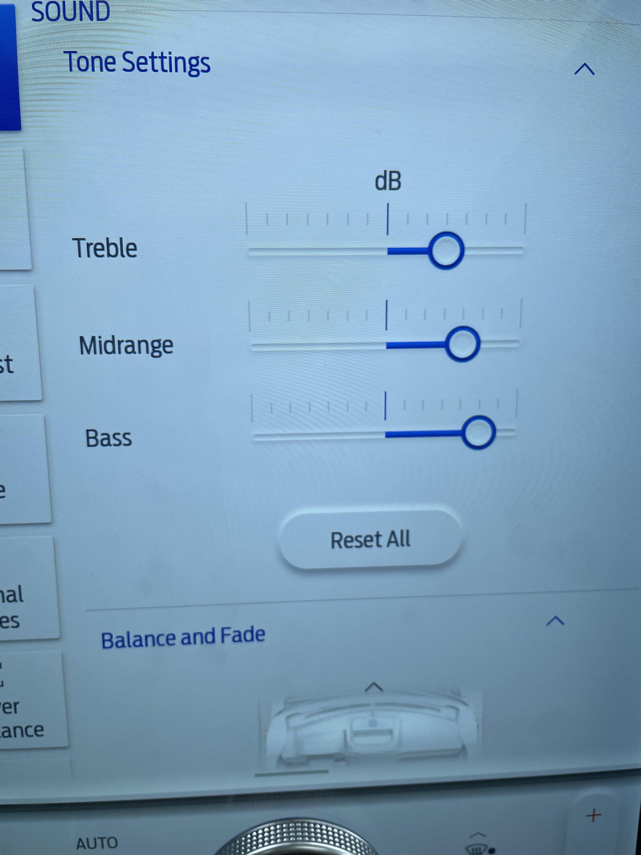

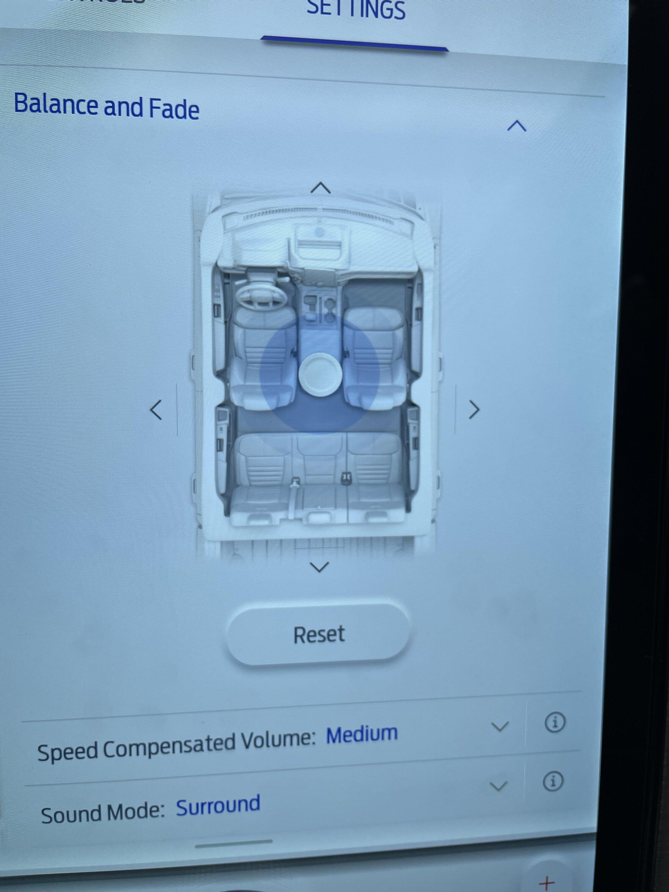

Rod, I also at first thought it was absolute crap. B&O on the ER lariat.
My buddy (studio sound guy)tinkered with the sound settings when he was a passenger. It now sounds MUCH better than it did. Still not mind blowing but totally acceptable, at least to me? YMMV
First, he put it in "surround" mode, took the base up a bit, the mids up a bit less, than the highs. Listen to all sorts of music and talk, all sounds pretty good!
Nice! I’ll give these setting a shot!
