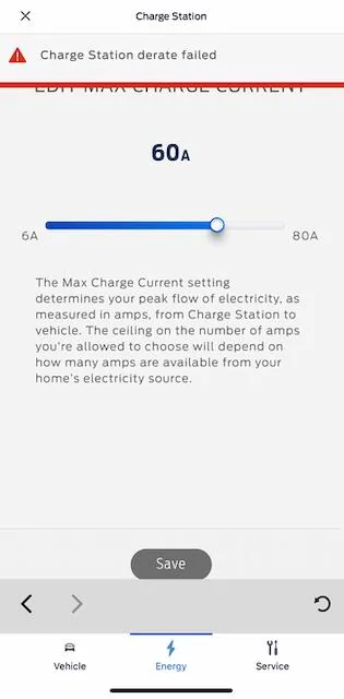

Since at least last week, I get an error on FordPass app when attempting to instruct my FCSP to "derate" (well, more "uprate") from 60 amps back to 80 amps. See pic. (Before you ask, it's on a 100 amp breaker. Yes, 60 A is adequate for most of my needs. Before I derated it to test that specific FordPass feature, it worked fine at 80.) That's what I get for playing with the software... at least it still charges, but at 60. I didn't dare test to see if it accepted a lower amp level! :facepalm:
I called Ford and was informed that it's a known issue that is being investigated. No estimate on resolution time. The squirrels powering the servers must be on vacation.

The hard setting (potential breaker max amps) is still on 80 amps but the FordPass setting is determining how much actually gets sent to the truck.
UPDATE: today (8-16-24) the app actually did allow me to change setting to 80 amps!!!!
Sir Charging Squirrel must have come back from vacation!
