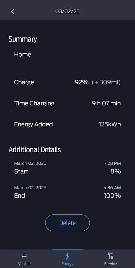

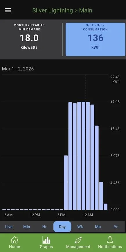

Yes the start time is corrupted when a charging session continues past midnight.
In the snapshot, it started 7:28 PM Saturday evening 3/1, to charge finished at 4:36 AM, see the Emporia energy log to the right
