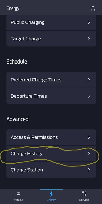

After plugging in at home, I attempted to change my target charge back to 80% and it wouldn’t save. At this point I noticed there were no charge session details displayed besides charge rate. Weird. I checked charge history while looking through the app for any settings to toggle/reset and saw that it stopped recording sessions after my FPL EVolution stop, which is also strange considering I literally paid for one through FordPass on the way back.
So far I’ve tried deleting and reinstalling the app, changing the name of my “Home” charger in FordPass, restarting my phone.. Still can’t see any charge session details or adjust my target charge. Is there some kind of reboot I need to do on the vehicle side, or any other way to get the app to start working properly again?

One more point, I'm assuming you're looking at "Charge History" and failing to see your successful charging event data, note the Fordpass event record is by design sparce on details, start/stop time/SOC and total KWH received.
Be aware that "Charge Station" only records data from your FCSP at home, this data only appears after you unplug the FCSP from the truck.

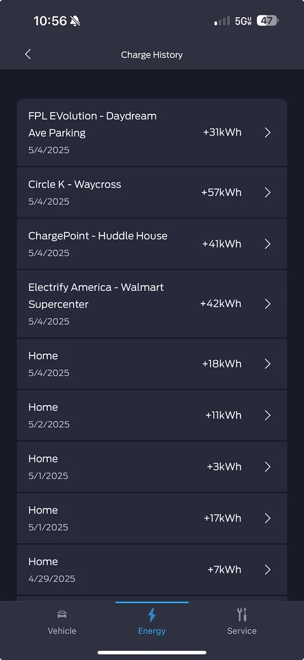

Also I’ve definitely had it record data from charges away from home! I’m not too concerned with referring back to that data, it just indicated to me that the issues began halfway through my trip.
