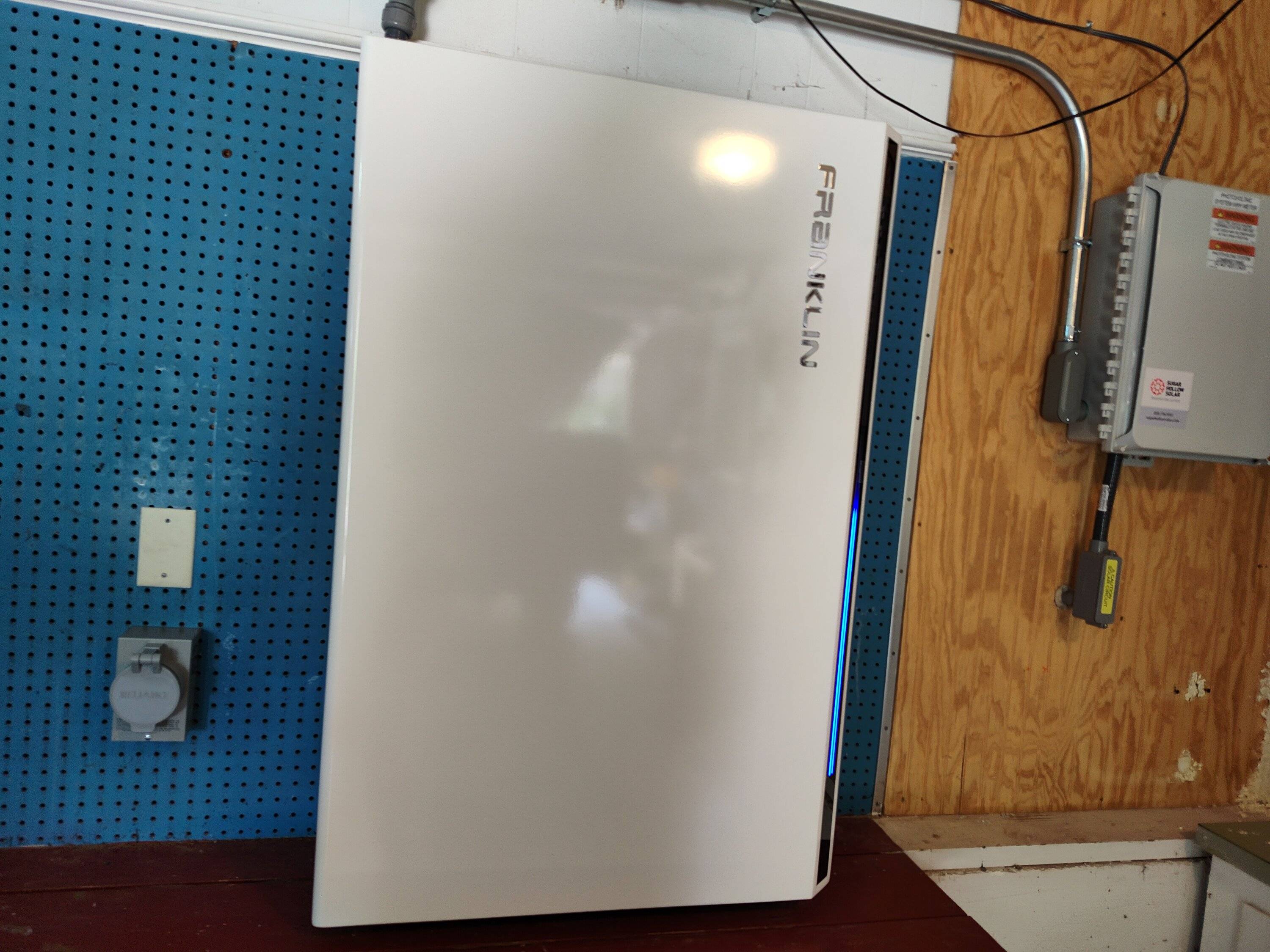

Glad you have your system working and it is a great write up. Unfortunately it really belongs in its own thread or tied to a similar thread. This setup will not work with the Franklin whole home backup battery (or other hybrid inverter systems like PointGuard and SolArk) because the generator (or truck) is not the sole source of power, and there is no way to switch the neutral and divert the load wiring. There is already an automatic transfer switch as part of these systems.
You might be able to add a manual switch like the Generac to bypass the existing system and connect to the truck, but it might be a more complicated wiring challenge.
Perhaps you would have to ask the Franklin folks for guidance on how to do it since your Franklin system has an automatic transfer switch. You might have to disable the automatic transfer if that is possible.
I think a competent electrician could probably figure it out with help from Franklin if that would be what you wanted.
I think what the problem is with the GFCI tripping when hooked to your Franklin system is that the neutral in the Franklin system side of your system is bonded, and it expects at it's gen input an UN-BONDED standby generator source.
Removing the ground connection from the Lightning is not a safe code compliant way to solve the problem.
Since the Lightning cannot be un-bonded and you need a continuous ground for code compliance, to get around the tripping you would have to hook the Lightning up to your service panel through a separate neutral switching transfer switch. Much the same way I hooked up my two transfer switches. The Franklin system would be like the "other transfer switch" in my drawing.
The neutrals from the loads have to be accessed inside the service panel and the backed up circuits have to be transferred to the Generac transfer switch.
