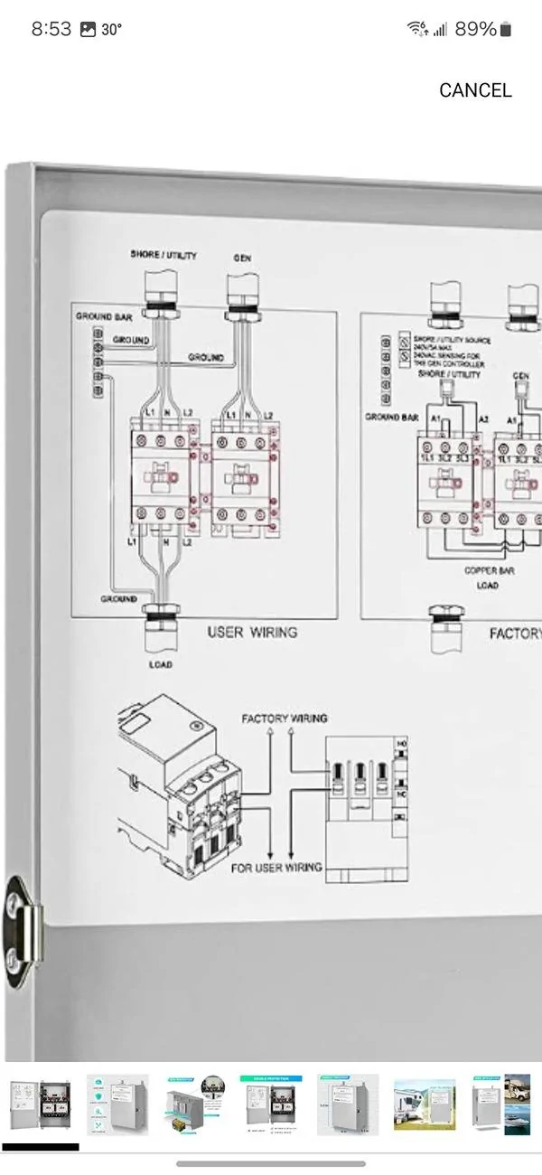

Are all the circuits connected to the transfer switch isolated to a single sub panel? The simplest way to think about the Lightning's GFCI is if neutral touches ground (earth) ANYWHERE it will trip. This is why a neutral switching sub panel is required to make it work without pulling the ground wire.
Edit: the bolded paragraph is wrong. All grounds need to land at the main panel.
If I understand this diagram (don't assume I do, I'm an idiot with a wifi connection), the switch is grounded to the main panel (shore/utility), the Lightning (gen), and whatever circuits are being powered (load). If your system is wired like this Pro Power will never work with the ground connected because everything is connected to the main panel which means it's connected to the grounding rod of your house. In this case it doesn't matter if neutrals are switching or not.
As I often mention, I'm not a professional. I learned what I needed to work on my own stuff. I'm trying to be safe and follow code but I definitely have a knowledge gap.

Thanks. I moved all the neutrals to the sub panel but didn't move the grounds. I need to double check that my transfer switch load output isn't neutral to ground bonded somehow that isn't obvious. I'm assuming the transfer switch should have continuity between the load neutral and ground on grid power but not on Pro Power.
What really confuses me is the grounding when the sub panel is connect to Pro Power. So a sub panel has to be grounded to the main panel per code, right? Neutrals and grounds separated in the sub panel and the grounding lug removed. When using Pro Power the sub panel has two paths to ground (through the main panel grounding rod and the truck's GFCI. Are two paths to ground appropriate? Not seeing any alternative.
Paths to ground (for grounding conductors) is irrelevant.
The key is that the neutral and ground are only bonded in one place. On grid power, that’s the N-G bond either in the main panel or meter. On truck power, it’s in the truck.
With all power off and the transfer switch in backup position without the truck plugged in, you should have no continuity between N & G in the subpanel.

So I should take the ground from the Lightning Pro Power directly to the subpanel bypassing the transfer switch grounding lug? Then remove the bonding screw in my sub panel.
I edited my original post. My thoughts on grounding were wrong.
If there is a bonding screw on your sub panel you should remove it. When on truck power the only path to ground should be through the truck. If neutral and ground are touching in the sub panel the truck GFCI will trip.
Do you have photos of your setup? @Maquis and I have already given bad advice. I think pictures on a screen are better than pictures in our heads.
