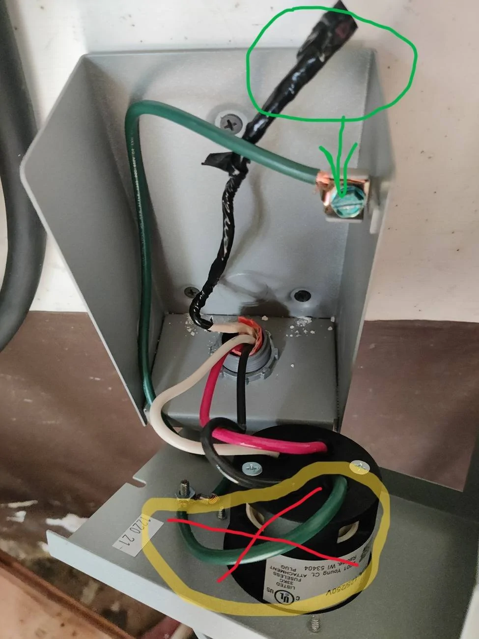

I did mine as shown in the marked up picture. I simply removed the ground wire jumper (circled in yellow) from the socket. I still left the other jumper that connects the front plate to the box. I then connected the home ground to the box ground (marked in green with arrow).
This allows the box to still be properly grounded to the house when there is no connection to a generator.
I placed the sticker on the outside saying that this has to be used with a bonded neutral generator.
The code says bonded generators (e.g., the Lightning) have to have a continuous equipment ground with the rest of the system so the above is not code.
The reason is when things go wrong (loose of disconnected wires, ground faults, etc.) the chassis of the bonded generator can have a potential voltage on it as much as 120V (in a 240V system) that will not trip the GFCI until someone touches the chassis and gets a shock. Also why bonded generators have to be earth grounded according to code.
Watch the video I posted above for further info.

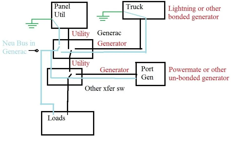

Sorta on the topic of ProPower house hook-ups, I have a gas powered standby generator un-bonded and a transfer switch I have been using for the last decade during outages.
I want to use the Lightning so I bought a Generac 6853 transfer switch suitable for bonded generators, like the Lightning.
The thing is I did not want to completely unwire the other transfer switch, so this is a block diagram of what I came up with so I could have both transfer switches, no back-feeds, etc.
Essentially, the Generac feeds the old transfer switch from either the utility or the truck depending on the switch position, and the other transfer switch feeds the loads either the utility or truck out from the GEnerac switch OR form my old un-bonded generator depending on the switch position.
Easy peasy, lol.
By the way, in case you're wondering, the Generac by design will not switch to GEN position unless there is a generator connected supplying power.
Now, if some fool had both switches connected to generators at the same time AND the switches were both in the GEN position, the load would only be powered by the second generator, and because the neutrals would be connected together, the GFCI in the bonded generator should trip.
EDIT: also, with only on generator input box, impossible to hook two up at once anyway.

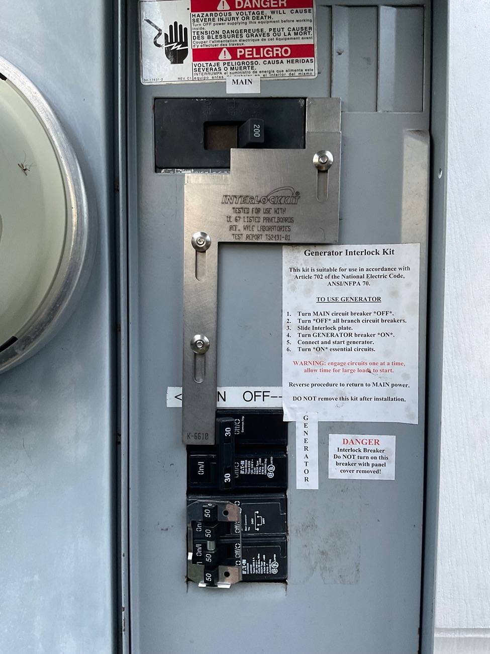

I made a custom cable with 10-3 SOOW wire with only 2 hots and neutral connected to the cable plug ends. I store it in the truck bed Swing Out Storage case. https://www.ford.com/product/pivot-...91222733?gmcid=marketplace-gs-cta-accessories I used my Ford Pass Points to buy the case. I only use the custom cable for the Lightning to feed the generator inlet.
I have another standard 30 amp generator cable to use with my gas generator if needed.
I have an interlock bypass kit on the main breaker.

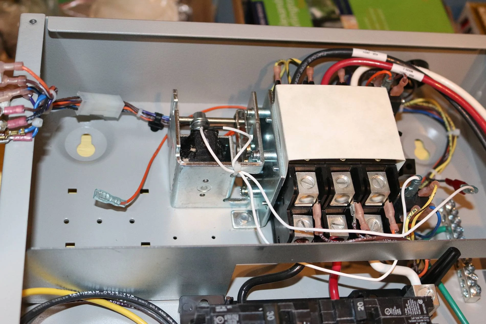

I finally got around to installing my GENERAC 6853 neutral switching transfer switch for the Lightning (or any other bonded source).
I had a transfer switch for an unbonded generator that I had been using for many years with a portable gasoline standby generator, and I did not want to have to un-wire it. So this is what I did in block diagram form:
Ford F-150 Lightning Franklin battery system, V2L, via bed 240, same old ground fault issue, it would seem. Need help... Block diag of 2 xfer sw hook up w inlet boxes
The two transfer switches are wired together as shown.
The outside inlet box is wired to a plug that can be connected to either the Generac or the old transfer switch inside the house.
The Generac can provide power to the loads through the old switch which is connected to the breakers in the Generac to receive power from either the Lightning or the Utility.
When from the Lightning, the Generac will switch (be manually switched) the neutrals and hots so that there is no ground loop and a tripping of the GFCI.
The old manual switch switch can still be used with the unbonded portable standby generator by plugging it in through the inlet box outside the house and inside the house to the old switch, by passing the Generac switch.
It was simpler than removing all the old switch connections to the loads in the service panel and taking the old switch off the basement wall then mounting and wiring the Generac switch.
I only had to move the old switch single neutral wire to the Generac neutral bus and the utility input power lines from the panel breakers to the Generac breakers, then connect the load circuit neutrals to the Generac neutral bus, then install a breaker to power the Generac in the panel. Then provide an inlet box for the Generac on the wall where the wire from the outside inlet box could be plugged.
It also meant a less crowded service panel wiring the way I did it.
This is the wiring with the service panel and Generac front covers off:
Ford F-150 Lightning Franklin battery system, V2L, via bed 240, same old ground fault issue, it would seem. Need help... IMG_5926-final wiring before gen tests
The big black wire plugged into the old switch can be plugged into the new inlet connected to the Generac transfer switch.
To connect all the load neutrals I used Wago wire connectors that snap on stripped wires, then wrapped them in white electrical tape so the can't unsnap accidentally. They are located at the top of the service panel.
The load black wires were connected to the old transfer switch black wires with wire nuts visible in the middle of the service panel.
The wire nuts at the top (red/yellow) were used by the electrician who upgraded out old 100A panel to this 200A panel back in 2011 to connect load wiring to the panel. So some of the branch circuits that did not get transferred to the Generac (only room for 10 in the Generac) still use those wire nuts.
We have a Spa sub-panel as well wiring that goes underground to a shed fed off the service panel. When the electrician did the upgrade to the new panel I think he could have done a better job relocating that wiring and conduit in the new panel. Right now there is quite a bit of excess length of 100A wire crowded into the bottom of the service panel as a result.
The last step I have to do is to plug it up to the ProPower on-board and test the Generac transfer switch in the STANDBY/GEN position with the Lightning. Before I do that I want to install a ground rod near where the Lightning will be parked when used for back up and connecting it to the Lightning chasis (per code, NEC 250.30(A) 4 and 5, bonded neutral generators need to be grounded nearby the generator).

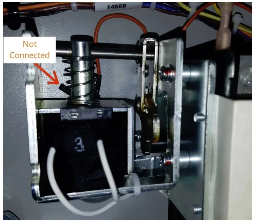

BTW, the GENERAC switch has on orange wire inside that was unconnected to anything when I got it. The GENERAC web site said that it is a wire unused in this configuration - gee they could have put that in the manual, eh?!
chl
CHRIS
Dec 16, 2022
2,255
1,388
alexandria virginia
One of the FAQs was about this unattached wire in the GENERAC the answer said it was OK.
