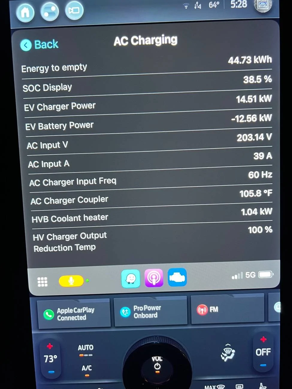

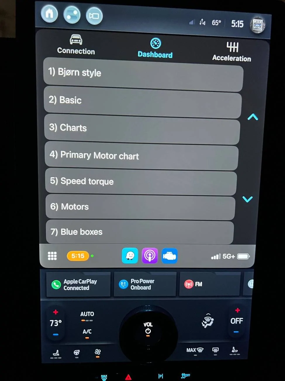

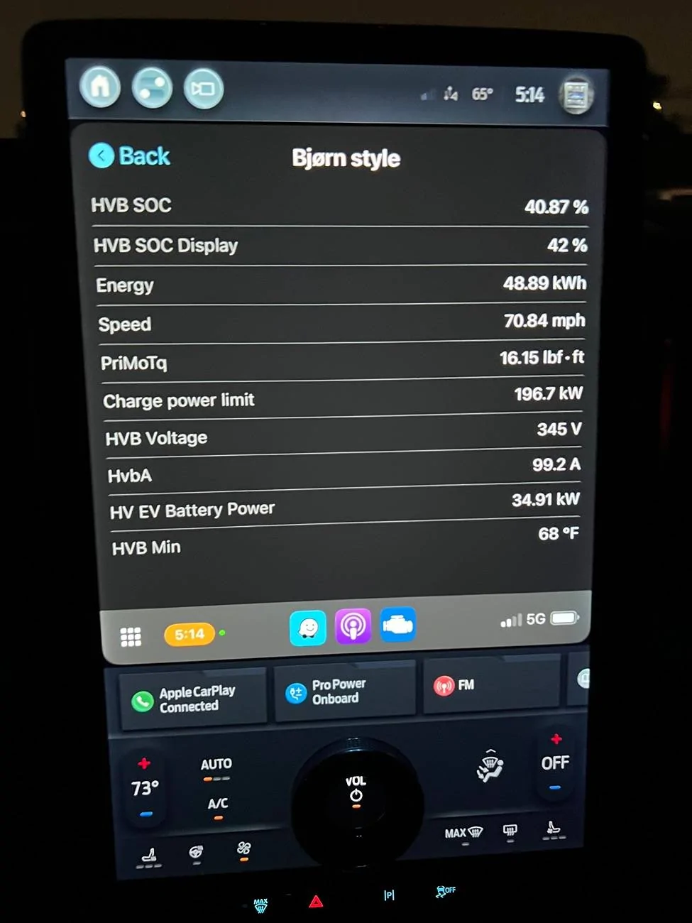

I’ve been using car scanner with CarPlay, would be nice if we could make our own custom screens with values we’d lIke to track.
Ford F-150 Lightning Car scanner app works pretty good with CarPlay IMG_5160
Ford F-150 Lightning Car scanner app works pretty good with CarPlay IMG_5161
Ford F-150 Lightning Car scanner app works pretty good with CarPlay IMG_5164

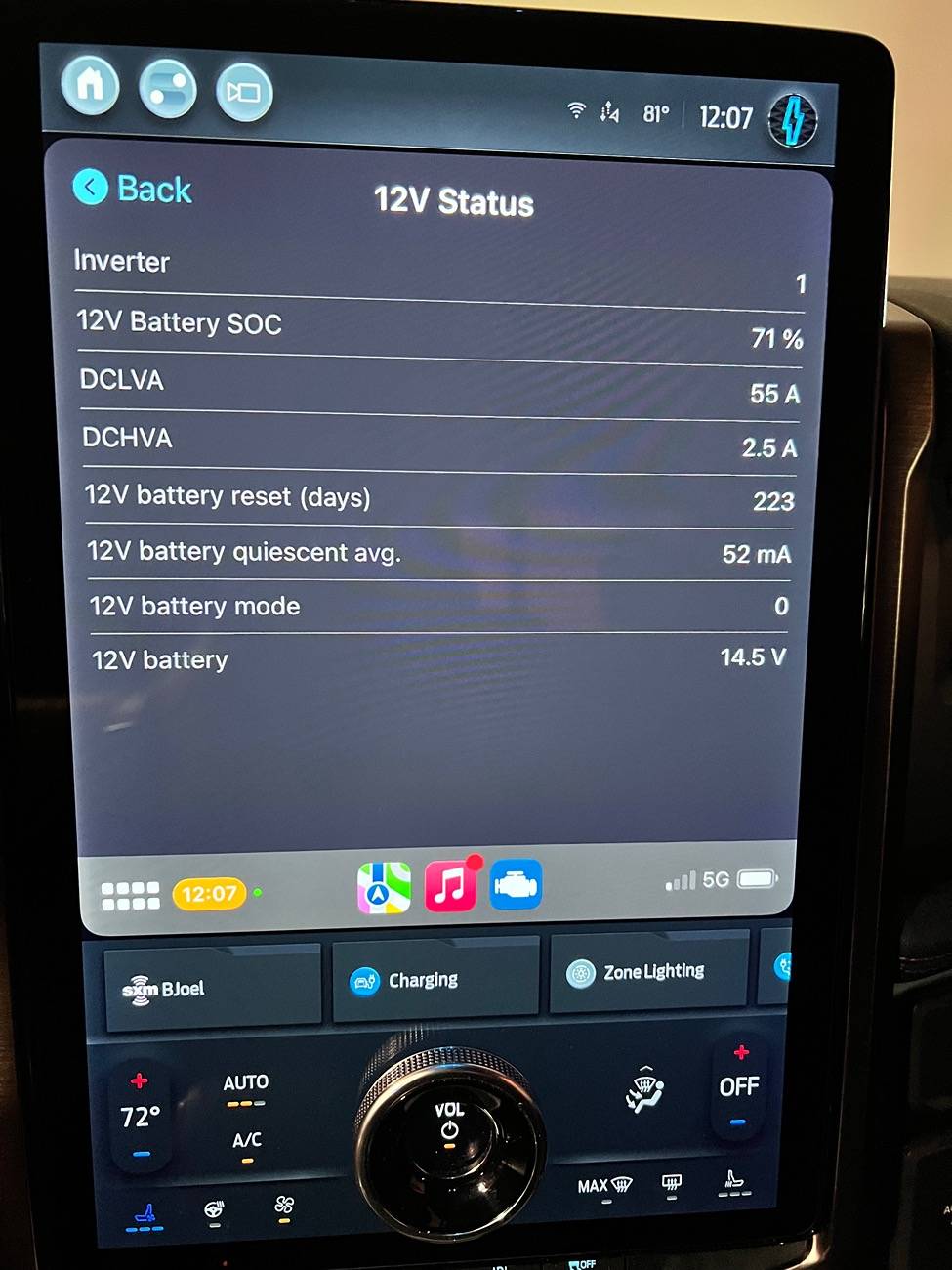

You can. Create new pages on your phone and they will show up in the menu. It only supports text, no graphs or gauges. Here’s the one I created a while back to monitor the 12V.
Ford F-150 Lightning Car scanner app works pretty good with CarPlay IMG_0977
