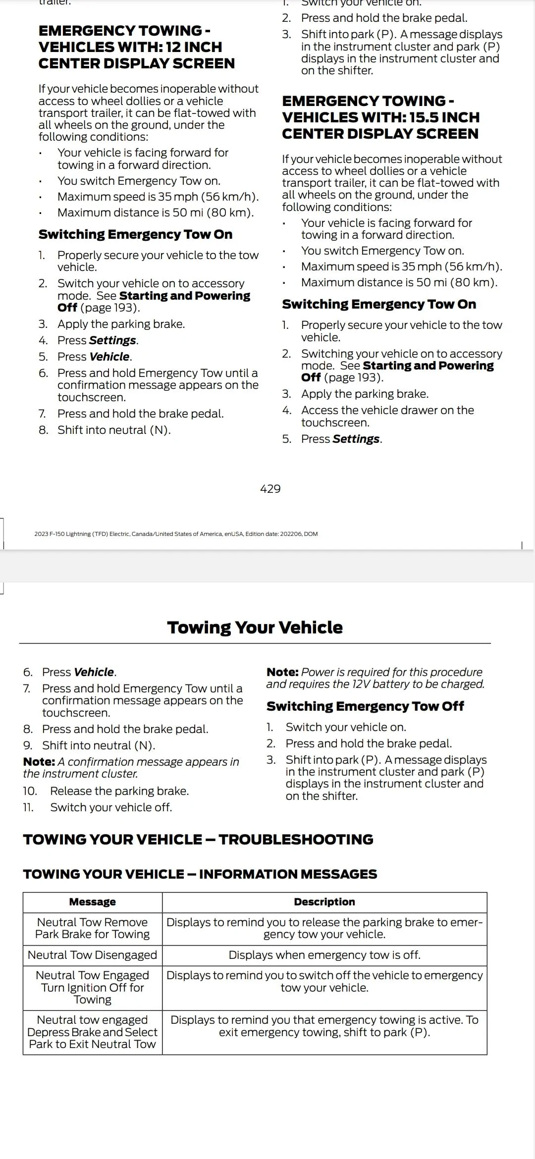

Heliian
Mar 9, 2023
1,812
2,078
Name one benefit
The hvb contactors are open, no drive possible if you're working on it or showing it off.
When you're charging, it is essentially in accessory mode, no drive but heat available.
You can power the truck if the hvb fails. There's enough power in the 12v to get it into tow mode.
Rolling up or down windows without putting it in drive mode.
It's essentially the same as a gas version except for the wasting gas part.
Could they have designed an automatic one press on, one press off? Sure, but it's not about being radically different, it's an f150.
Personally I don't mind the acc. mode. Going completely the opposite direction, one manufacturer has or has proposed that just getting in with the fob should power it all up, no button to start.

Heliian
Mar 9, 2023
1,812
2,078
That has nothing at all to do with this discussion. You can't shift out of park in either accessory mode so you can't tow in these modes. You need to turn the truck on, see the HVB error, and get it to shift out of park. I don't know how to do that but I guarantee It has nothing to do with accessory mode.
The owners manual is a great tool that no owner should be without.
