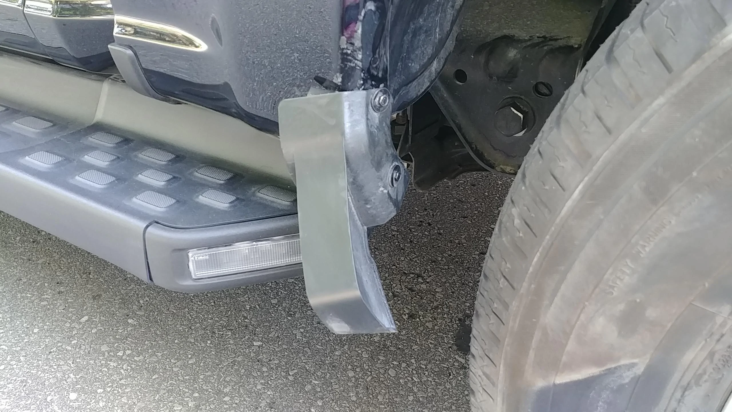

This all happened to my wife last night, and now in the light of day, I can see TEMPORARY on the tire.
Naturally, the dealership never made this clear, only saying it was a "real" tire and not a donut implying it was just like the rest. They also don't tell you the jack is not able to lift the vehicle, at least not safely. :confused:
Then there's the lousy roadside assistance, partly due to jurisdictional issues in our area, but took five hours our of her evening to get the tire swapped by another service that we now have to submit a $170 invoice to Ford for reimbursement. I'm wondering how many hours of my time that will cost.
We also intend to get the dealership to replace the tire as it only has 6300 km on it, and there was no "road hazard". Then there is this piece that needs fixing...
