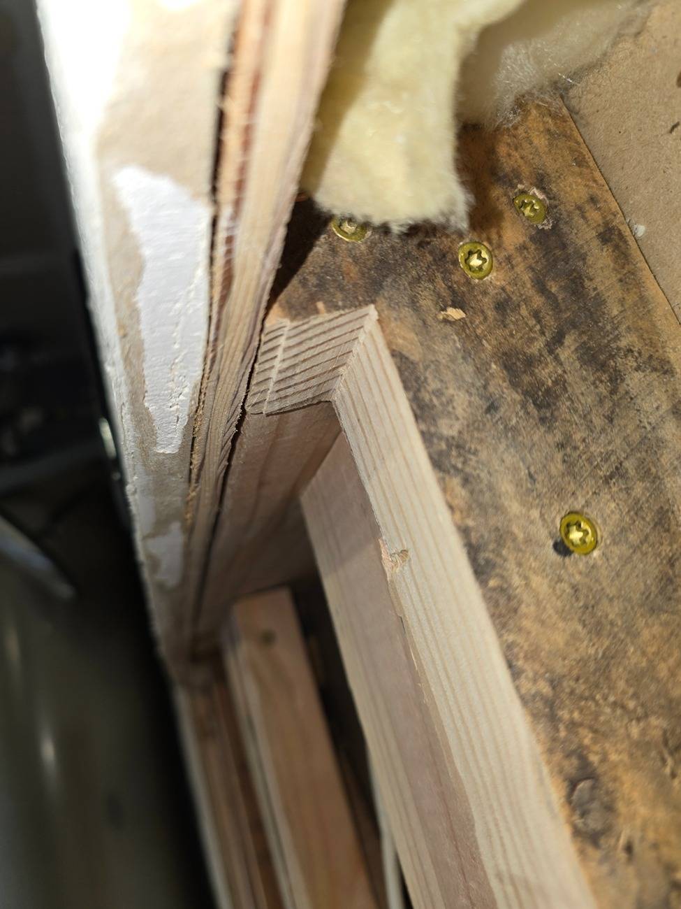

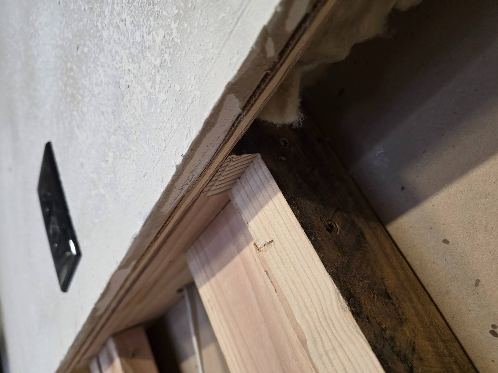

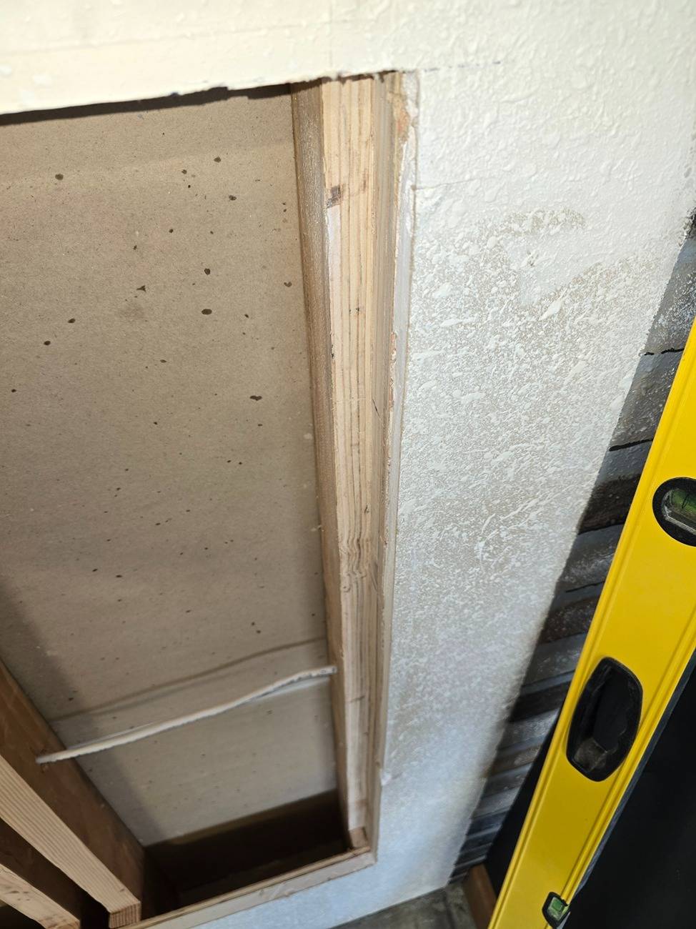

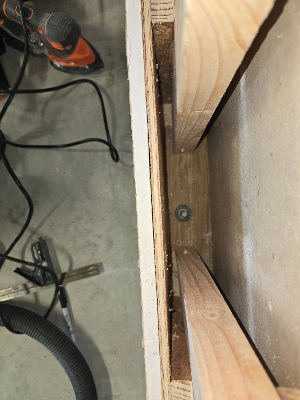

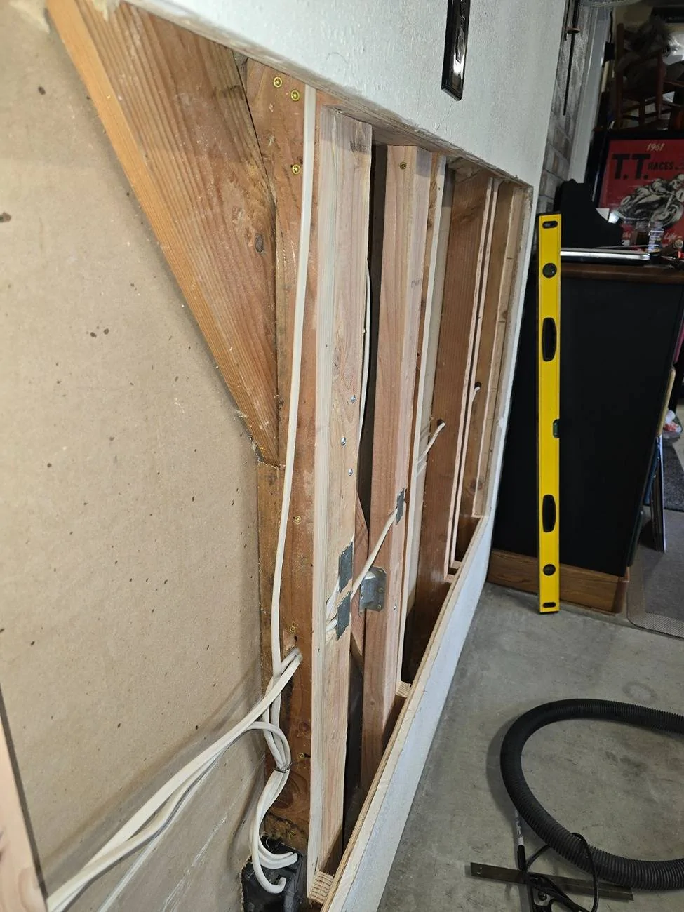

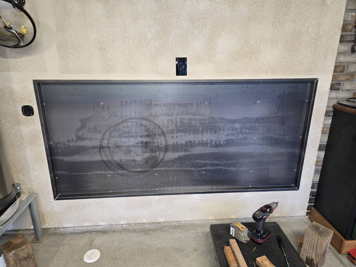

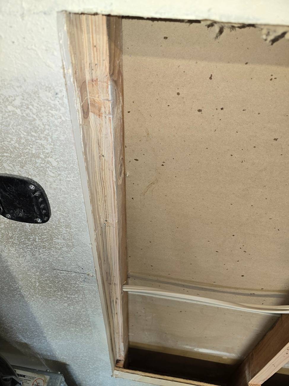

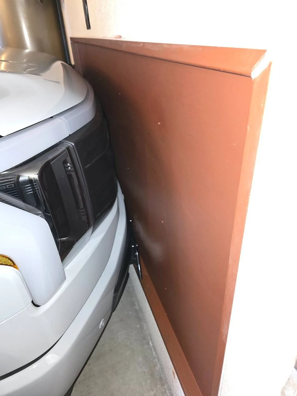

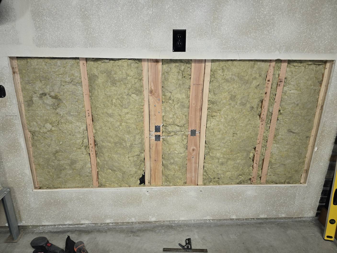

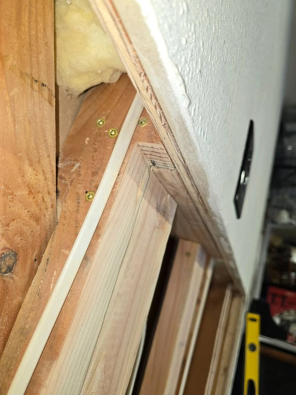

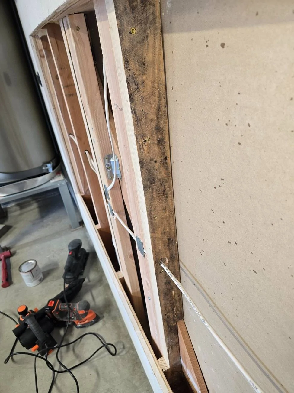

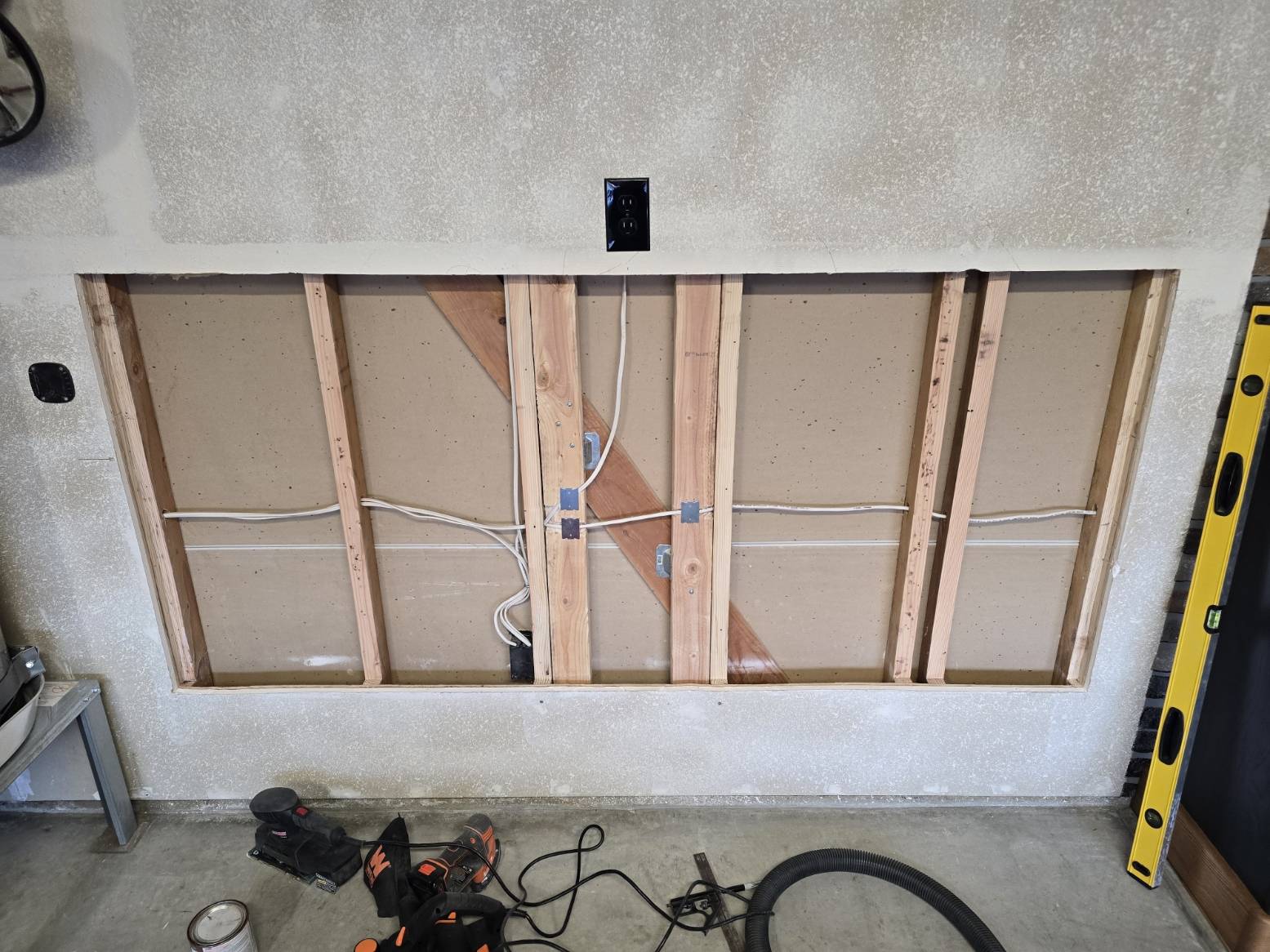

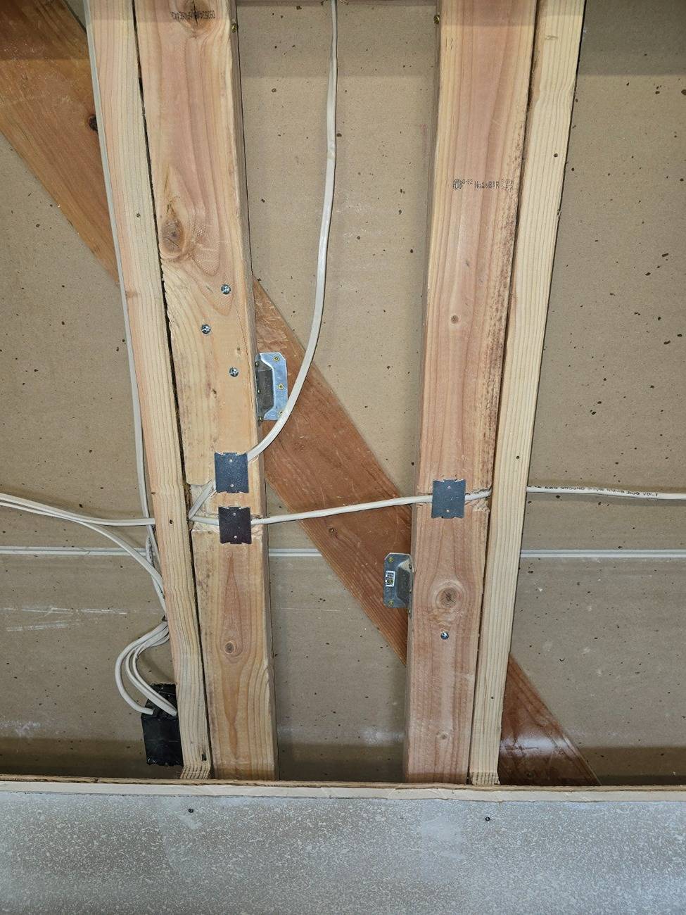

We started selling some things off and tossing quite a bit in our garage recently as I was going to buy a 2025 Maverick. But we decided the Maverick was just too small and utilitarian, so we purchased a 2024 Lightning Lariat on 9/30. I'm in the process of notching the front wall inward 1.75", and replaced 2 garage door hinges with lower profile hinges that are meant for rollup doors on truck and trailers. I also installed the Swarfworks front license plate relocation bracket to reduce to streamline the front bumper center area. Still a work in progress and I have a metal fabricator building a box and flange to seal off the garage wall modifications. But it fits-Barely.
Here's the finished project except for texture and paint.
