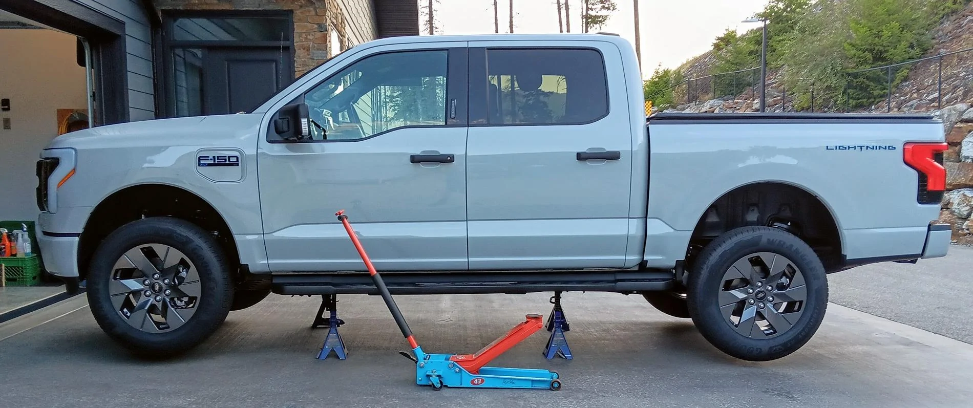

24" jack & 3.5 ton stands
@Jake24, The problem I encountered (particularly on the rear) was that once I got the floor jack under the "jacking position" arrow on the frame, there was no room for the jack stand (Hein-Werner 6 ton) to slide in so I could lower the frame onto it. The frame has a bit of a curve there so there was no safe position to rest it on the jack stand. How did you get around that in your 4 minute lift solution?
Thanx!
