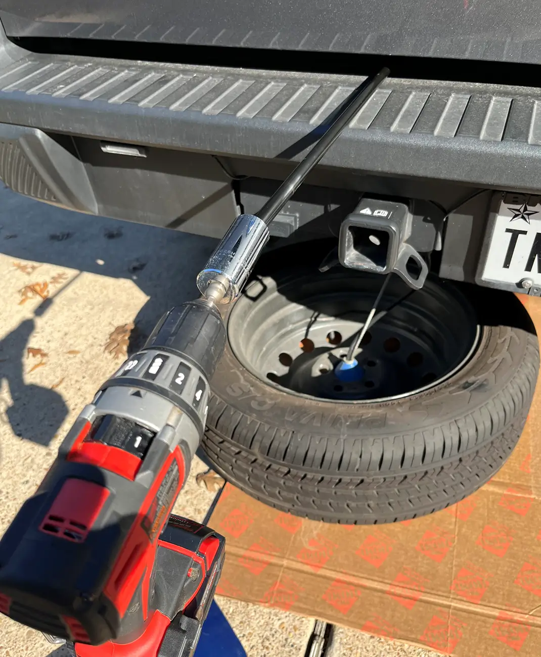

For $20 you can get a corded impact from Harbor freight.
Add a VERY long extension, and an adapter to run the factory jack, and that $20 would VERY handy
The inexpensive driver sounds like a good idea to go along with the long extensions and socket.

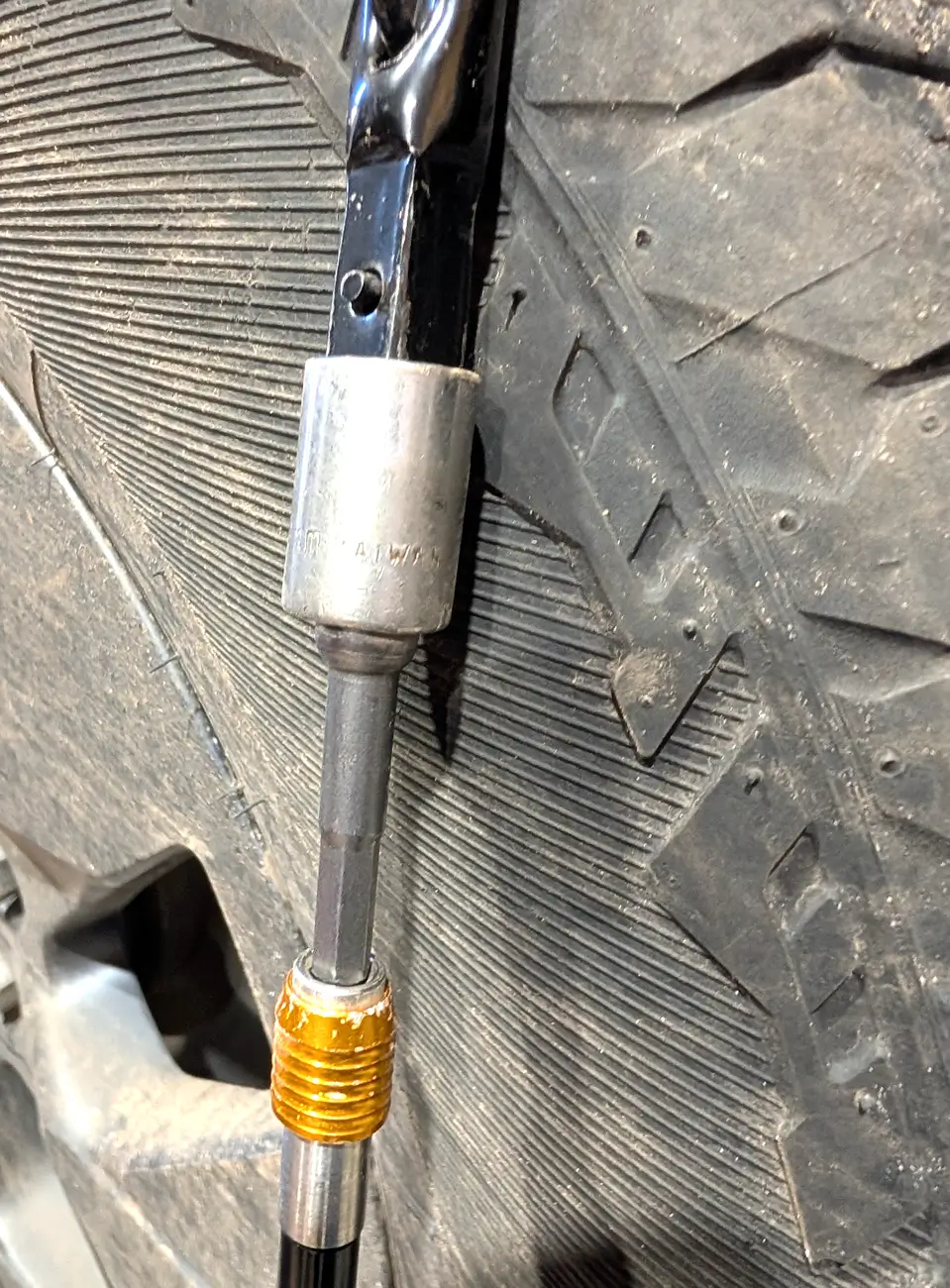

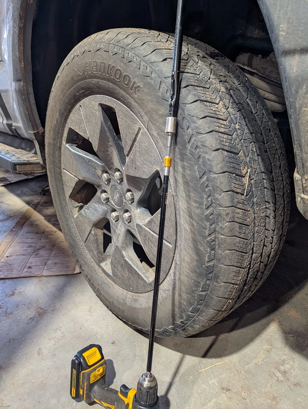

May be useful for some…I wanted an easy, no thought tool for lower my aftermarket full size spare.
I got this on Amazon: https://a.co/d/0cPOpoF9
Fits in the plastic tube and engages the lowering mechanism easily. A 22mm or 7/8 ratchet both fit on the end to turn it.

Same Steelman 96095 works for my Maverick.
