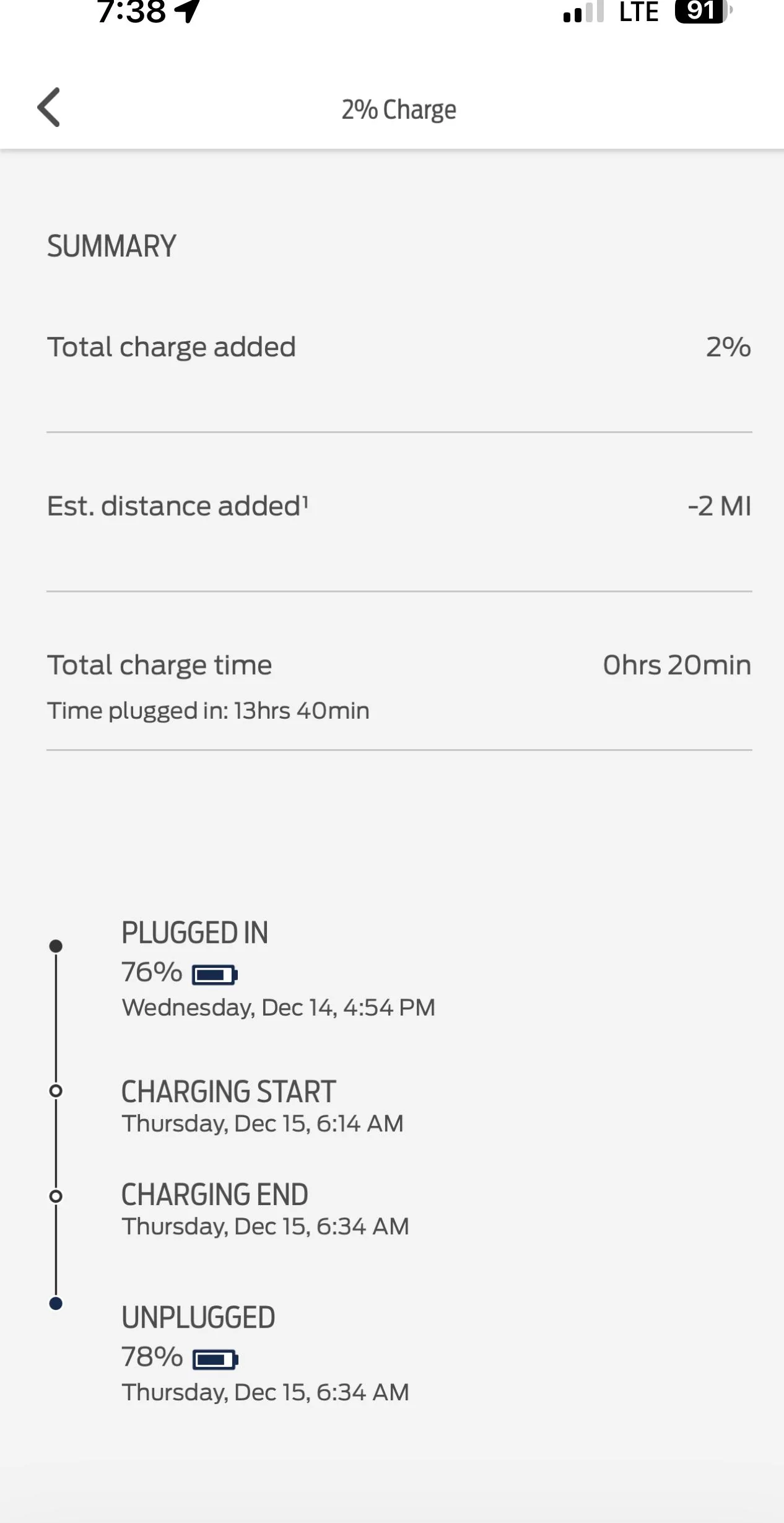

I woke up this morning to see my truck hadn’t charged the night before after 4.1.1 update .
-My lightning is set to charge to 90% starting at 11:00 pm each night ( when the rate is lower from electricity provider )
- I have departure/ comfort settings set for each morning . Today the setting is departure time of 6:30am and warm .

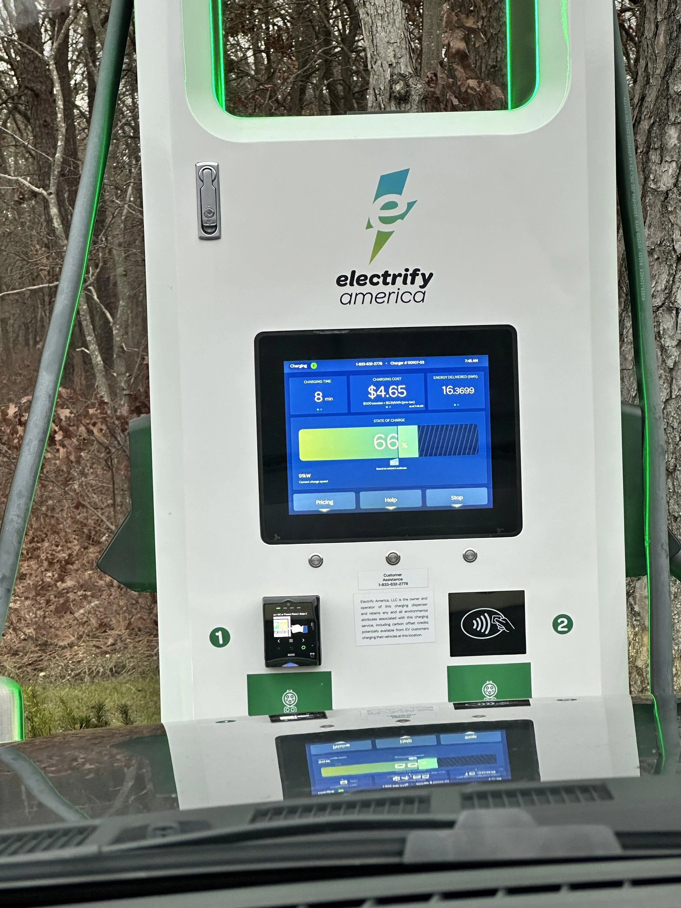

I walked outside to my truck and it was preconditioning but it did not charge over night . Was hooked up correctly, please refer to screen shots . Last photo is what I have to do right now to make it through the work day.

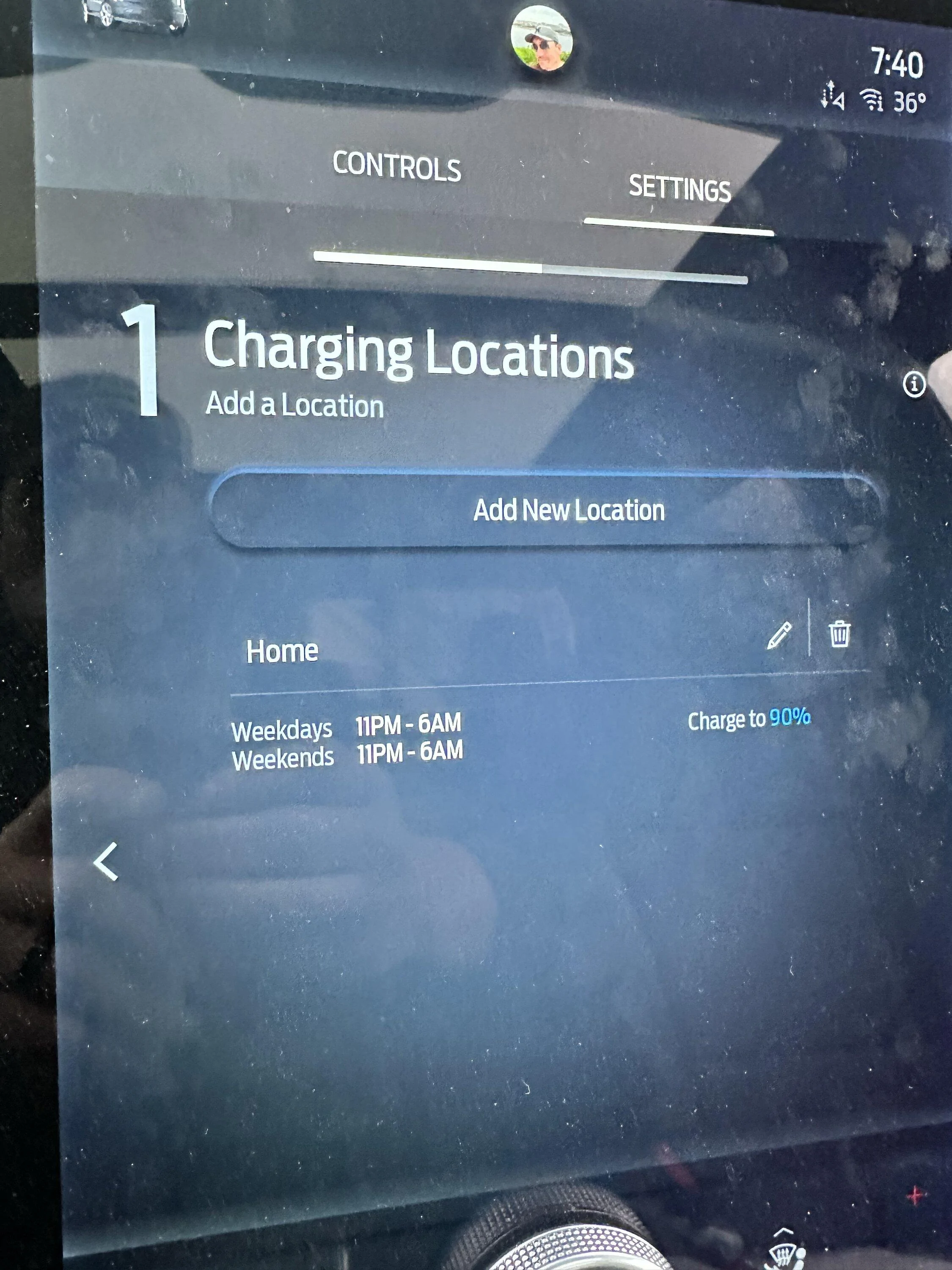

After some updates, the vehicle loses the Home location, and either charges to 100% or doesn't charge. Check that the location is saved and has hours and percentages saved. Or, delete it, charge for a few minutes, unplug, resave and try again.

Second screenshot shows that settings remained about home location and charging times . Will delete and re add .
