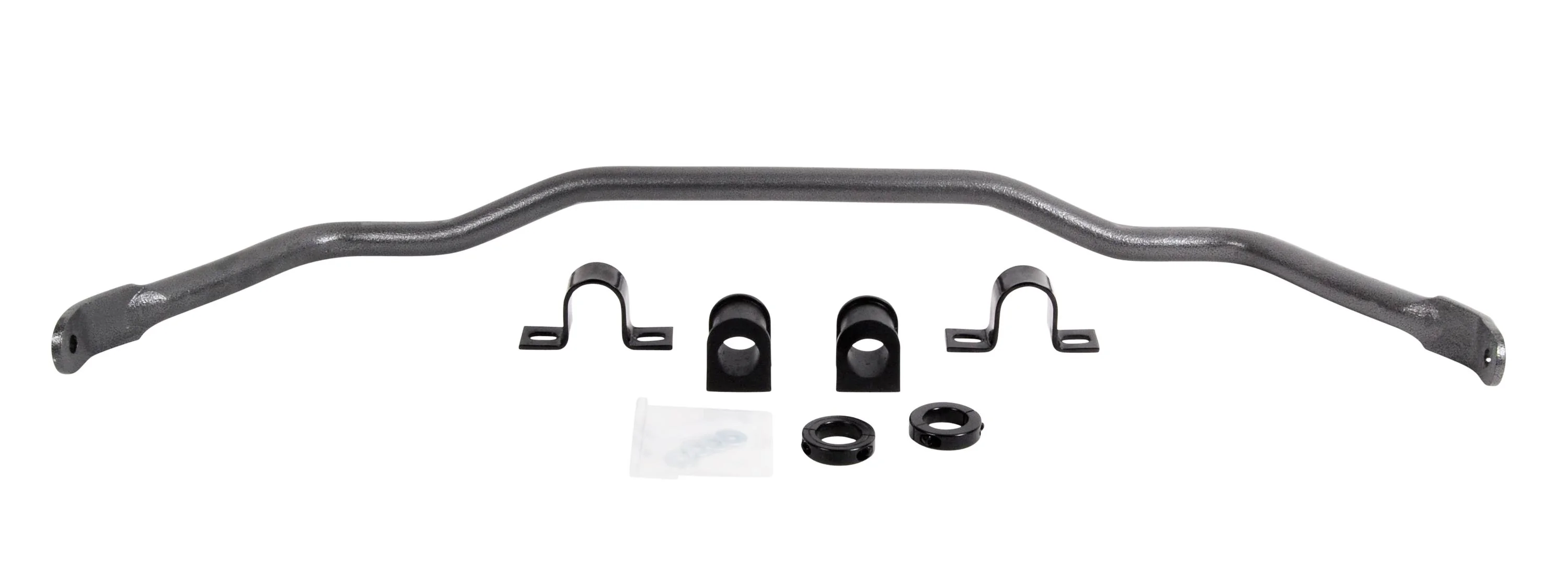

Has anyone installed a Hellwig Sway Bar?

The Hellwig is a solid chromoly bar, but I'm not positive of the specs of the stock sway bar nor the specific diameters. I've got an email out to Hellwig to provide some insight. I'll post what I hear back.

I had one installed today. It is both larger in diameter and solid. Body roll was almost completely eliminated and the torque steer under hard acceleration is completely gone. I did have the Eibach lowering springs and sport shocks installed at the same time so part of the difference could be attributed to the lowering kit.

THIS...I need this set up. ima gran turismo kinda guy.

How much with install did all this cost? And what kind of shop does these kind of installs. I can replace the sway bar. Did it on my 2017 Tundra. but i cant do the shocls and springs. no eqipment

The parts cost around $1850 and I paid $1200 for installation and an alignment. I had them install the sway bar since they were under it anyway. The most time consuming part of the install is the camber kit. It takes around 5-6 hours alone. I took it to the local off road store, they mostly do lift kits.

I love your upgrades! Do you know if the stock sway bar is hollow?
