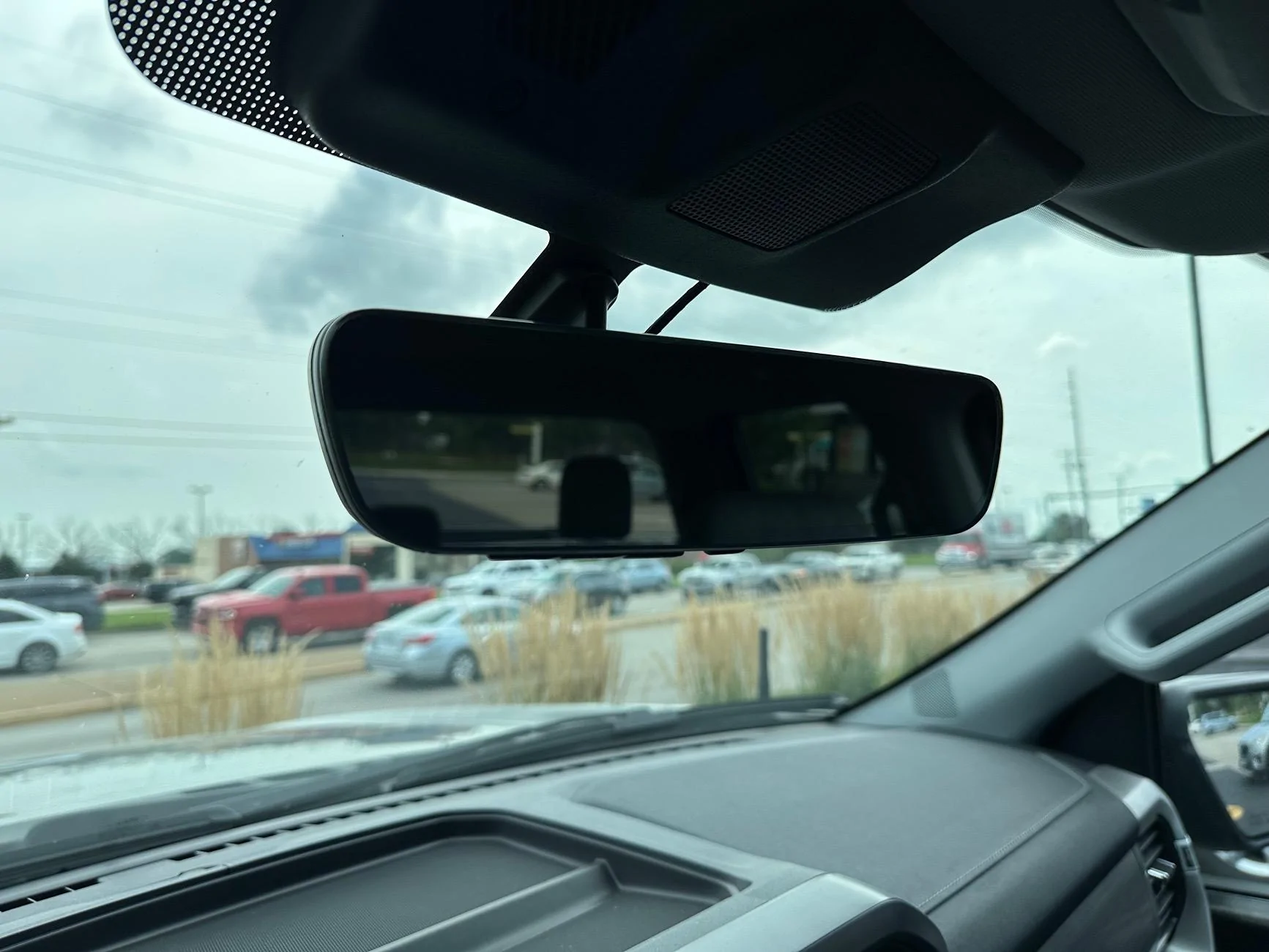

Can you post pics of it installed and you’re saying it will basically work right?
Maineiac12
Feb 14, 2024
37
561
698
Iowa
mine is the one without compass, but otherwise it’s the same mirror. Installed yesterday and programmed my garage door. Works great!

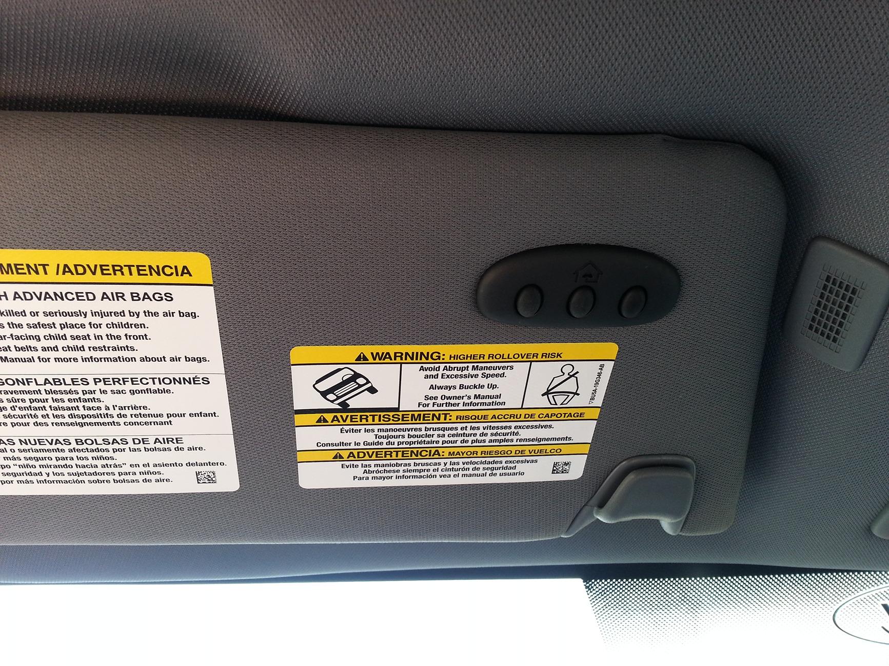

Here's one of my installs:

where did you get this!
Buttons on Ebay. $20 - $30.
Longtime Ford owners know that most Fords with lighted mirrors on visors can be retrofitted like this. The visors often have an area that is already perforated for the insert. You unstich the material, peel it back, cut out area, wire buttons to light wires, and then stuff material back into visor with a plastic edge.
I have not verified that our visors are like this, but it shouldn't be hard to verify. Or look on an gas F-150 forum.
