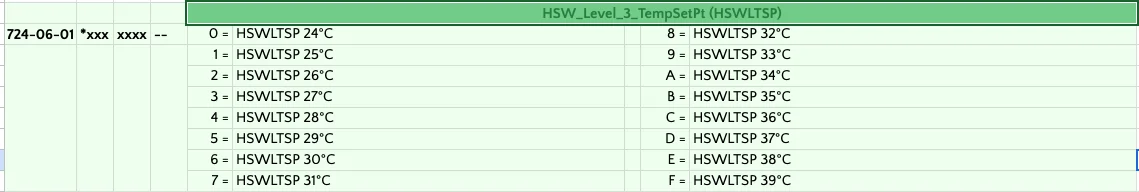

I know my dealer only retrofit heated steering wheels only in summer
But after it was installed last week, I found it's not warm enough
Is there something to adjust via forscan? Or am I having a bad steering wheel?

somethings not right. Mine gets very warm very fast.

There are noticable stages of heat though. It's toasty when turning it on, but it fades to a lower heat setting after a period of time. Not sure what the time length is, maybe 10-15 min?

Yes you can adjust it in Forscan. I jacked mine up to the max. I can’t remember where, but once you load it up you should be able to look around the modules and find the steering wheel temp adjustment setting. I believe you can also control the length of the heat but I did it 2 winters ago so my memory is a bit hazy on that!

found how to change it via forscan
it was set to 30C, now I change to 39C and its warm enough for me
