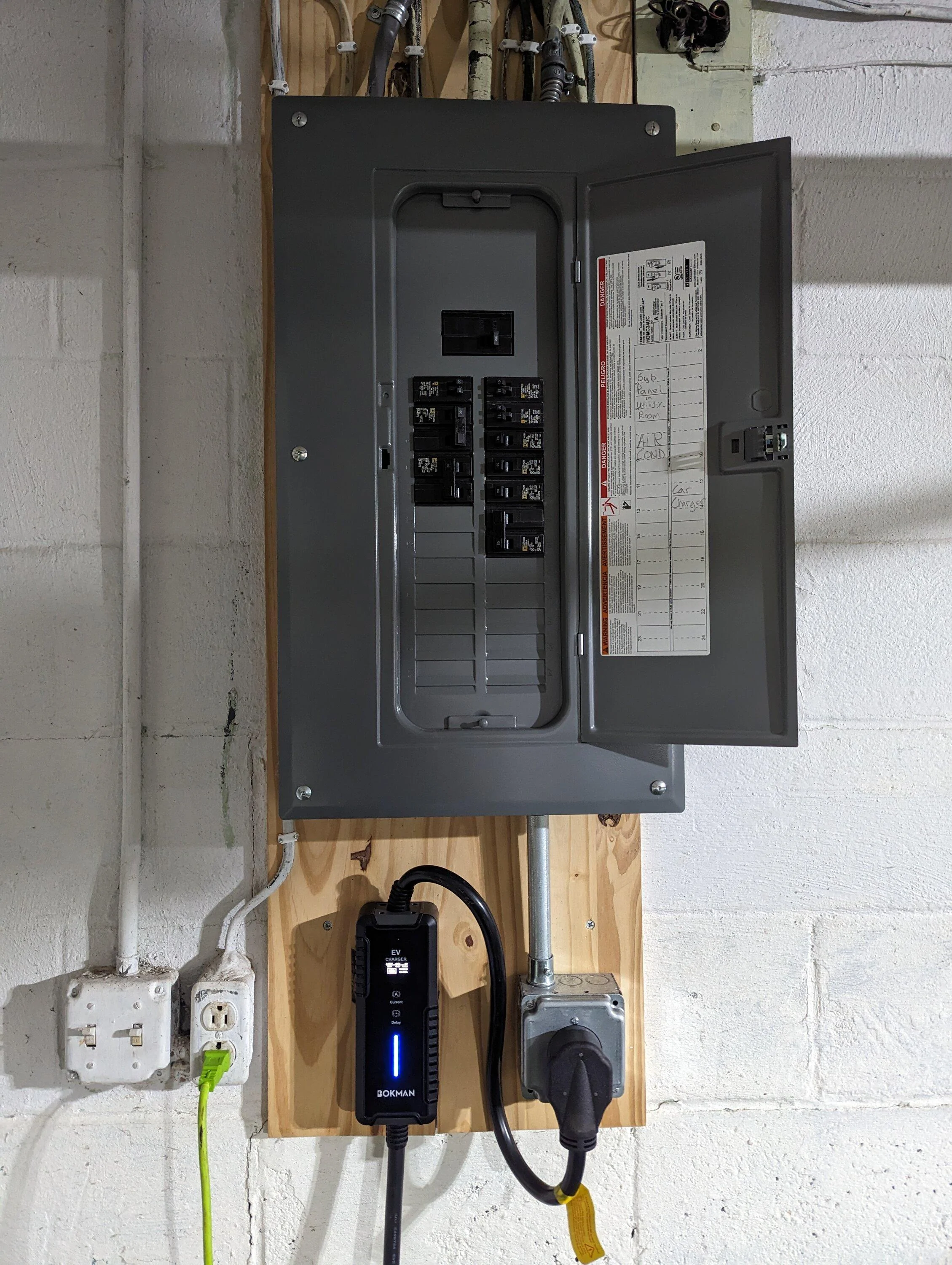

My NEMA 14-50 install with 50A breaker has worked fantastic for me. It's just inside the garage, and I can run the cord out the door or park inside.

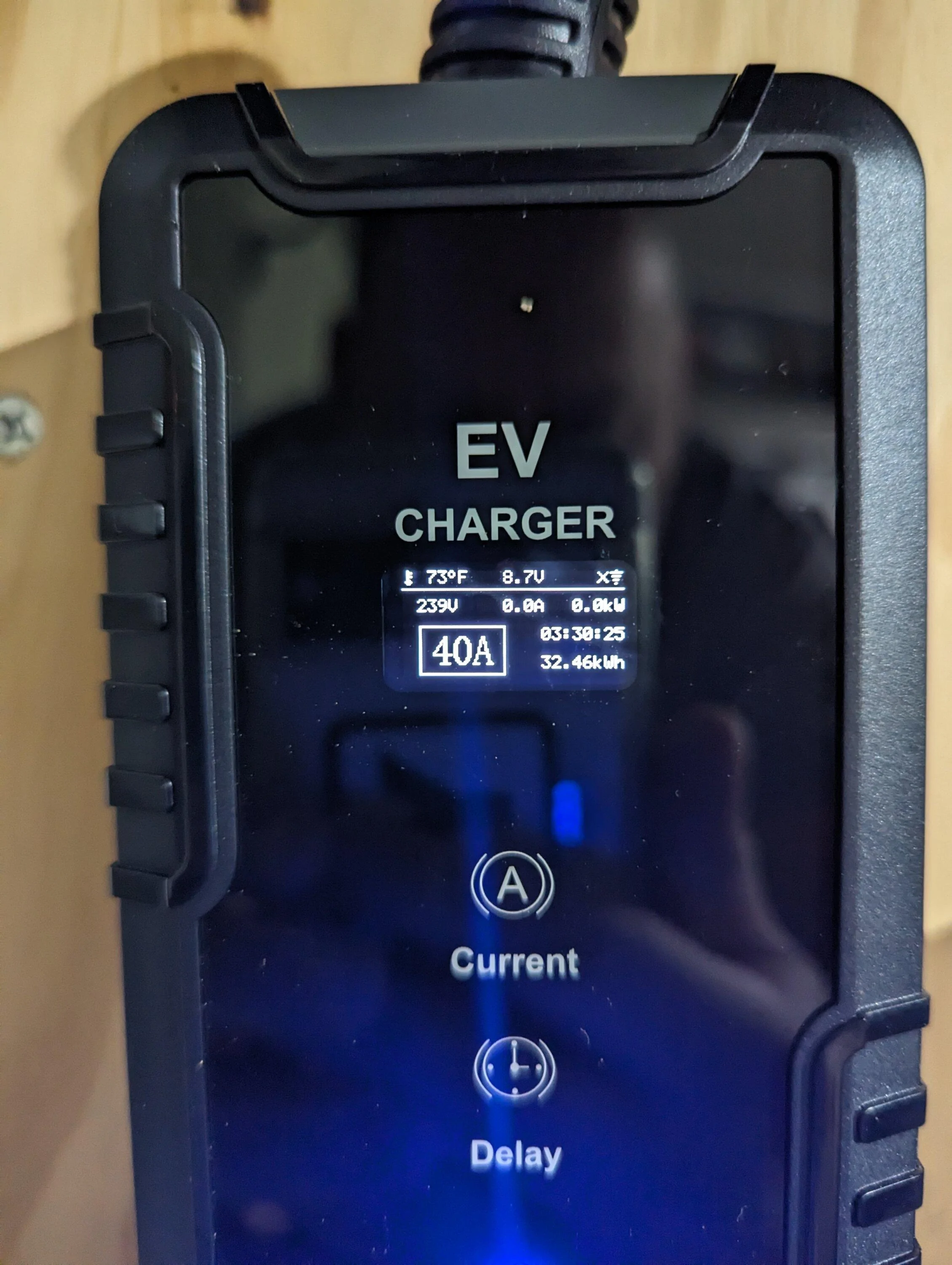

I went with a 40A adjustable amperage EV charger from "Bokman". It's a chop suey amazon deal, $300, https://www.amazon.com/dp/B0CD1RM1NH?ref=ppx_yo2ov_dt_b_product_details&th=1

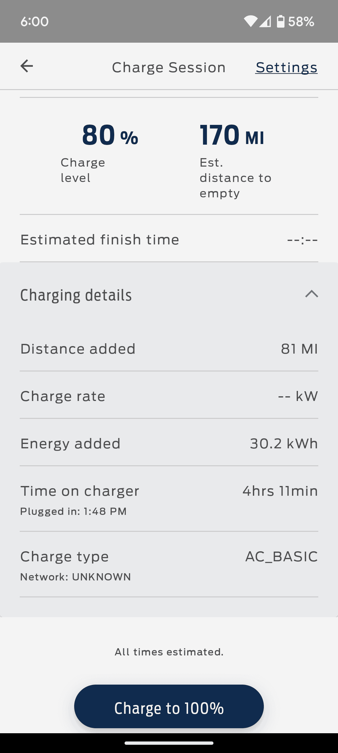

It will take 220V or 120V and comes with the 120V dongle. It's $79 less than the Ford, can be adjusted to run on lower amp output 220V or 120V circuits, it displays detailed charging data, and it runs up to 40A. I just looked at the current loss, it's just under 7% comparing the charger display with FP. I'm not sure if that is normal. My setup charges at 8kw, full 100% recharge on my SR in 12 hours. Just some ideas on what worked for me.
