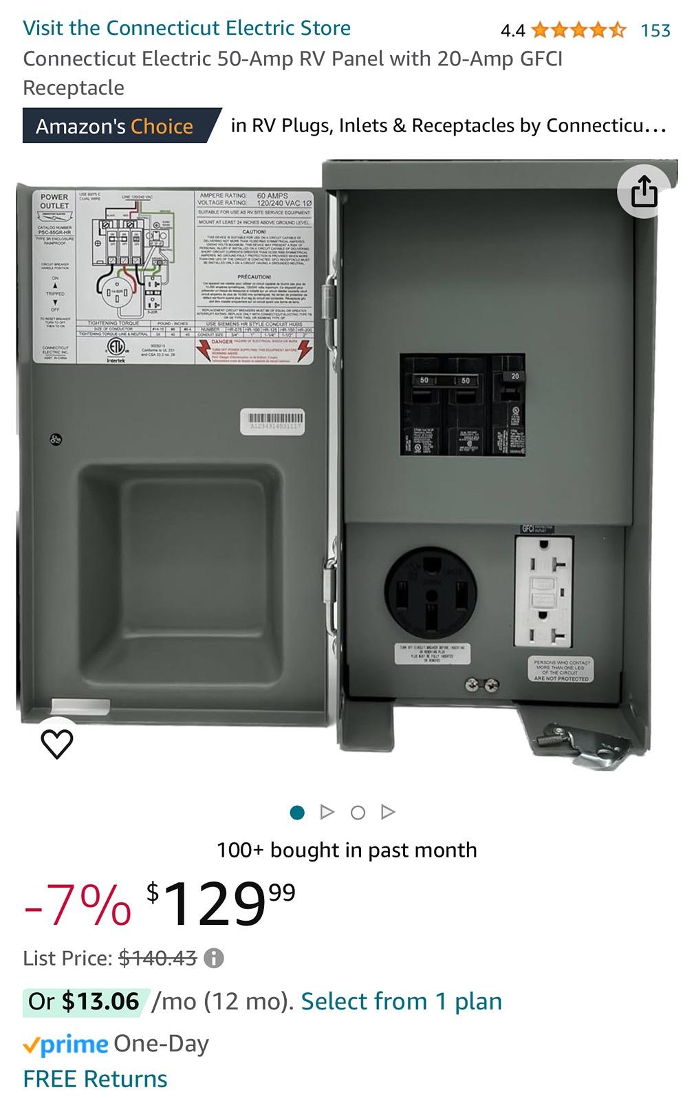

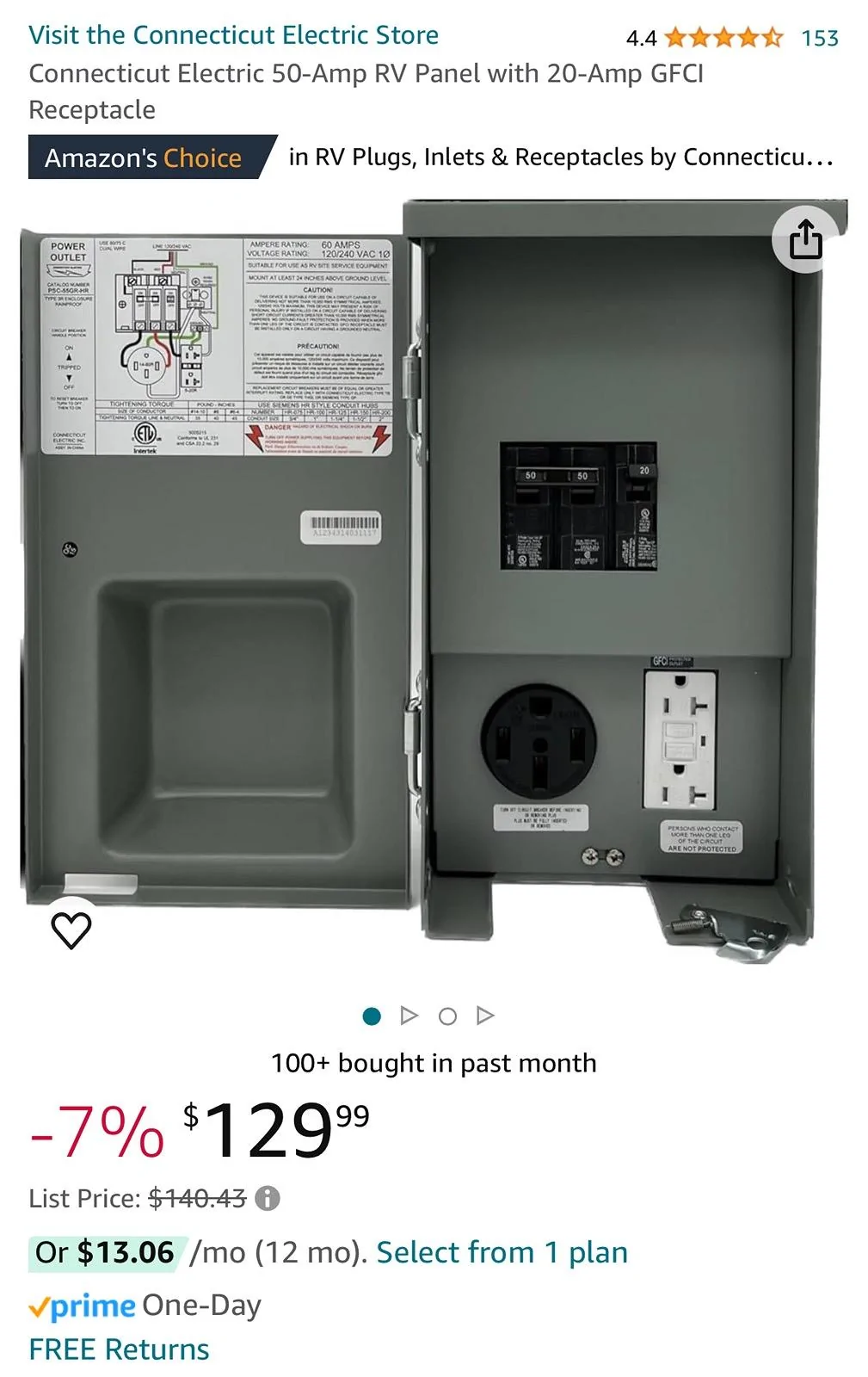

I’m semi confused. Are you all talking about something like this to mount in my case Inside garage? This one has box, 14-50 socket and 50amp breaker. One like this or just a breaker and box kit? The one I’m showing would allow 40amp charging and cord plugged into it with door closed.

No. That’s an RV panel, not a spa panel. The 14-50 in an RV panel isnt GFCI-protected (normally).
ETA - the 14-50Rs in those RV panels are the $10 junk ones.

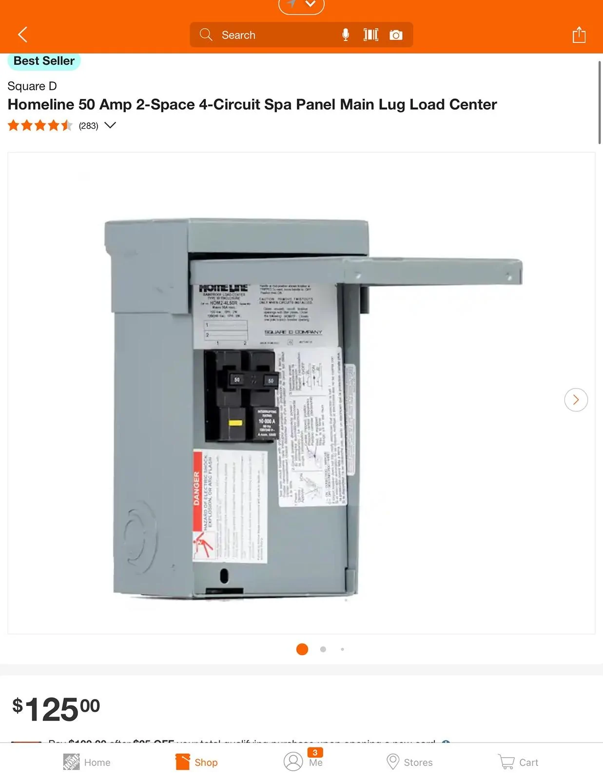

This is a spa panel:

Oops ok thanks. I know of some people use these at rv parks or very similar ones. So this is maybe like using a dryer 14-50 socket that is not GFCI with an EV too. My 14-50 50amp dryer socket on a 50amp breaker at cabin occasionally was used prob isn’t GFCI either. Lots of ways to do it but only a few right ones it seems.

Cheapest option I can find right now is the Square D at $70.
