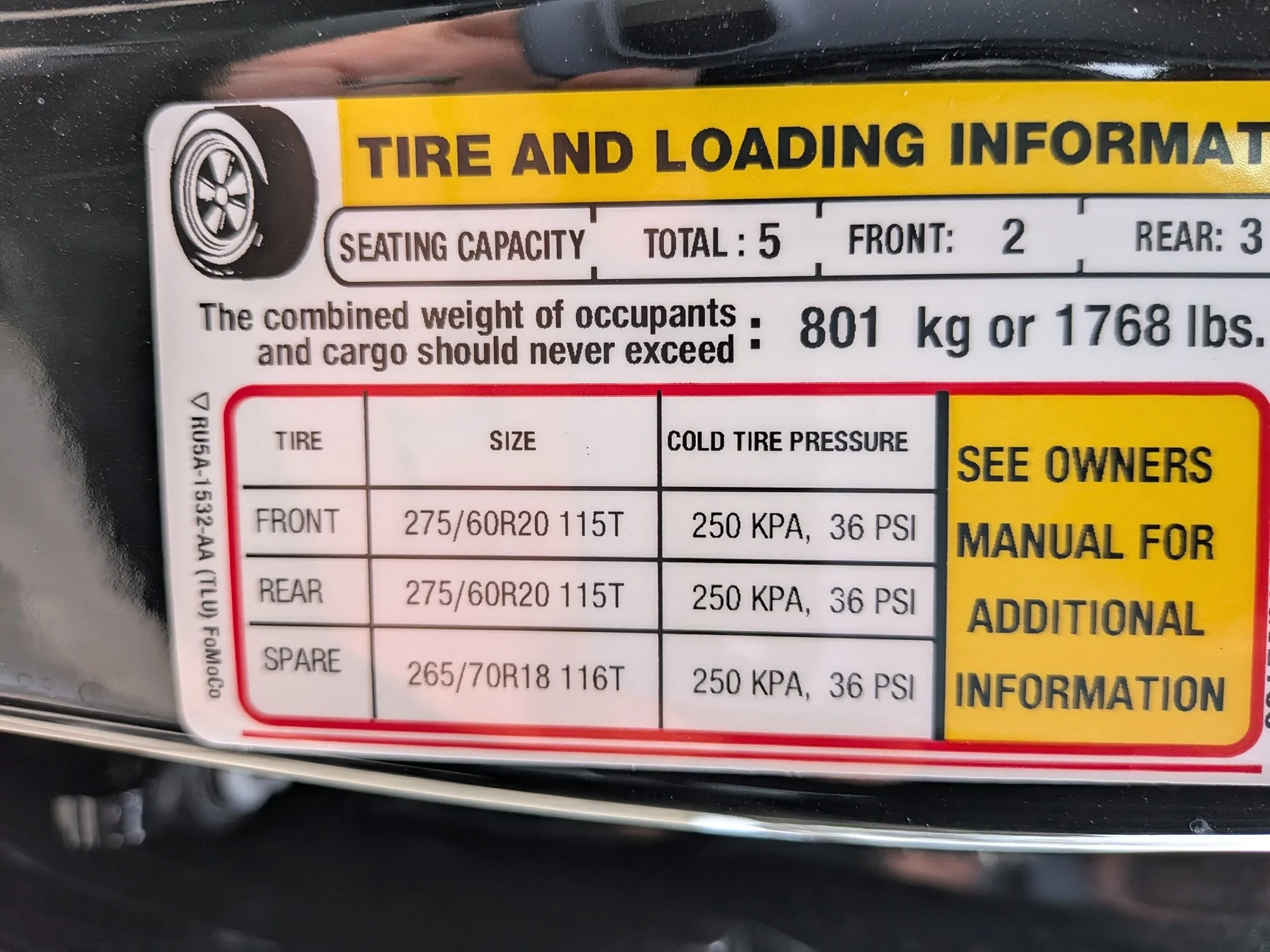

**Shopping for wheels/tires, this applies to all vehicles, not just our truck**
Look at your VIN sticker to identify your minimum weight support (below are actual examples from mine):
Total GVWR = 8400 LB
Front GAWR = 3940 LB
Rear GAWR = 4800 LB
When looking at Discount for example, you want to check the "Load Capacity" of a wheel.
Here's a spec from my actual wheel (yep, they are heavy):
So, from these specific 4 wheels, I support 10000 LB total (or 2500 @ each location, or 5000 at front & back). These amounts are higher than the GVWR & GAWR amounts from the VIN sticker, so this setup supports the minimum....good to go.
Next, look at the Tire and Loading Information stickers (yellow examples above). Take notice of the number to the right of the tire size), in this case, 116T. On your new tires, same thing, you want 115T (example from mine) at a minimum.
The numbers are the load rating, and the letter is the speed rating. You (should) need at minimum, the 115 or 116 (or higher). The speed should also be the same but can go lower or higher. For example, my OEM tires were T, for max speeds of 118 mph. My new ones are 117S, for max speed of 112 mph (and 117 load being higher than 115).
https://www.tiresplus.com/tires/tire-guide/basics/tire-load-index-chart/
https://www.tiresplus.com/tires/tire-guide/basics/understanding-tire-speed-rating/
These are the basics, but a few more important ones.
Wheels - besides bolt pattern and offset, the "Hub Bore Size" should be understood. The Lightning (and modern F150) are 87.1. Meaning, my wheel fits right onto the hub like an OEM wheel. If you buy a wheel that has a larger hub bore, you need to purchase hub reducing rings (typically, aluminum or plastic). This adapts that wheel to your hub to get rid of nvh (noise, vibration, and harshness) and a firm fit onto the hub. This works in conjunction with the appropriate bolt pattern and lugs/lugnuts to make that wheel setup as OEM as can be.
Tires - sidewall ratings, ply ratings, etc. These have to do with stiffness/support on the sides of the tires.
Hope this helps your journey.
