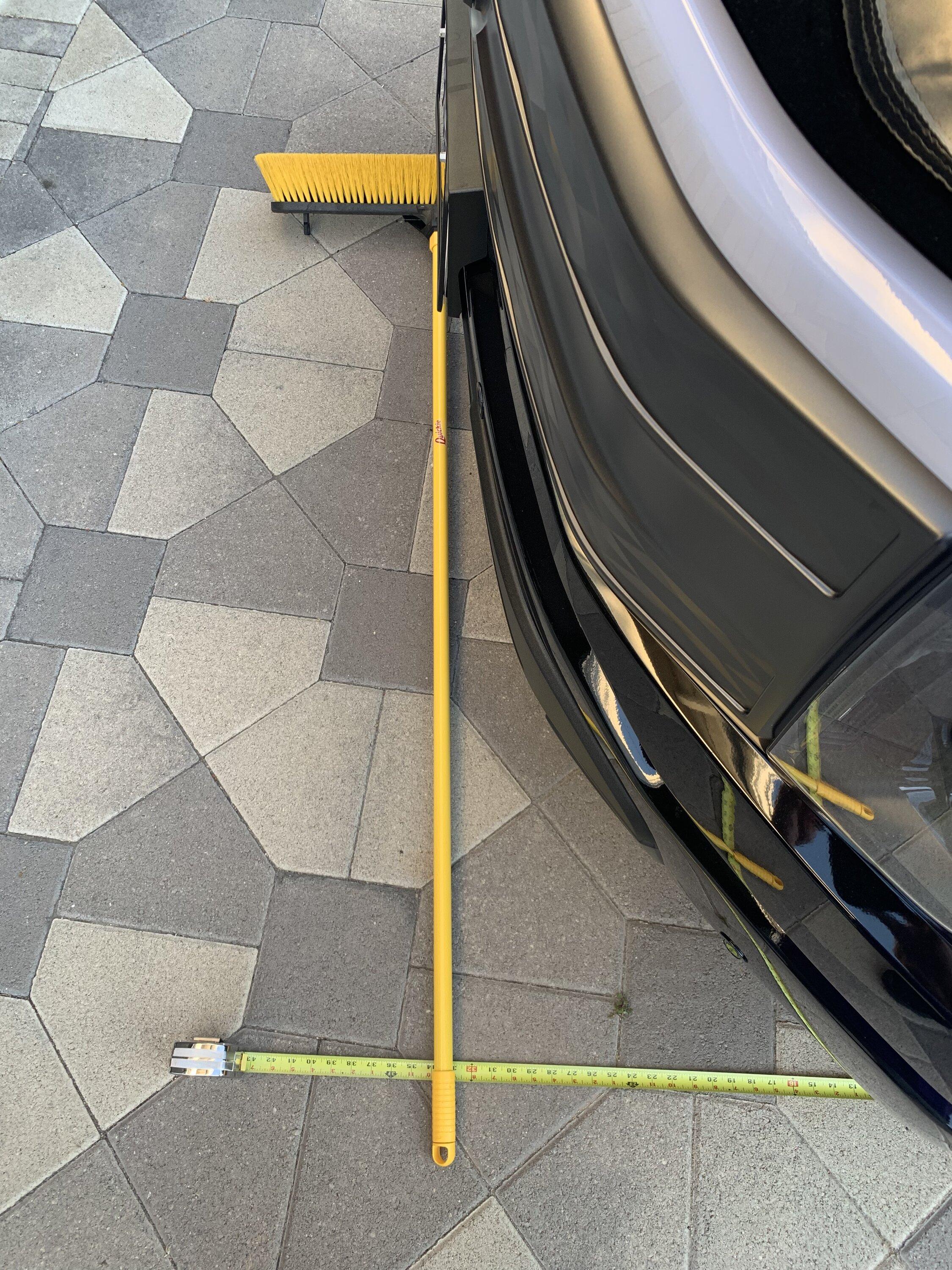

Stuff
89
207
So Cal
2022 F150 Lightning Lariat ER, 2024 Jeep Wrangler Rubicon 4xe
Using the super accurate broom marker, I would say 33 inches from the bottom of the tire to the bumper
Thank you for that. Exactly what I needed and think it will work. Leaving that bottom shelf in will give me needed stability for the shelf and I do have a couple of extra inches of room. I think it will work out perfect.
