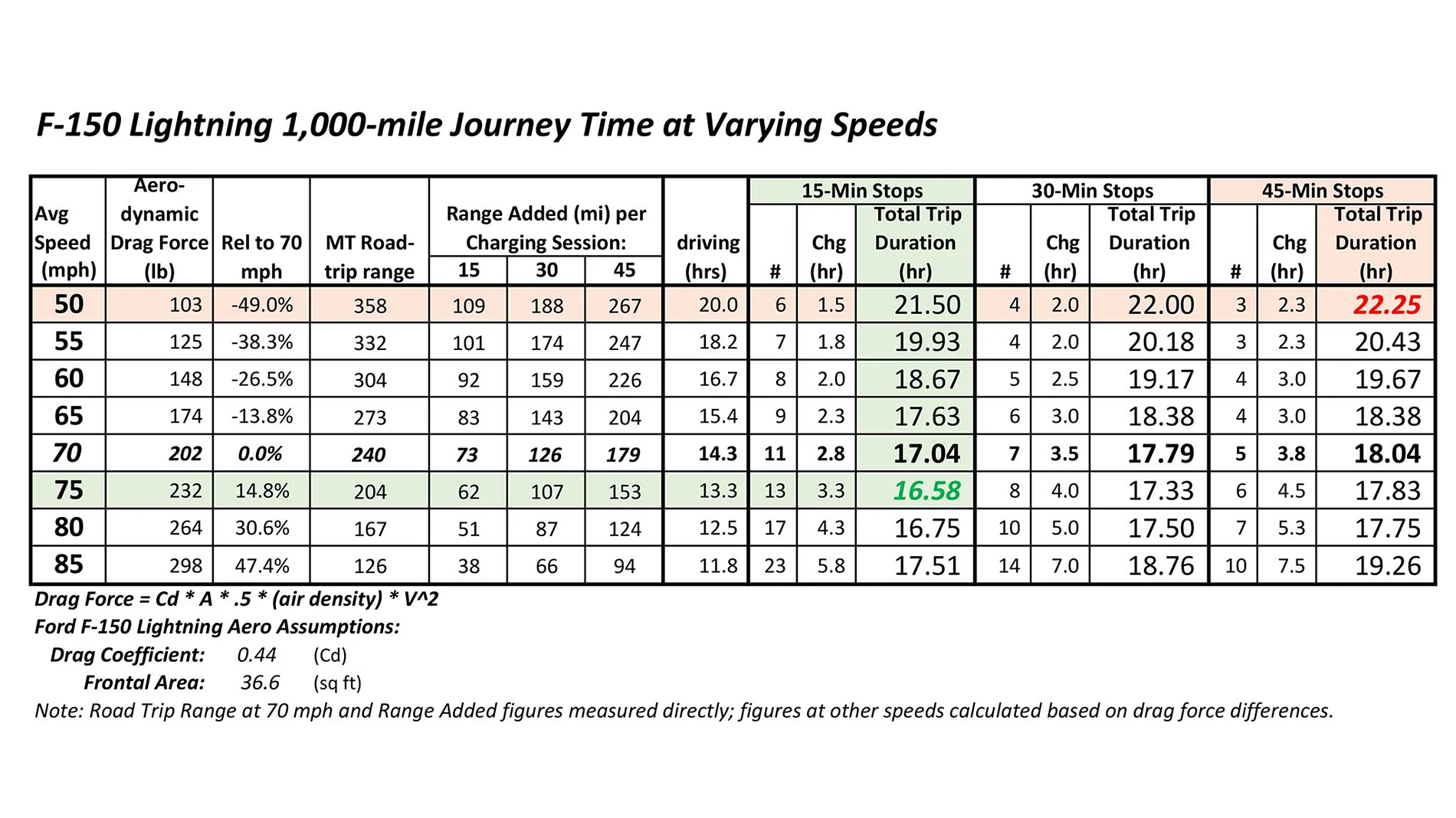

I have mapped a few dozen trips just to test efficiency, time, and speed. In the end more speed equals arriving there sooner, even up to about 90mph. Yes, you do charge more, and you do use more energy, however you still get there sooner.

Ah yes, because when you're driving long distances, there are fast chargers conveniently located every 60miles, just a stones throw from the interstate so you don't lose any time at all exiting/getting back on the interstate.
Besides the range at different speeds that table is pretty dumb.
