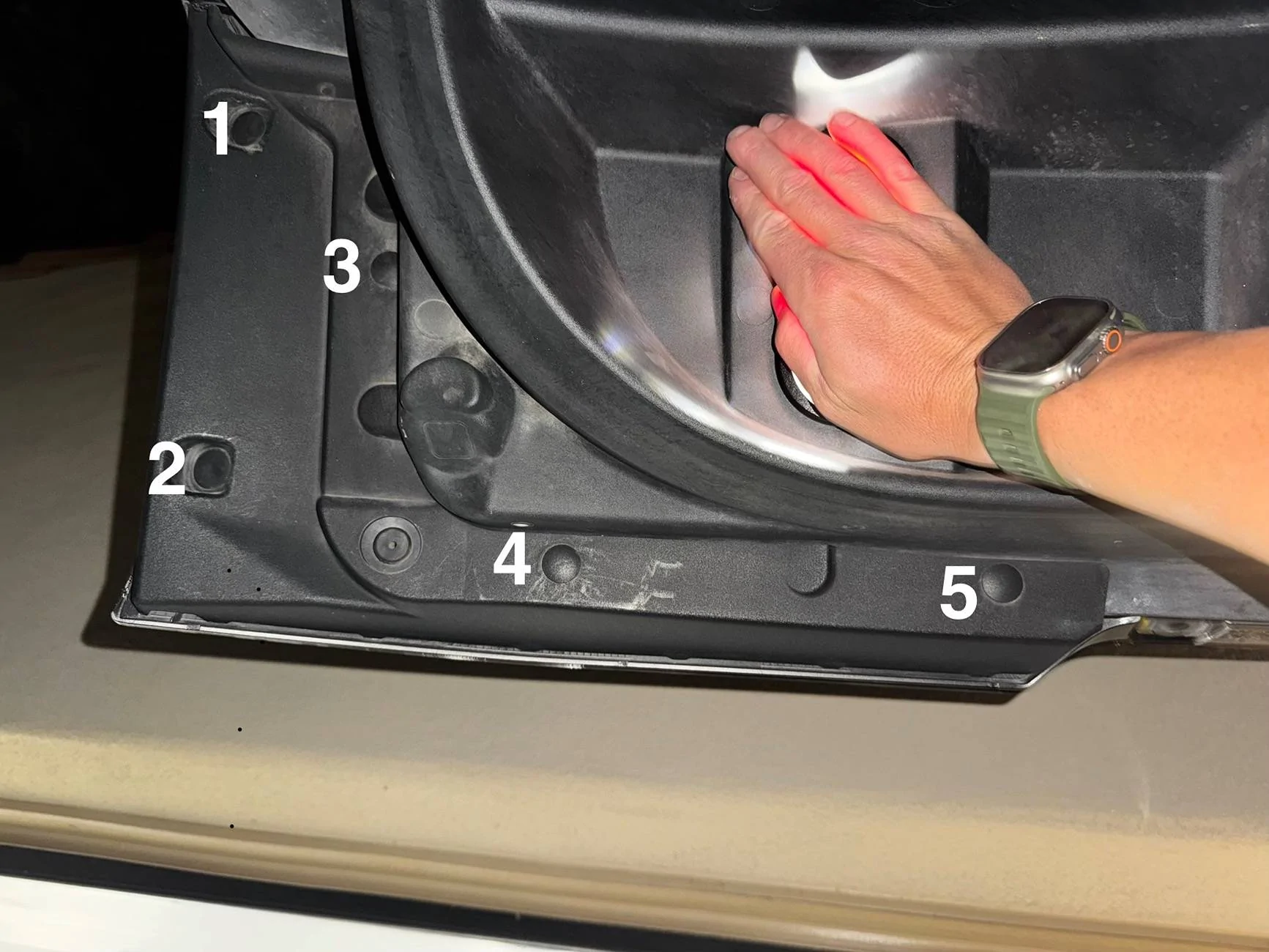

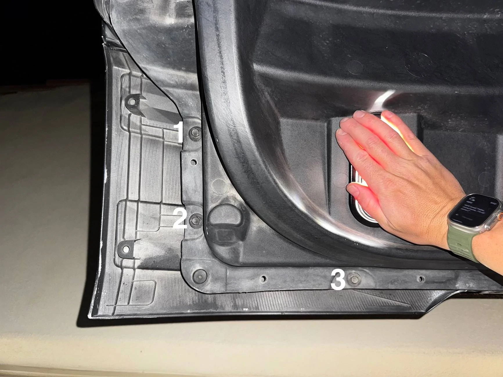

I didn't have a trim removal tool and getting the 5 rubber push fasteners out with a screw driver was not an easy task. I finally managed to get them out. After removing the trim panel in that side I was able to extract the damaged "Lift Gate Switch" what Ford calls the release button. I set it back in but it has some damage where it may be able to be pushed into the truck again. I ordered a new Switch from Fairway Ford using my Ford Pass points. BTW, I ordered a trim removal tool kit form Amazon last night an received it today.

i did order a new Front Trunk Switch using some Ford Pass Points. It was sent to our cabin. I will pop that in at the end of the week when I get back to the cabin. For now I left the driver side trim plate off so I could gain access to the switch connector.
