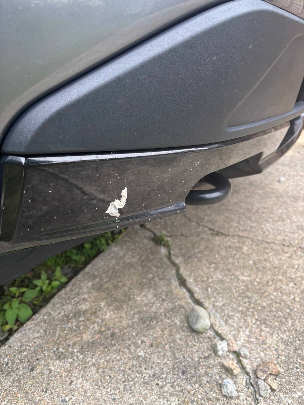

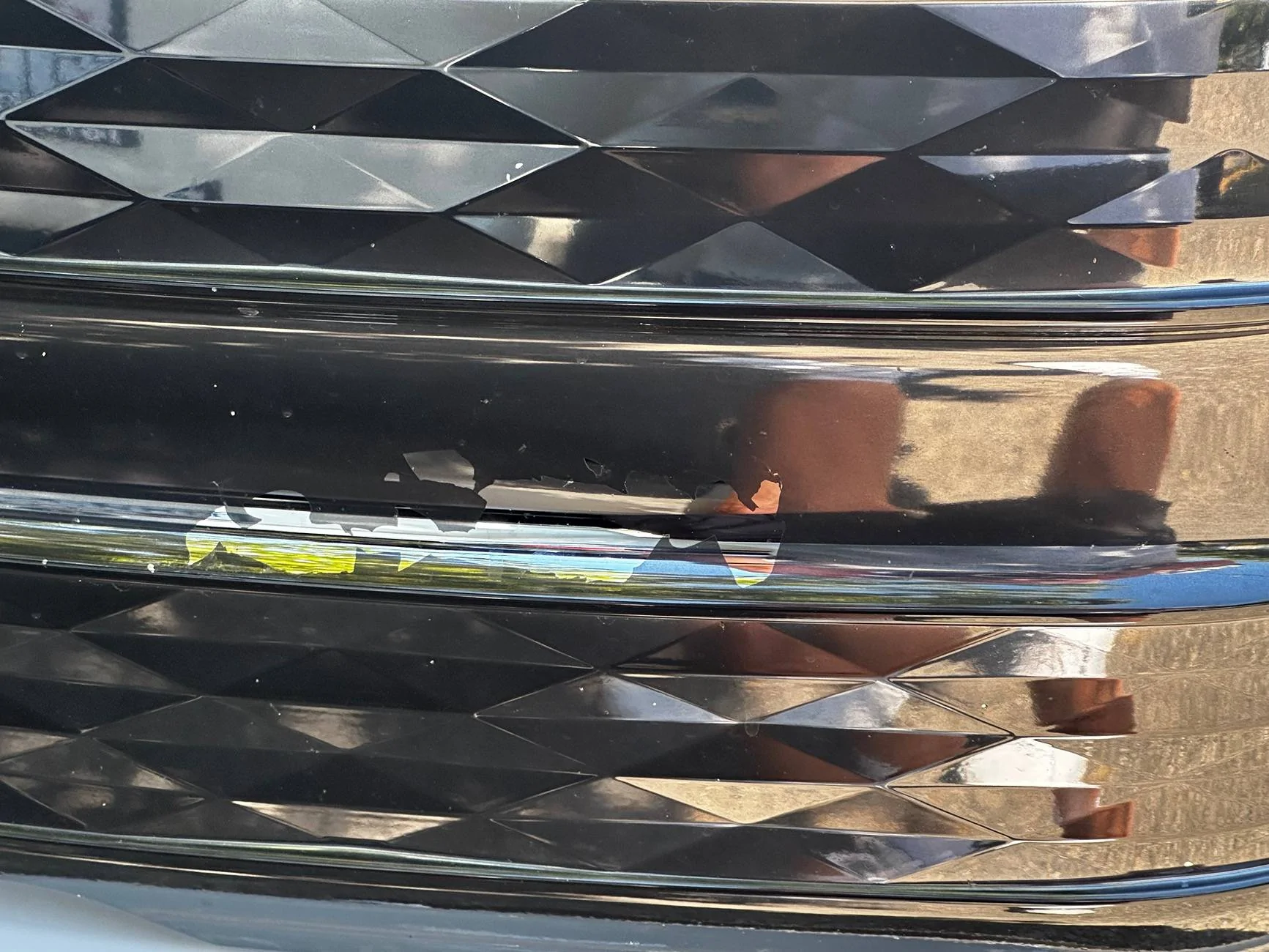

The tinting/film on my F-150 Platinum Lightning is pealing away after less than two years ownership. Because it has 40,189 miles Ford says they may offer some partial payment only if I take it to a Ford Dealer and get them to send it out for an estimate.
Joke for $100,000 vehicle.
Anyone else have this occurring?
thanks

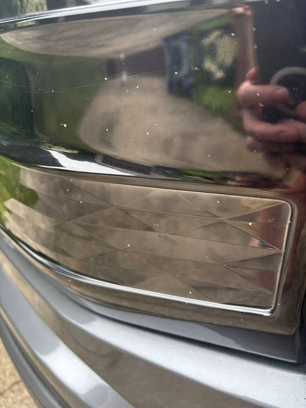

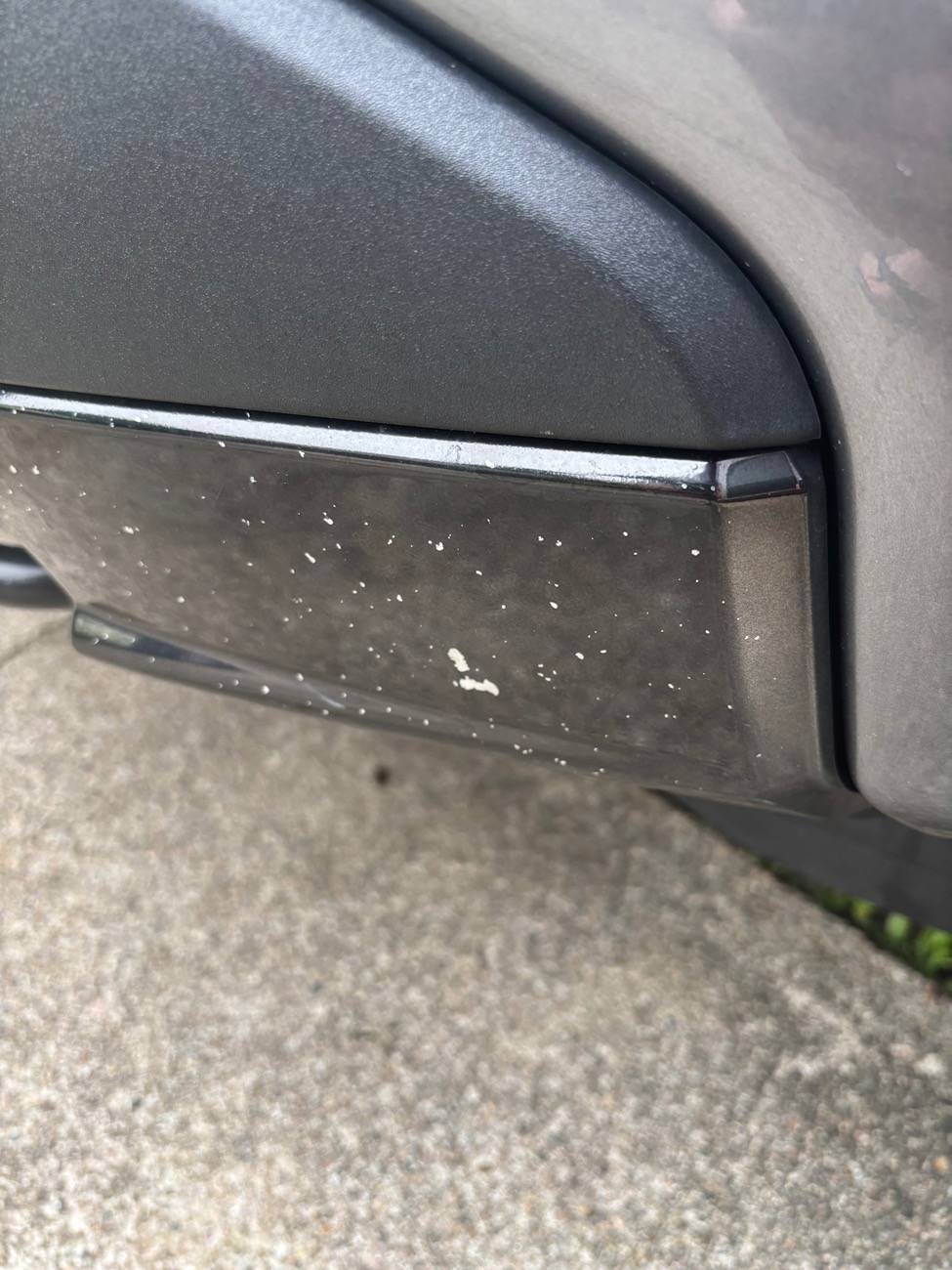

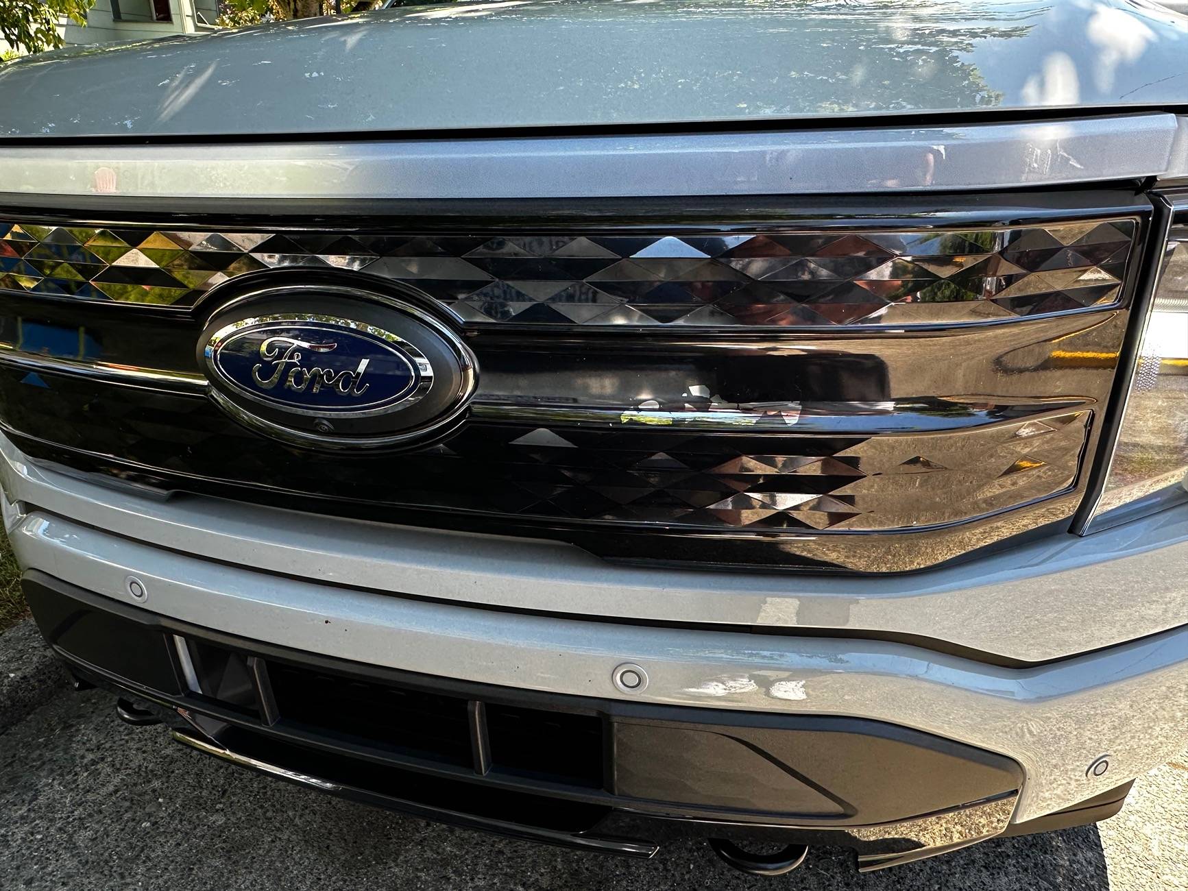

I am in the same boat. 22 platinum. 30k miles. Going to try dealer soon. @Ford Motor Company any help getting them to understand the issue is not normal wear.

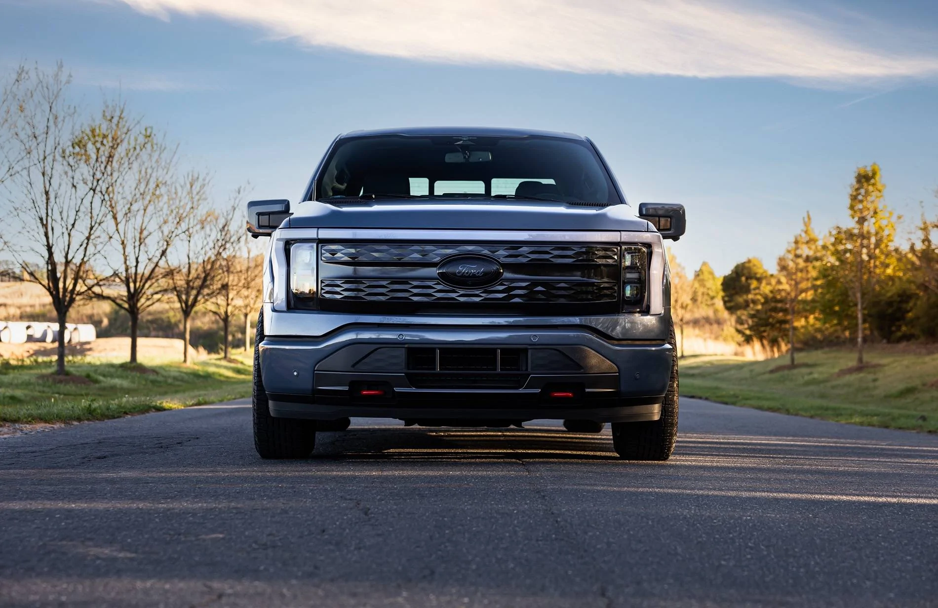

Vinyl wrap gloss black. 46,000 miles and still brand new.

Well that is total bullshit. I suggest finding a more reputable shop. It's easily done, dozens of people have done it. Mine is flawless. You can use my example as proof.
Cost me $180 and still looks as shiny, dent and defect free as the day I had it done.

Yeah, it's easily done and whoever says it can't be done doesn't know what they're talking about, are inexperienced, or just plain lazy. Mine looks brand new after 46,000 miles and I do a lot of highway travel, it's virtually impervious to rocks and chips and temperature and sunlight and everything else.
