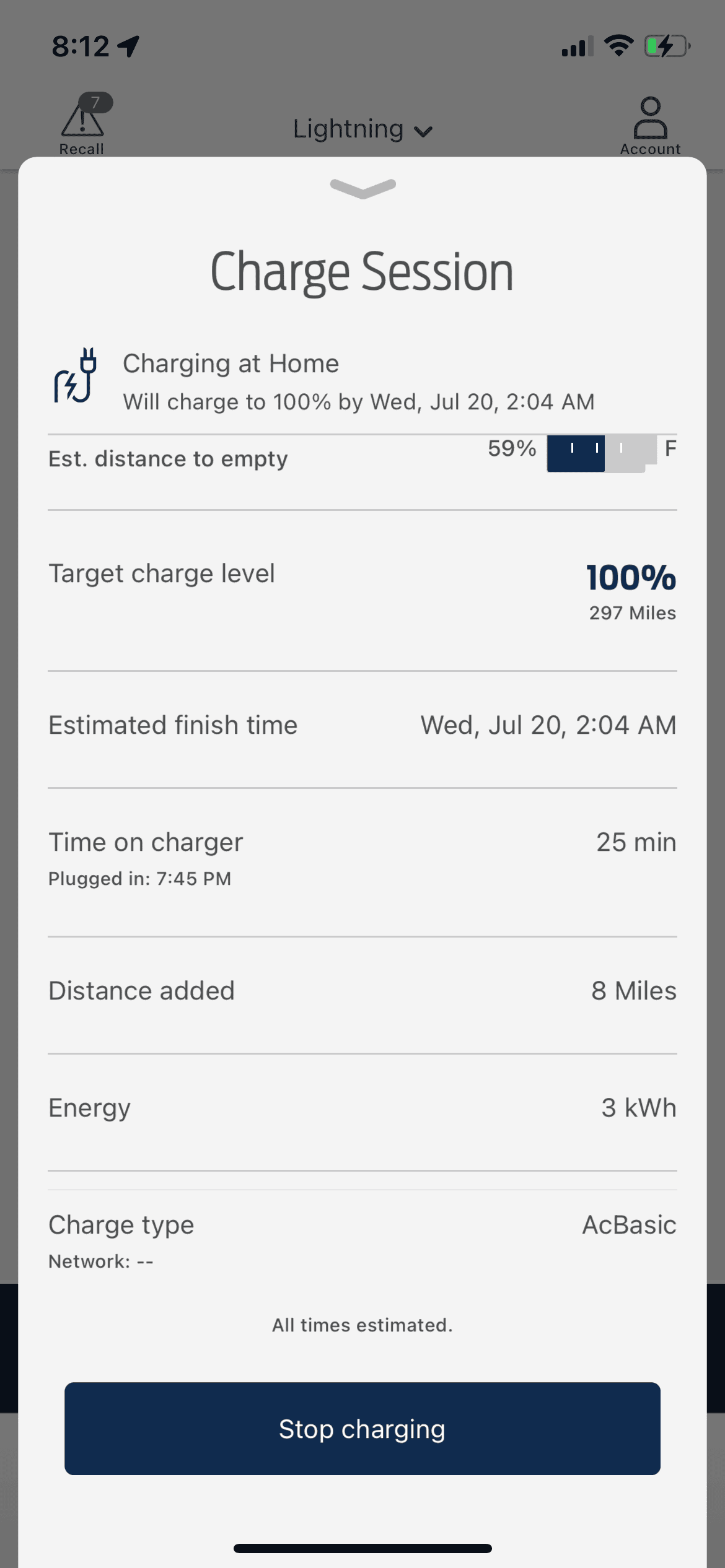

If at a retail charge station it seems the common data measure is the rate of charge kWh of the output. With the mobile charger, and now the installed CSP with full 80a breaker, I want to see a screen data that shows this. Not in the Charging tab in truck, not in the ford pass app, nor the “insights” for connected charger in pass app. What gives?
Why is this discussed as the focus of charging at public stations and not even present here? Thoughts?

Also, the truck charge level is set
To 85% not sure why the always says 100%

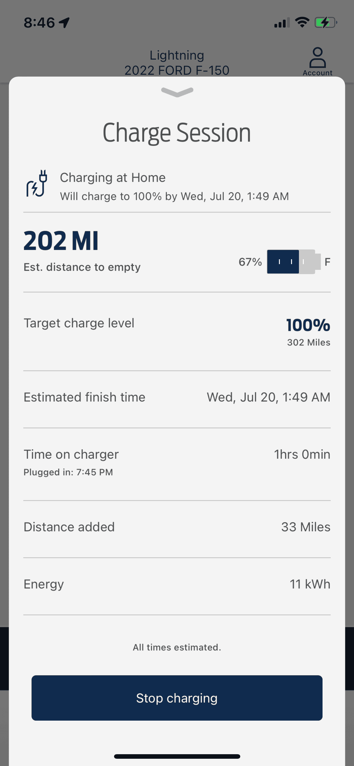

I want this data for my home charging. How do I know what real output I’m getting/receiving? I see the data and total energy. Is it simple math? One divided by the other multiply by time (or something like that)
at exactly 1 hour on charger, (like pictured) I’d imagine this to be easiest math If it works that way?

In the FordPass app, go to Vehicle > Charging > Charge Settings > Preferred Charge Times. Then select a Saved Location, like “Home”, click on the address to access the settings for that location, set the desired times and charging level, scroll down and click SAVE, then wait for the app to save (maybe do this a few times before it actually works), then make sure the radio button is selected for “Use preferred charge settings” for that location.
Or just get a ChargePoint Home Flex, and then you can control everything and see the charge data in the app.

You cannot see the charge current. One of my top issues with the truck. The data is available if you want to use an OBD2 dongle and app like Torque Pro. The only thing the truck will give you is estimated time for completion.
