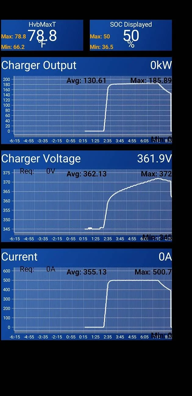

I think the big point here that a lot of new owners miss is that just because a station lists x kW, you may not get anywhere close due to the sub-400 voltage of the lightning's battery pack as it needs higher amperage to get the max speeds. That's why I like using Car Scanner so I can see what the station is offering and what the truck is requesting v actually receiving.

Nice plots, I need to play around with Car Scanner some more. I especially like the peak and average power noted.
