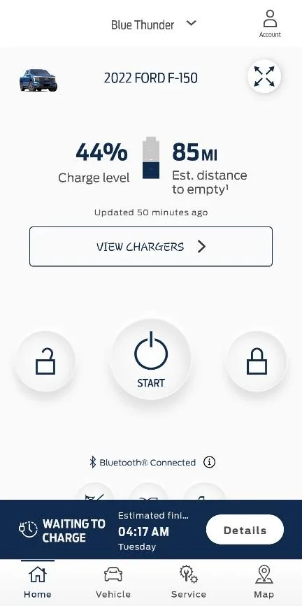

Is anybody else getting wild and innacurate guesses on when your truck will reach your set charge level using the FCSP? I never had these messages using my Emporia charger.

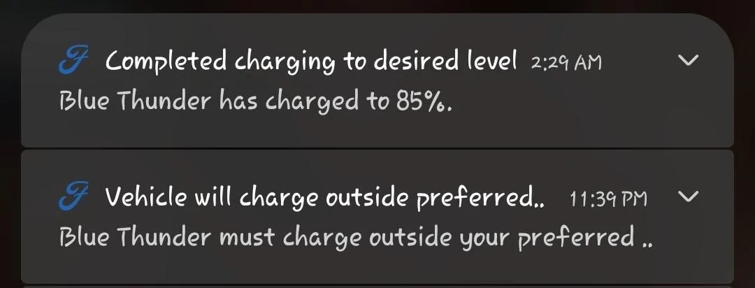

Before my 11:00pm scheduled time to start, it guesses that it will take until 6am to finish. I don't have a screenshot of that. When it starts charging, it then estimates it will take to almost 4:30am.

Sure enough, at 2:30am the truck reaches my set limit. But what's even more strange is less than an hour after it starts charging, it alerts me that it will have to charge outside of my charge window to reach my set limit. My window ends at 6am.
