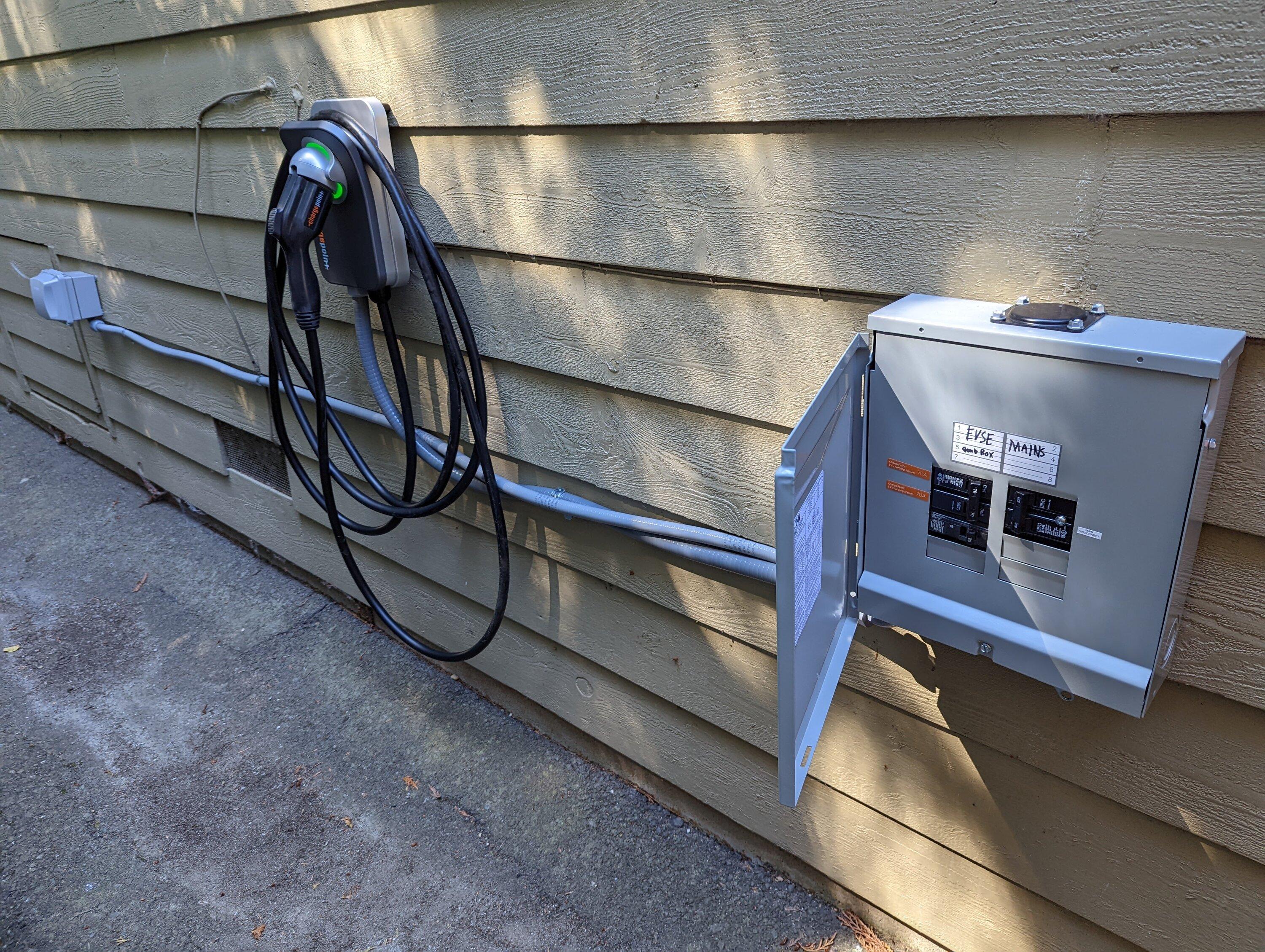

Oregon
Wanted to update this thread with a pic of the completed install (I am missing one conduit clamp).
Ford F-150 Lightning Installed ChargePoint Home Flex CPH50 PXL_20220814_220054612
Nice install. I'm not always a fan of flex (except for things like motor connections) because of the droops-n-swoops, but you got it reasonably straight (something I have a difficult time doing without straight conduit lol).
