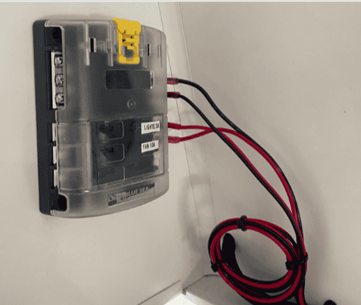

I'm looking to power a camper top using the ProPower Onboard outlets in the back. Does anyone have recommendations for an inverter going from 120v to 12v?
The 120v side needs a normal plug going into the ProPower socket. The 12v side needs to hook up into the camper fuse box.
It doesn't need to have too many amps. It's just powering a RV fan and maybe some LED lights.
See the picture for what it needs to plug into to power the fan and lights.
Thank you for recommendations.

You might want to get a battery charger like this one. It has a power supply mode that will give you 20A at 12V and of course it can also be used to charge 6 and 12V batteries. They also make higher current versions if 20A isnโ€™t enough.
Clore Automotive PL2320 20-Amp Fully-Automatic Smart Charger, 6V and 12V Battery Charger, Battery Maintainer, and Stable Power Supply with Temperature Compensation https://a.co/d/hsVyT2P

You could probably cut the end off a more heafty computer transformer if you have one around?
