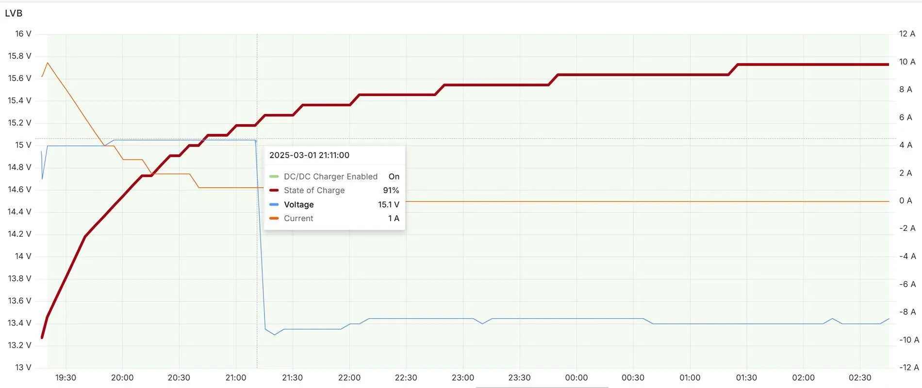

My plug-in display with USB ports on the dash 12V socket has shown over 15V a couple of times when starting up the truck. Minimum lately has been about 12.5Vdc. Is not 15Vdc considered too high? I should probably stick in a voltmeter to double check when I see that.

Typical AGM battery charging is higher than other types, usually in the upper 14 volts range, but I guess 15 is what Ford is using - when charged and floating, should go back down to around upper 13 volts range if healthy.
So normal for our AGM batteries.
See: https://www.renogy.com/blog/agm-battery-voltage/
Plug-in automotive items shouldn't have any problem with the 15V because they usually have voltage regulators to handle that much over-voltage, but check the product literature to be sure before you fry your favorite plug-in.
