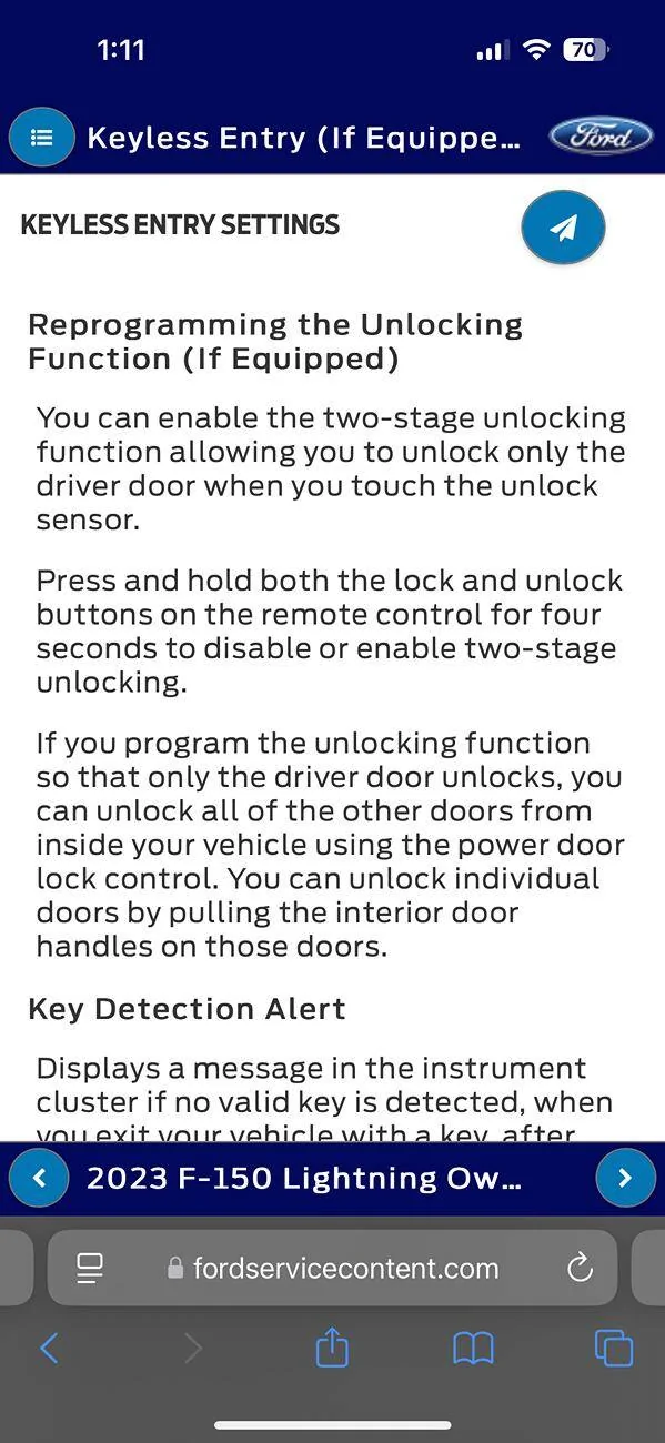

If you look in settings there should be a setting for the key fob where clicking the button once opens all doors rather than opening just the driver side (this is the default).
It's possible changing this setting to unlock all doors will work for you. I don't have the features you have to confirm, but I did notice something interesting about changing this setting: the keypad on the door unlocks all doors now. Whereas before it only unlocked the drivers side. So the setting isn't just for the key fob.

Or it could just be this:
Ford F-150 Lightning Is passive entry the only option if I want all doors to unlock? IMG_0878
