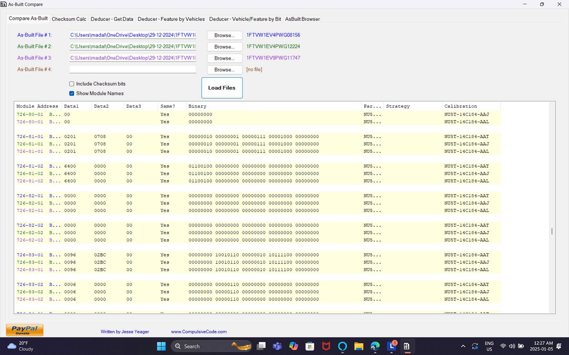

Success, Finally! I've been working on this hard for well over 2 weeks and have had dozens of people ask me how it's going at various times. I know a lot of people want this so I'll make this DIY as comprehensive and logical as possible because not everyone's vehicle is the same as mine. I've learned a lot and I'm an electrical engineer, but I'm still far from an expert on automotive electrical engineering and still absolutely dumbfounded as to why Ford did some of the things that they did; I'll try to explain what I do know and assume throughout this DIY, so if someone encounters differences they can try to understand them.
Special thanks to Jesse @ Infotainment, he helped me a lot with firmware (yes this requires flashing firmware, sorry). I think he is going to offer this as an upgrade from Infotainment in the near future depending on the interest and demand for those people out there who aren't comfortable with FORScan.
My truck is a 2022 XLT EG-311A and I got it back in Sept 2022. I still love it as much as the day I got it and I now have over 25kmi and haven't had one single issue (that I didn't cause :).

Now on to the FORScan work. Best Jesse and I can tell: ALL Lightnings use the same BCM hardware part. But unfortunately the code to drive that low frequency antenna from the BCM doesn't exist in the firmware of a truck without passive entry. So you have to flash the BCM with an EG-312A firmware. This is critical because Lariat and Platinum trucks don't generate the low frequency signals from the BCM. To my knowledge only the EG-312A package trucks do it this way, so I'm working with FORScan to add this firmware to their firmware server and by the time anyone tries this they should have it available in the MFU section of FORScan. If you're not comfortable with FORScan and don't have an extended license, you'll need to research it a bit, this DIY is getting long already and I don't want to teach anyone how to use FORScan here. But you can start by reading this:
https://forscan.org/forum/viewtopic.php?f=13&t=23971
The XML straight from the AB file of the 2022 XLT EG-312A is:
<NODEID> 726
<F10A>NL3T-14C636-LAG</F10A>
<F10E>NL3T-14G570-GAC</F10E>
<F110>DS-NU5T-14B476-AAE</F110>
<F111>NU5T-14F141-NAA</F111>
<F113>NU5T-14B476-NAJ</F113>
<F16B>NU5T-14F391-BAA</F16B>
<F16C>NL3T-14F390-AAE</F16C>
<F16D>NL3T-14F389-CAA</F16D>
<F16E>NL3T-14G163-AAA</F16E>
<F17D>NU5T-14G162-NAB</F17D>
<F17F>1BR1PE5Y</F17F>
<F188>NU5T-14C184-AAJ</F188> (Strategy)
<F18C>22200194529</F18C>
<F190>1FTVW1EL2NWG06496</F190>
</NODEID>
This defines the firmware and all files you need to use the MFU function of FORScan to update the module. Like I said above by the time you read this FORScan will have these files in their firmware server for you to use once you purchase the extended license. I'm not going to lie, the first time you flash firmware to a module it's scary AF, you'll want to hold your tongue at a 45deg angle and keep your left eye shut; but don't let this step discourage you, I flashed multiple wrong firmware to my BCM and was able to revert to my factory firmware each time I failed.
Aaaaaand, you're almost done. Since this upgrade is only the drivers door you can't just take an AB from the EG-312A truck and go with it b/c it has a tailgate module and other tailgate stuff. So, through a long and pain full process I was able to put together this spreadsheet of changes you need to make:
FORScan BCM Config Changes
Note: you will get approach lighting (welcome lighting) with this config which is really awesome. Nothing about the passive entry mod hardware is necessary for that, but since the config was right there I decided to enable it and it all works wonderfully.

I need help please, i have 2023 f150 lightning 511A lariat my as build file is corrupt, i have ford field engineers fixed my pro trailer backup assist and punch modules update adding walk away lock after this my passive entry for the back doors stopped working unless i hold the key fob close to the driver Handle and touch the back door handle at that time the back doors will lock and unlock but the phone as a key work fine, so the dealer try to replace the BCM and it did not worked they tried 2 BCM each one say it is not compatible with truck software, i did start my research i compared my truck as build with about 20 trucks similar to my truck non of them same my calibration file the only one same calibration is 2024 lariat or platinum, can you please help me to find my BCM firmware i do have forscan beta to preform the flashing if i have the wrong BCM firmware my truck is the first vin number on the top end with 08156
thank you.

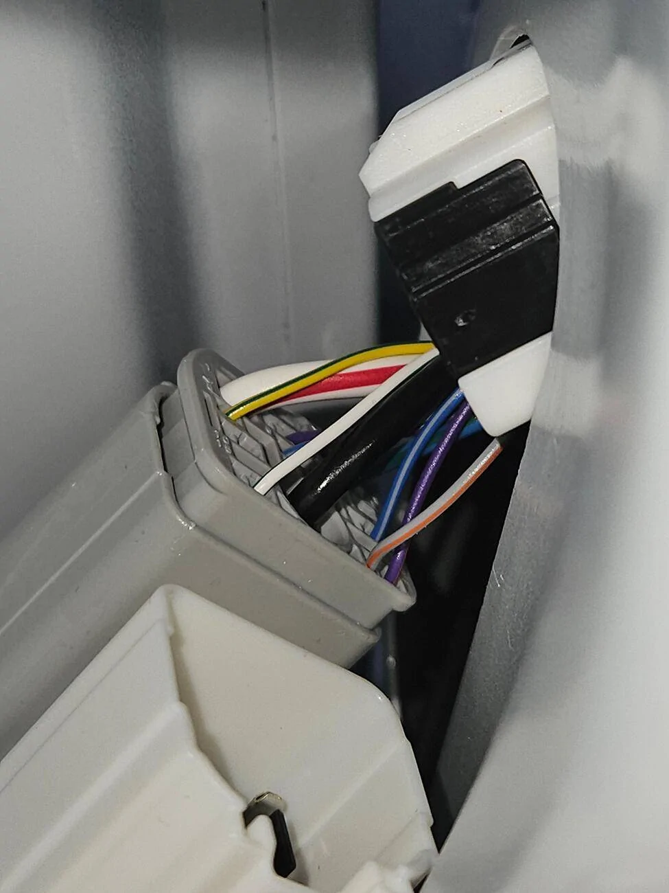

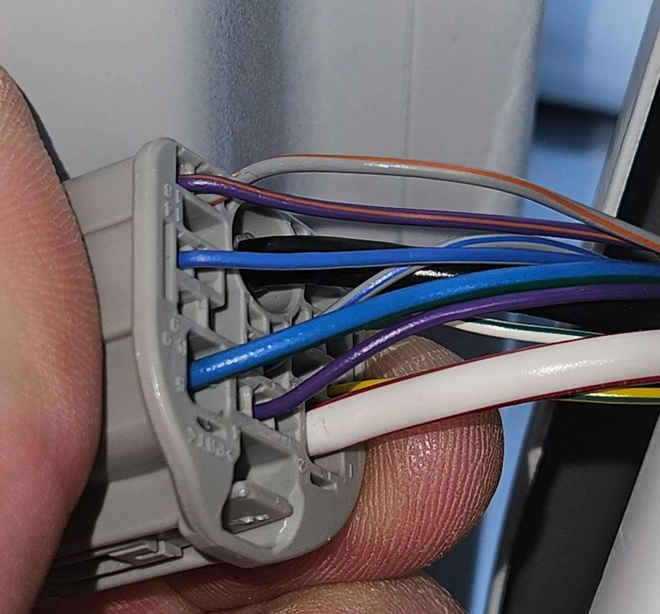

So I popped off the connector on the driver's door and it looks like I don't have the wires on my 2024 XLT EG-311A :sadface: I'm hoping that either the wires are just different for 2024 or that it isn't hard to add them.
Ford F-150 Lightning DIY: Installing Passive Entry To A 2022 F-150 Lightning XLT 1739047736733-rq
Ford F-150 Lightning DIY: Installing Passive Entry To A 2022 F-150 Lightning XLT 1739047472412-ic
