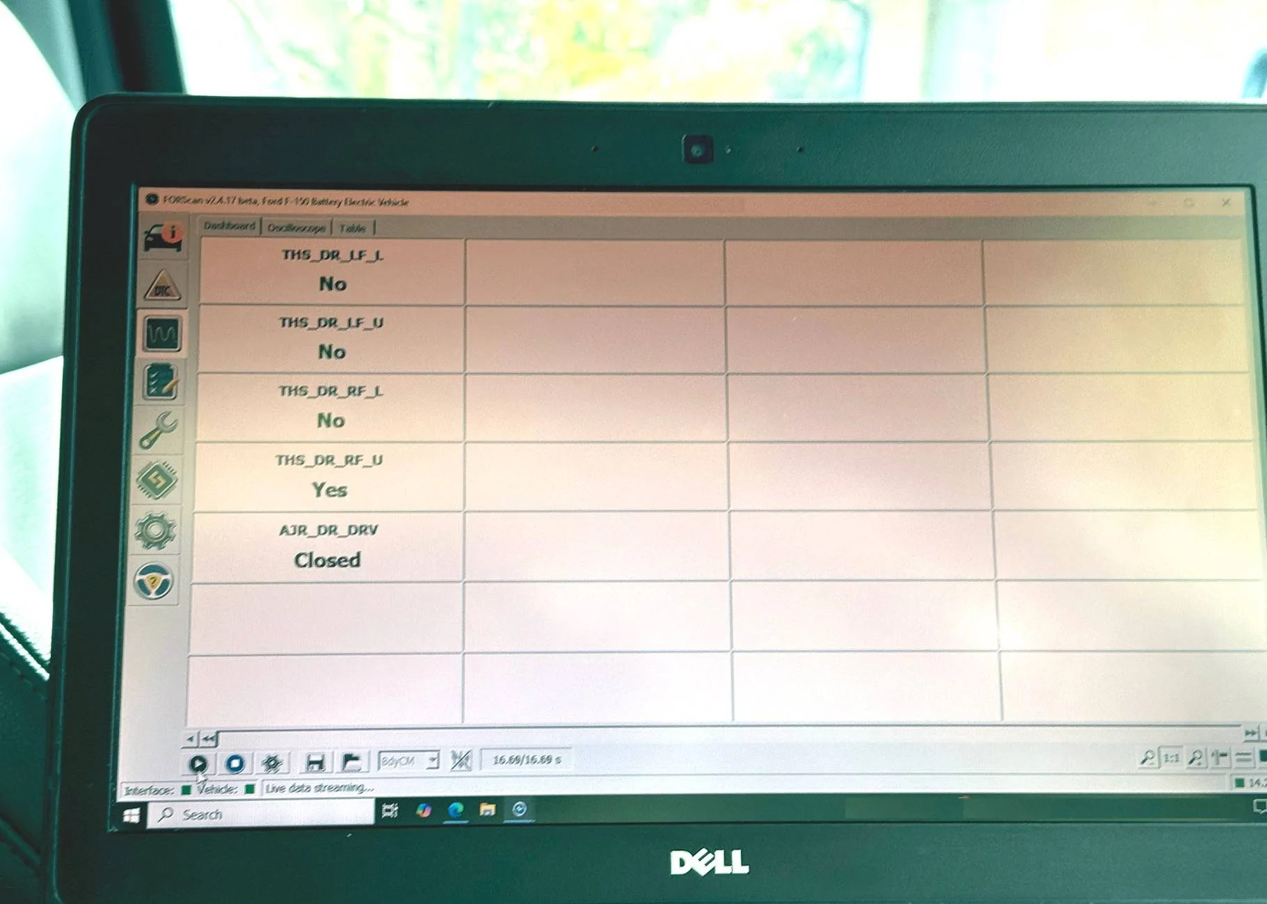

Hey everyone. Does anybody know if the touch sensor request PID names were renamed or changed? I've finally had the chance to wrap up installing Passive Entry on my truck and when viewing live data (oscilloscope) neither of my doors (I did both driver and passenger handles) show up. I have not done the firmware update yet.
Overview: I did the driver's door handle last fall and was able to get it to show up by observing the LK_LF_LK_TCH/UL PIDs but now it doesn't after adding the passenger door handle today and retesting (hadn't tested since last fall). Thinking it was maybe a FORScan issue I upgraded (v2.3.65) and then I couldn't even find those PIDs to listen for. Reconnecting and not loading my previous profile the closest I could find was THS_DR_LF_L/U but those don't work either.
As an aside, the driver door open/close PID does work but that appears to be renamed to AJR_DR_DRV for me.
Any thoughts?

So it looks like the PIDs did change, at least for me. Attached is an image showing the four revised door handle touch parameters along with the driver door ajar parameter. Not sure how many have changed.

Do the sensors show up using the "Live Data" feature of FORScan (oscilloscope)?

Try adding the values I posted previously to the BCM "view." e.g. driver's door would be:
THS_DR_LF_L
THS_DR_LF_U
You can also filter by "touch" and they'll show up. Note that these values differ from the ones that were originally posted at the start of the thread. I think at some point they changed. If the sensors don't register and you had continuity from the BCM to the handles it's most likely a FORScan entry that is incorrect or missing.
