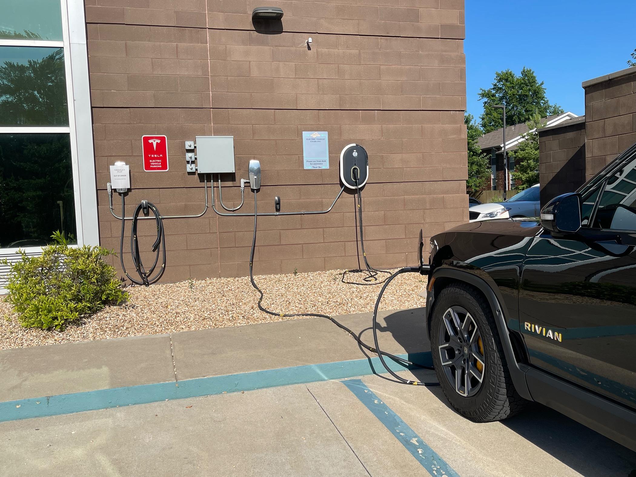

I've seen photos on Plugshare of Rivian's and other EVs charging at this destination charger. I know for a fact our Lightning will not (tried it repeatedly). I've seen people claiming their Lightning charges just fine on a gen 1 Tesla wall charger at 60 amps but won't initiate a charge at 80 amps.

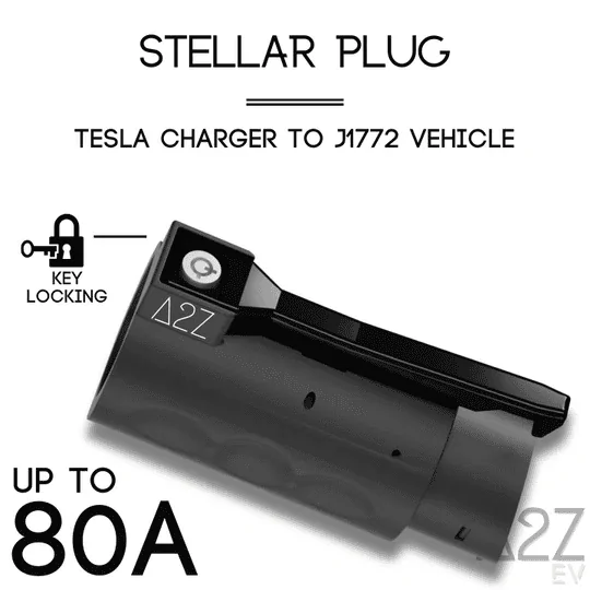

I have a Tesla and a Lightning. I use the adaptor in the link below with my Home Tesla Wall Charger for my Lightning. It's rated up to 80 amps. I have my Tesla Wall Connector hard wired to a 60 amp circuit which delivers 48 amps or 11.7 kWs to the Truck.
https://www.amazon.com/gp/product/B0C9SLSZQD/
Some follow-up: I ordered this from amazon, it arrived today and already successfully used it to charge the truck from the Tesla Wall Connector.
Thank you again for the recs!

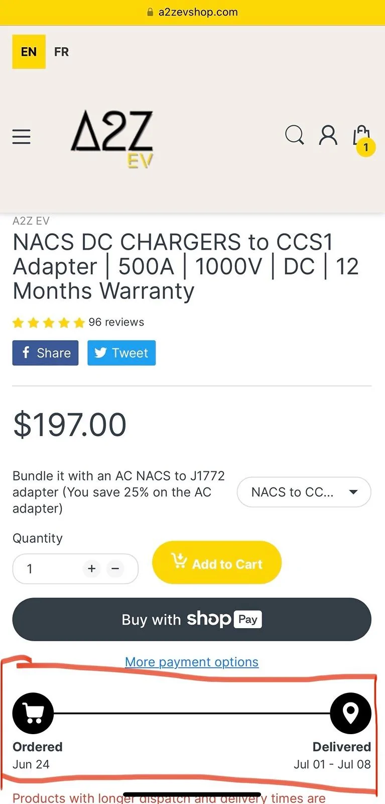

I purchased an official Tesla OEM adapter and will work on a review this week to compare it to A2Z Typhoon.
Current shipping times is 1 week if you order an an A2Z adapter today. Still in time to have some road trips in July / August using the Tesla network.

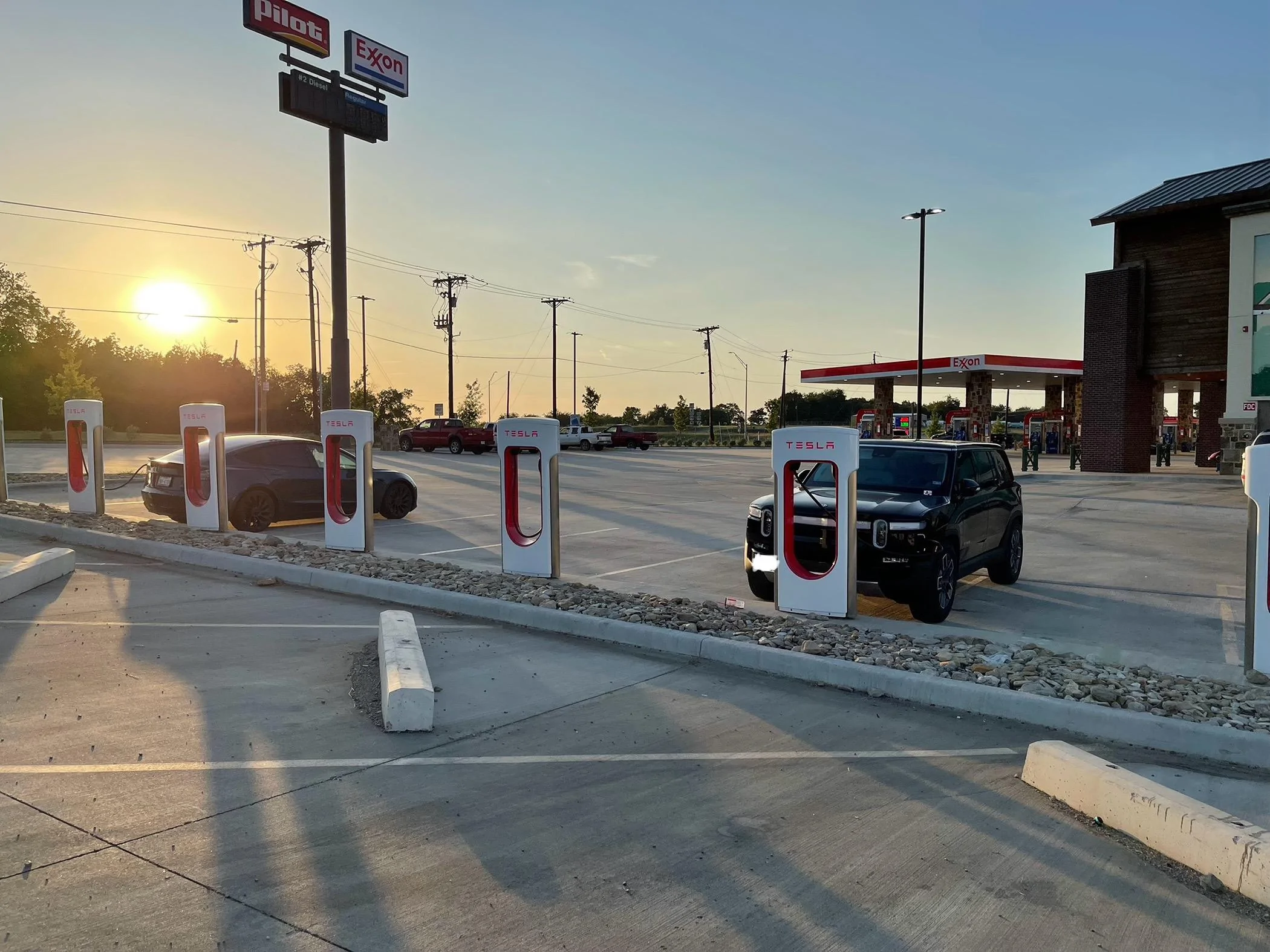

I used that same charger last week. This time in the Lightning. It was the same feeling as when it first opened several years ago and I got to use it with my Tesla. It shaves off almost an hour if you are going into or out of Oklahama. Bonus, if you park on the other side of the curb of charger 2d you don’t have to block two stalls.
