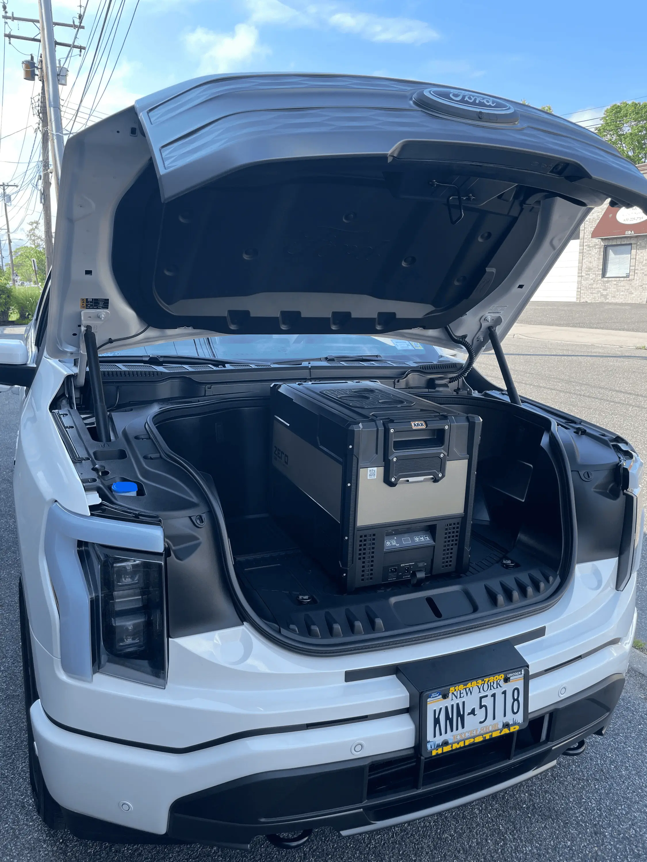

This 47qt is a bit too big but a smaller one would work
I have a Gen 1 37 quart, so it should fit. I was looking at the Engel because it wouldn’t come straight out the middle like you have the 47 quart sitting In that pic.

A refrigerator is a heat transfer device. If it is in the frunk you are transferring the heat to someplace it has no place to go.
How do you vent the frunk?
How does the battery in the frunk keep cool???

The battery is behind a panel. Maybe removing the panel might be enough ventilation.

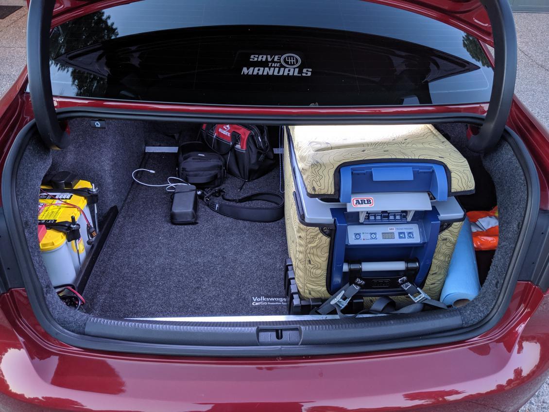

I consider myself an ARB fridge expert after living out of two different ones for more than 4 years while traveling for work 40+ weeks per year. I ran the ARB 37 quart in the trunk of my sedan for a couple of years without venting, I never had a problem. Before that it was a 50 quart in the cargo area of my Touareg, also not vented. The exterior temps and desert sun in Phoenix resulted in the car having interior temps of 140-160 degree F, the fridge didn’t appear to add much to that. I’m sure the fridge wasn’t operating at peak efficiency, but it kept my food cold.
I don’t anticipate issues running the ARB fridge in the frunk in Massachusetts with much cooler exterior temps.
