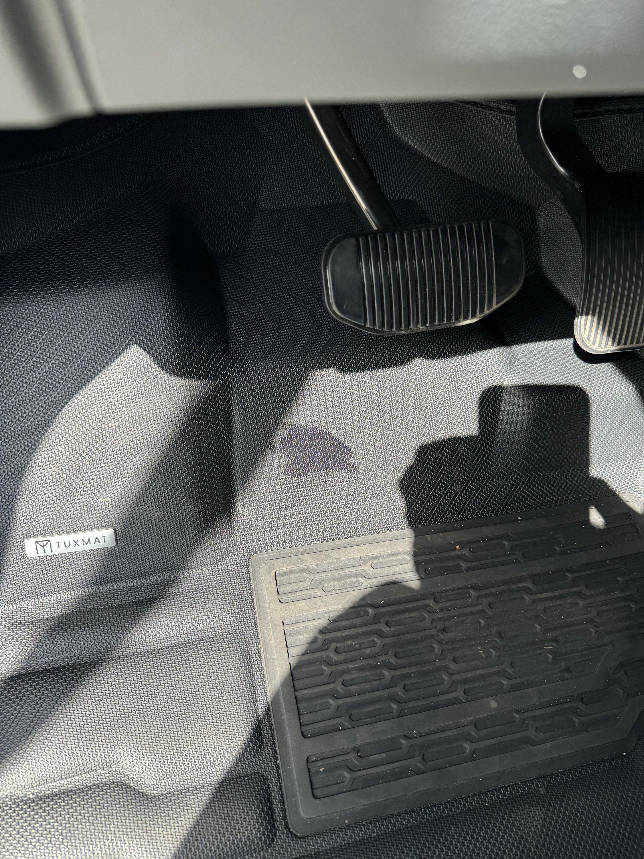

Found this leak and not sure if it's something I need to worry about and get serviced or not. Any idea what caused it?

I had a leak similar that in my previous ford. It tunrned out to be grease dripping from the adjustable pedal mechanism. Annoying but not an issue.

I have never seen this in mine - is it water or a lubricant?

I found I have almost the same thing it is brake fluid Ford changed the brake booster behind the pedal. They had to order the part about a week I use one pedal driving so not to much on the brake pedal
