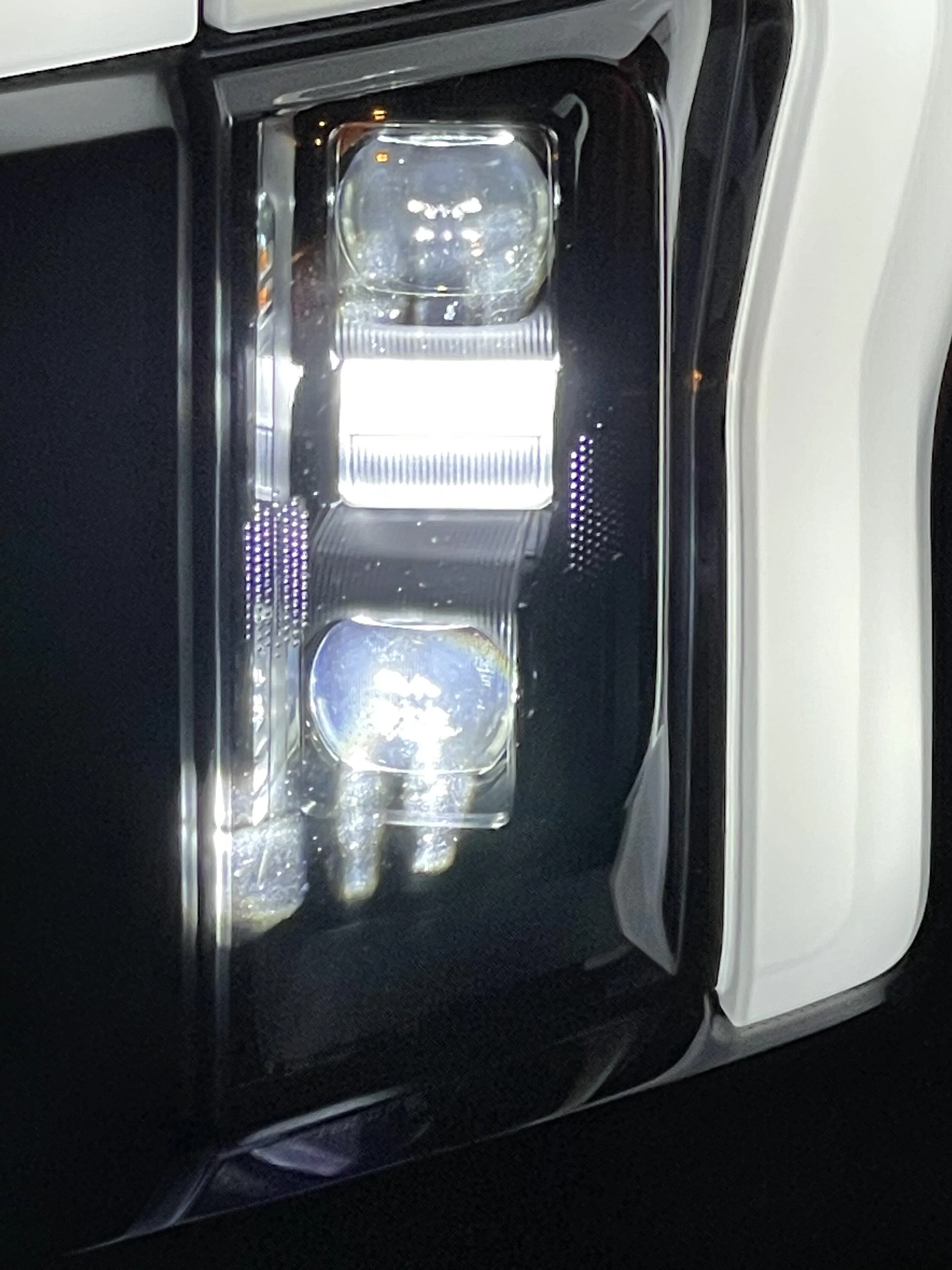

Does anyone else’s headlight sweep out and then back in when you first start the vehicle? My left headlight sweeps left and then centers itself, shown here. I want to know if this is normal.

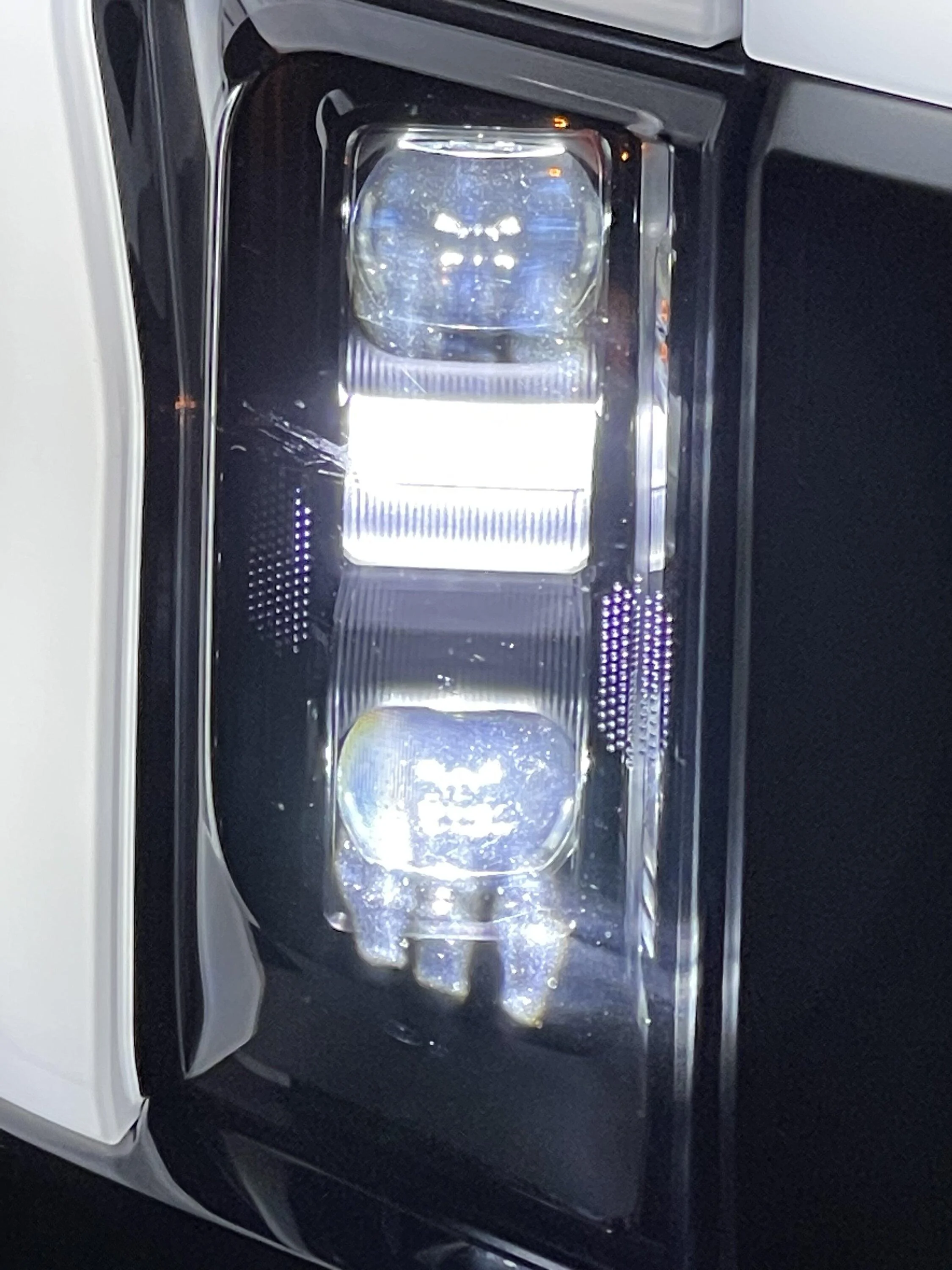

Only the left light swivels fully outward and then back over during start. The right remains stationary. I actually just noticed, with steering wheel centered, the left light projector is offset inward, compared to the right, which seems to be in a neutral position.

From what I see in your video, the right side is sweeping quick and normal. The left side seems extremely slow and is not normal. They should both sweep at the same time and same speed.
I agree, I see the right side start up much faster than the left. How are these headlights supposed to track while driving? If the road has a gradual curve, the headlights pretty much track with the steering input. However, if I make a left or right turn, and quickly center the steering wheel, the lights lag about a second after centering. Not sure if thats normal or I am just seeing the left headlight having an issue with tracking.

There should be no lag. If you quickly center they should also quickly center. You can make them wiggle by wiggling the wheel.
Your left light has an issue when moving left but seems to move to the right closer to normal. The right light one looks to be working correctly.

They do wiggle with the steering wheel. I looked up some videos online and my headlights do react the same way when turning. The lag when quickly centering the steering from either direction also seems normal. I wonder if Ford will say that the lag in the startup sequence and offset when finished is normal and okay if not throwing a fault code. The left light does seem to center after driving.
