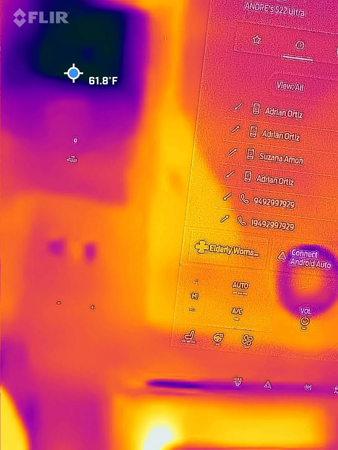

I had this heater issue today. Got in the truck after work and took off. Noticed cool air, turned up control to 80°, only mild change. Got out, ran quick errand and back in. Still rather tepid. Curious what will happen in the morning. Not charging tonight as this is my first week to see how long I can make it with one or two charges.
Drayday55
Drayday55
Andre
Jun 9, 2022
454
462
San Diego
22 Lariat Lightning
Contractor
My truck is still retarded.. 74degrees is blazing hot. Not just when I first turn the truck on but after driving for 30min. The temp sensor seems to not be registering actual temp.
