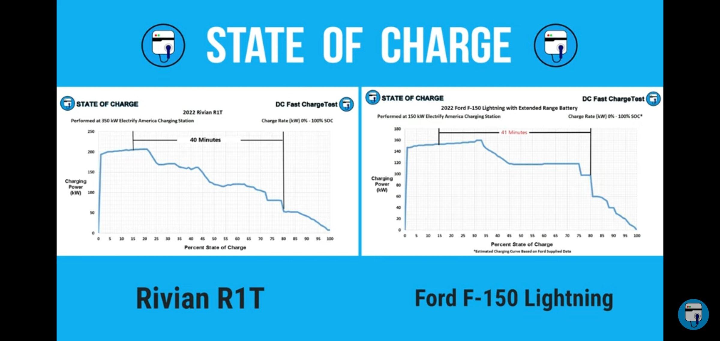

There has been some complaint about Lightning 150kW DC fast charge power rating, compared to Rivian "up to" 210kW of peak power. A new TFL test starting at 20% SOC one might expect to roll a DC fast charge station at, showed rates that did not exceed 151kW. It falls off a cliff and hits 79kW at 67% SOC.
Lightning specs indicate 54 miles in 10 minutes - no indication of SOC this occurs at so we should assume it would be at a low SOC. If Lightning is 2.15 miles/kWh, this would be 25.1kWh over 0.1666 hours or an average rate of... 150.6kW or a nominal 150kW max rating.
Point is that Lightning charge rate might match Rivian charge rate at some points in the SOC range. In fact, Lighting still has the opportunity to pump more kWh into the vehicle from 20% to 80% SOC if Ford can hit a home run with the charge curve.

Looking like Lightning will essentially match R1T time from 15% - 80% SOC due to Rivian taking a steep nosedive in charge rate everywhere above 20%. This appears to be with Rivians up to date selected charge curve and not in summer heat.
However, this is still based on a Lightning curve estimate from data @tommolog says he got from Ford but hase not shared.
If accurate, I'd rather live with the Lightning curve and not play the game of trying to time fast reacharges around draining to near-zero SOC before stopping.
@tommolog - put these charts on the same kW scale for side by sides!

Rivian seems to have thermal management issues. It has a nice top charge speed, but drops off fast. I think Lightning will charge faster at this point until Rivian figures things out.
