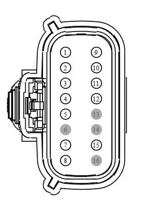

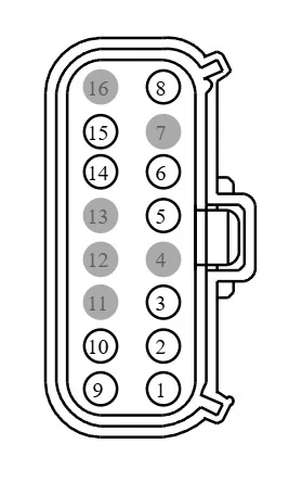

The connectors are completely different between a smoker 150 and the Lightning. At least they are for the 25 year models.
1st pic is a regular f150, 2nd is the lightning. Close but no cigar.
