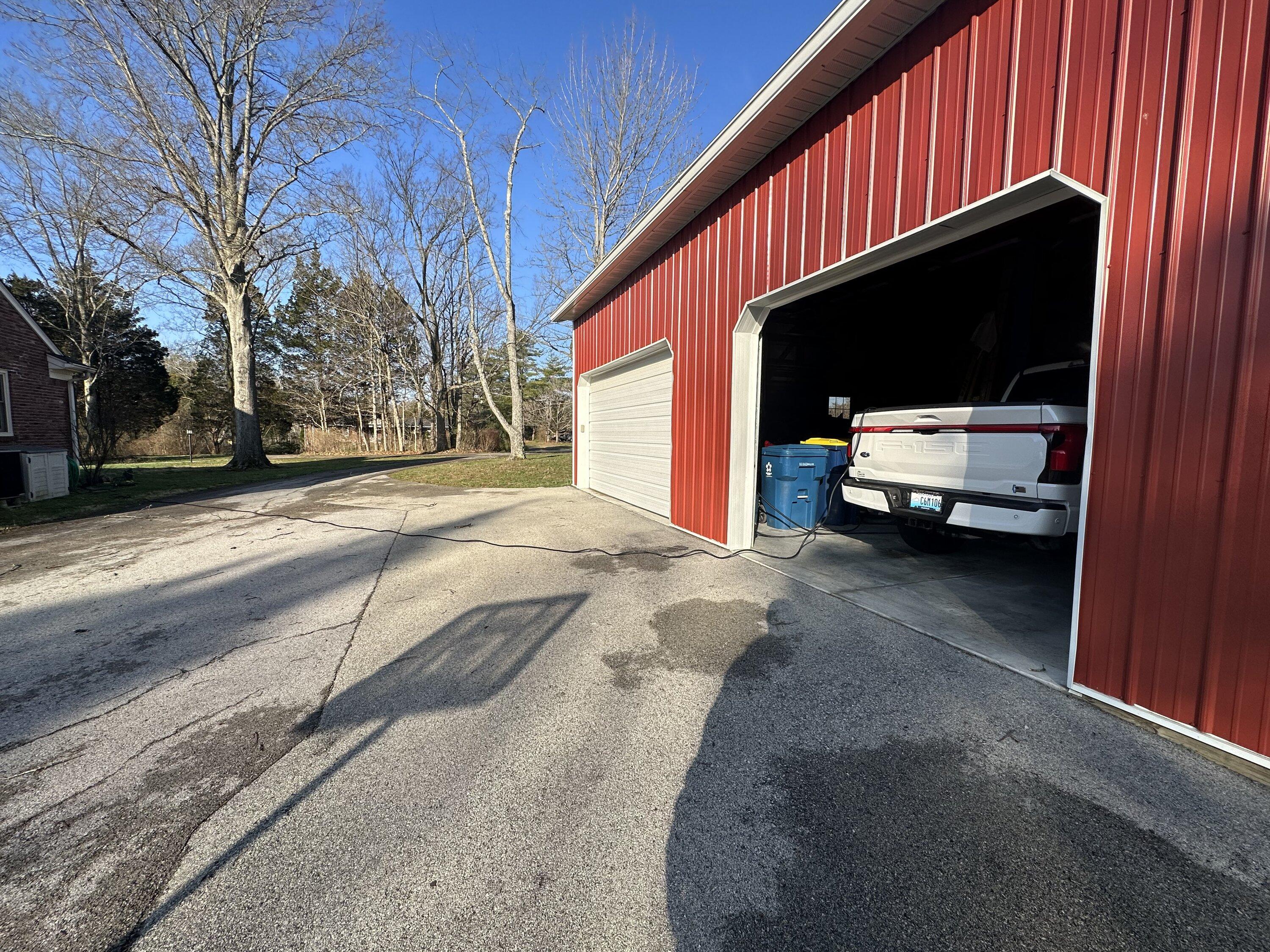

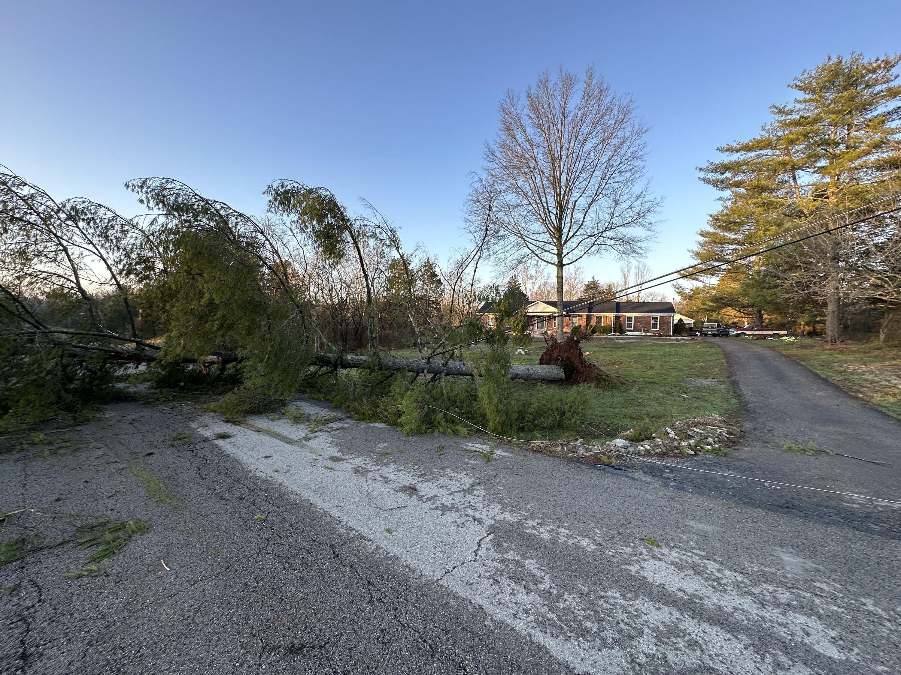

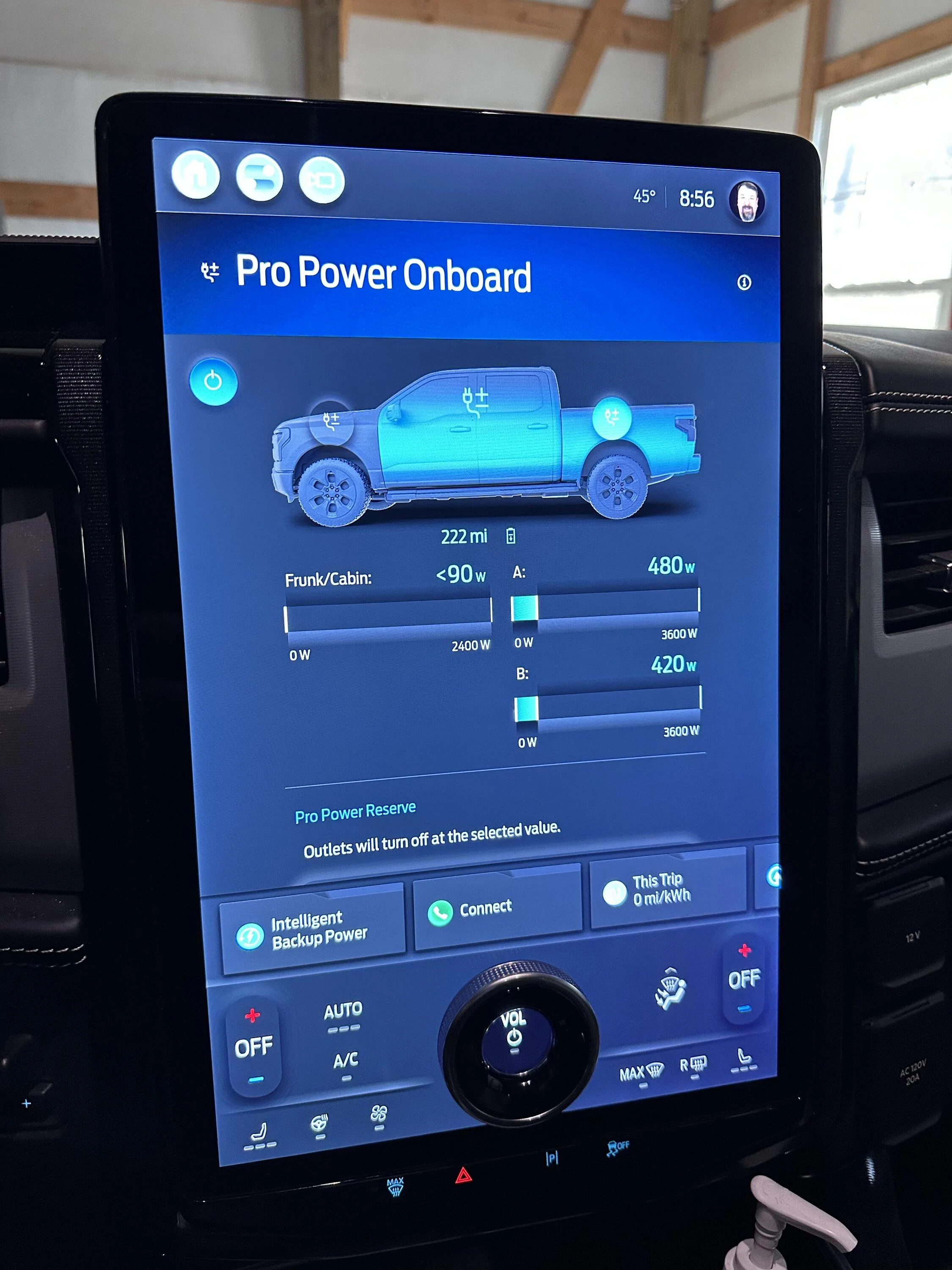

We had a huge windstorm come through yesterday and lost power all over the city, including my house. My neighbors tree fell and took out a pole, so it’s probably going to be a while.
Ford F-150 Lightning Lightning is keeping our lights on after storm! 8A31C61E-8836-47DE-BCCC-994E3B3B3901

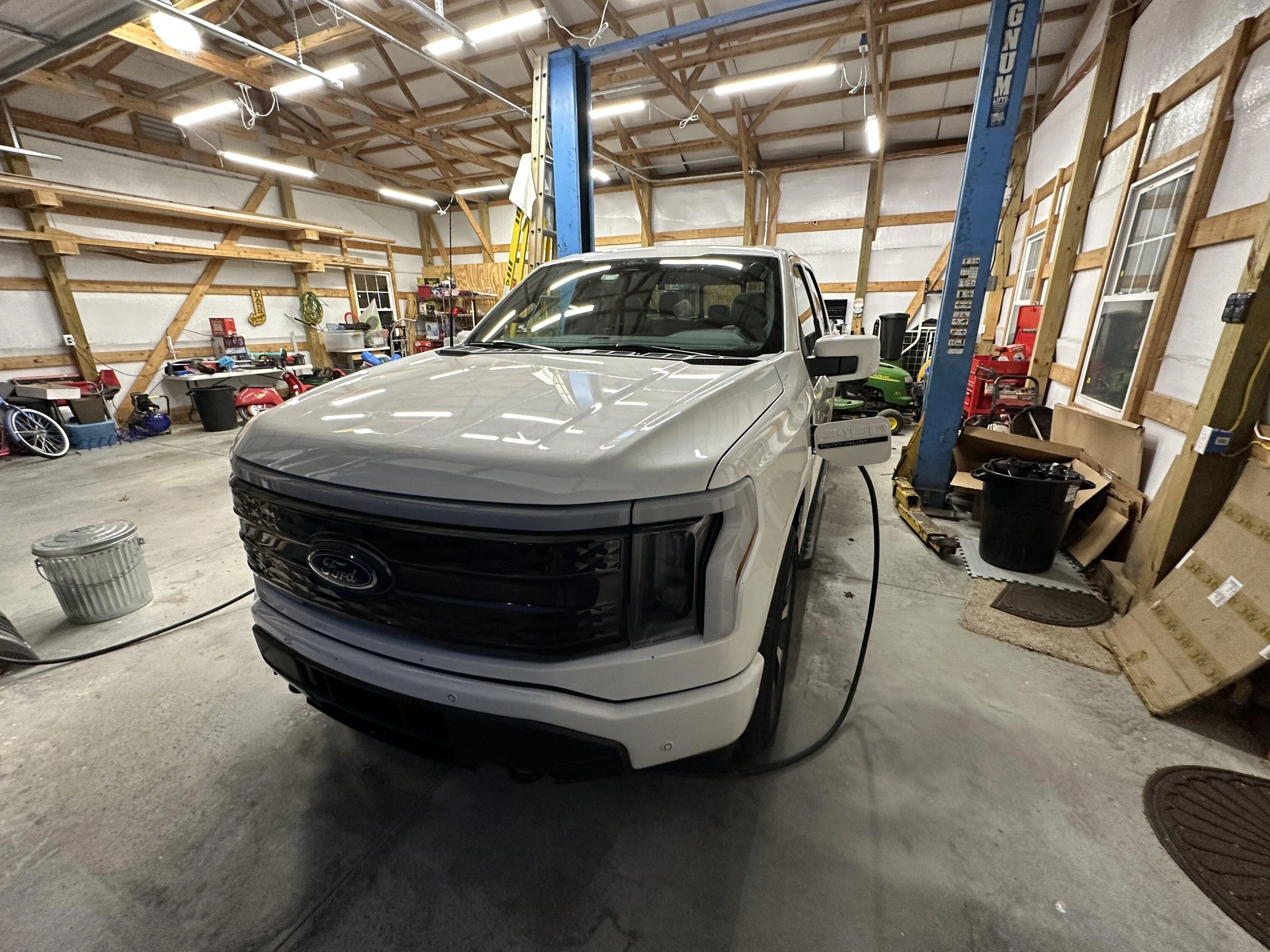

Thankfully I was ready and had the cord layed out to switch to pro power on board. First time I did, it failed saying it needed service. I disconnected the 12v battery for a minute and then it worked like a champ!
Ford F-150 Lightning Lightning is keeping our lights on after storm! F4BE6750-7841-47E4-9272-1754DD8166DC

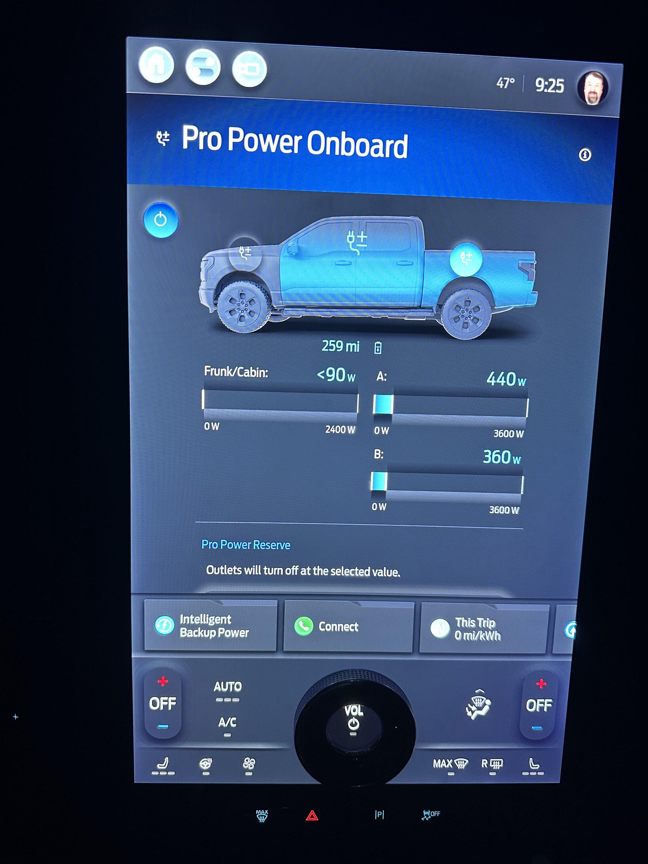

Here is when I first turned it on at 9:30 last night:
Ford F-150 Lightning Lightning is keeping our lights on after storm! 58289E0D-7700-492A-8B5F-A3688F5CC447

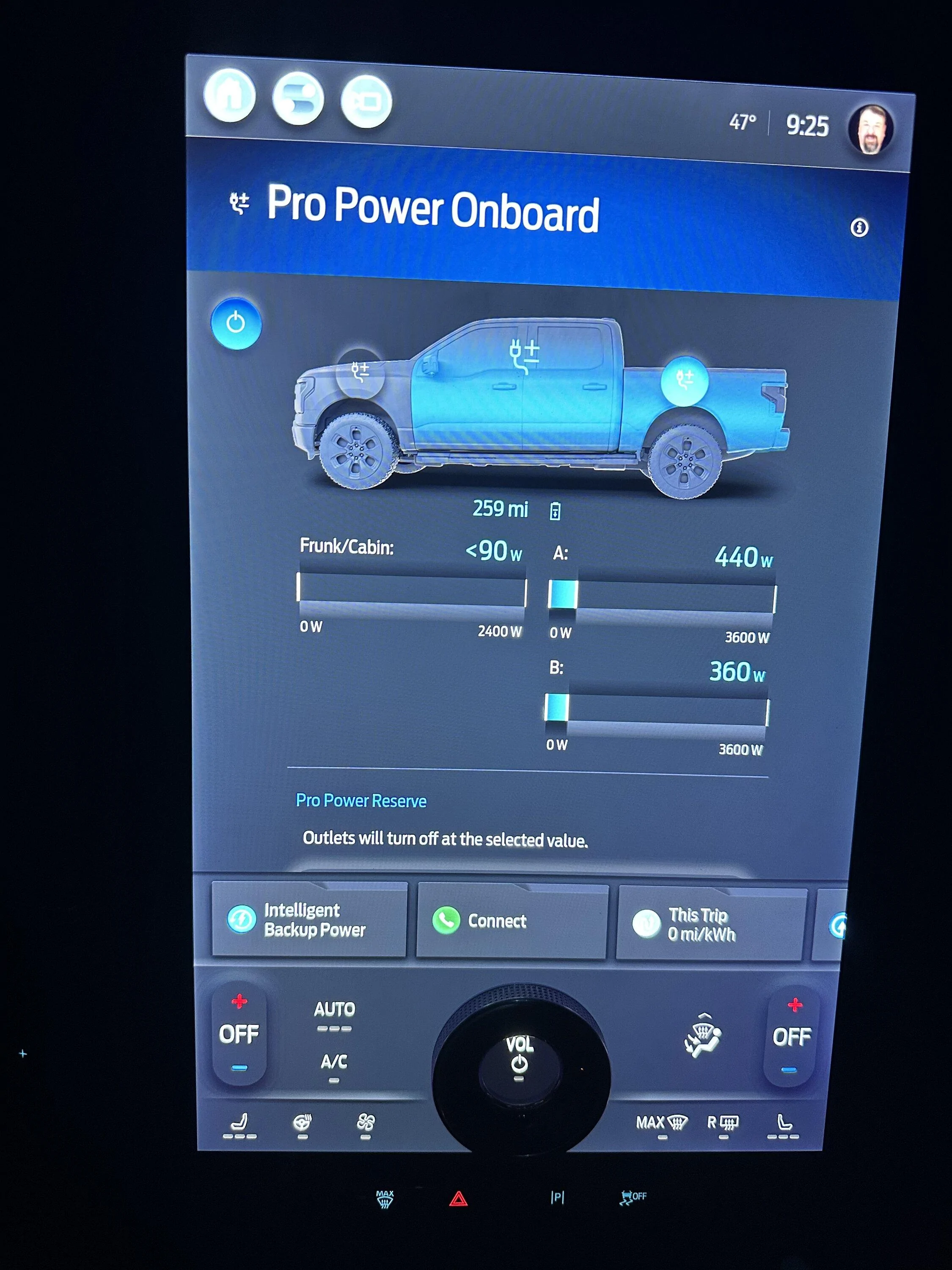

And this is from this morning:
Ford F-150 Lightning Lightning is keeping our lights on after storm! FE52E0B5-AD3D-43D0-8748-8489A15EA6BC
Not too bad, 37 miles of range for about 12 hours of use.

Nice exterior garage! Im jealous

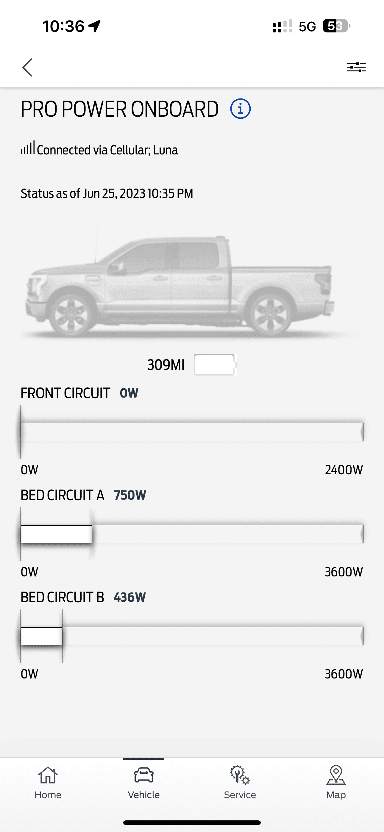

So power is out again after a storm came through. Luna was fully charged to 100% today so I’ve got lots of power to get me through a few days, but hopefully the power gets fixed quickly!
Ford F-150 Lightning Lightning is keeping our lights on after storm! IMG_6985
