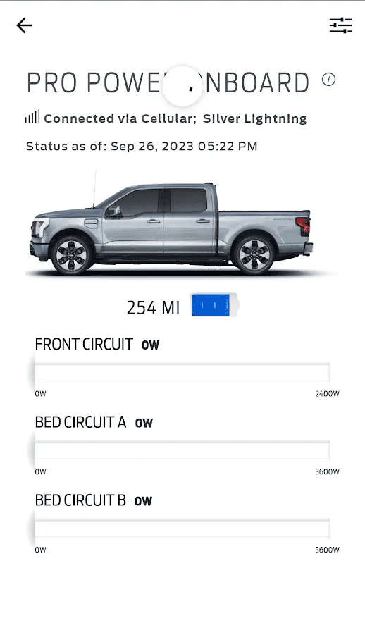

Yes, basic information about load on the frunk & bed outlets:

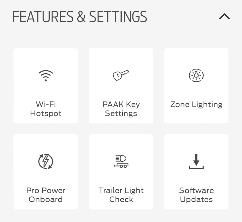

Go to the Vehicle tab in the app:
Ford F-150 Lightning Post Storm, Lighting is keeping things going 1695764113496
Main display as shown with truck "running" and the Pro Power turned on in the truck Sync console, switch on bed or frunk outlet groups as the needs might require, assuming all are on this is what you will see in the app:

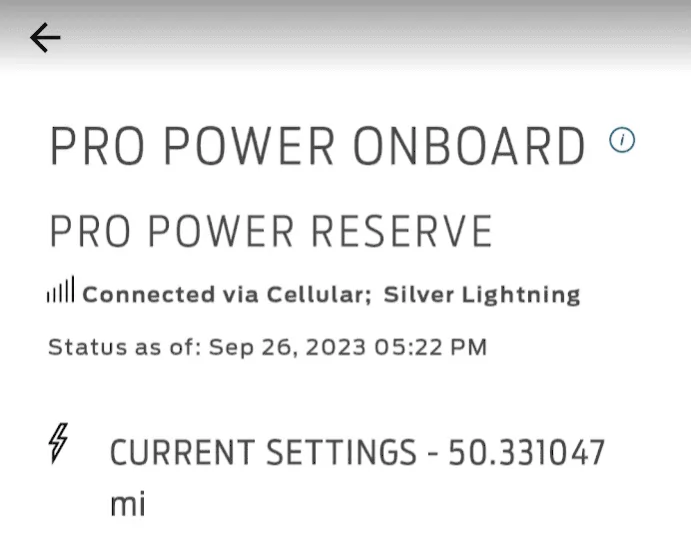

Clicking the settings icon in the upper right corner, informs you of the reserve settings you selected.

OMG this is exactly what I was looking for. Thank you, thank you, thank you,! Im so disgusted with the manual. It says nothing about this. Very few screen shots almost as if they were charged extra for the graphics. It should be much more visual for something this complex.
My FordPass App only shows the front circuit. No bed circuit 1 or bed circuit 2. I have used them before to run power tools. Maybe I have to turn them on or open the cover to have the app sense them.

Turn on the circuit from the Sync touch screen, then refresh the app.

Worked, thanks again!

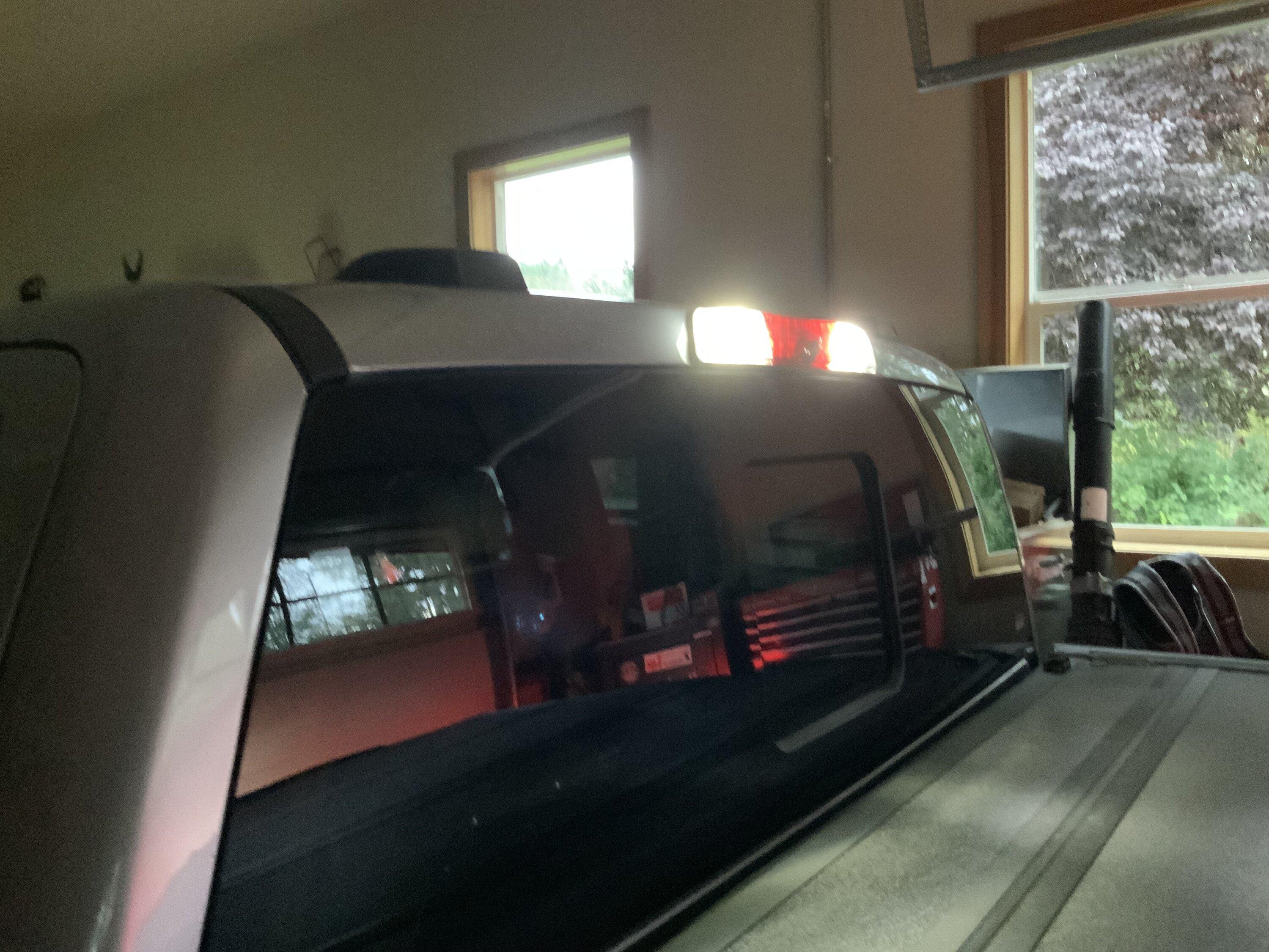

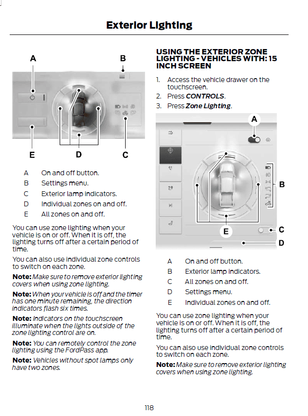

To anyone: Are the lights on the back of the cab above the sliding rear window suppose to always be on? Can't seem to turn them off. They do go off when the truck powers down. Maybe some type of daytime running lamp? Pretty sure the red is my third brake light.
Go into the ZONE LIGHTING tile on Ford Pass or in the truck, toggle the power button see if that resolves the issue.

Doesn't seem to affect it. Can I change the 30 minute shutdown timer? That would be a real PIA if IU have to go out and reset this every half hr.

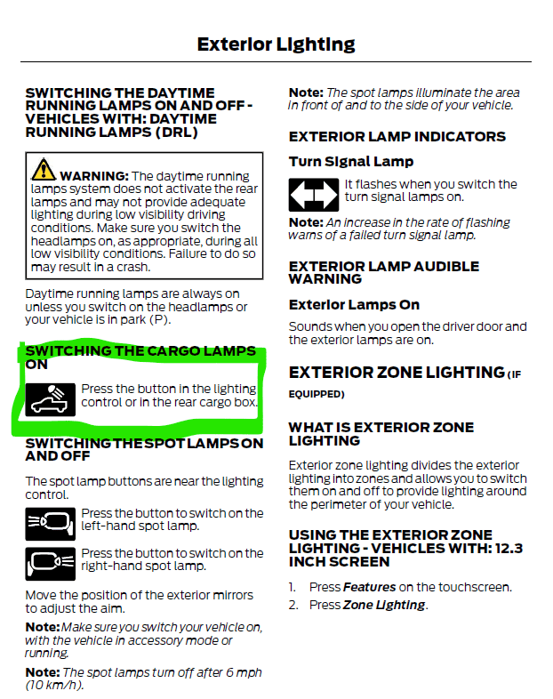

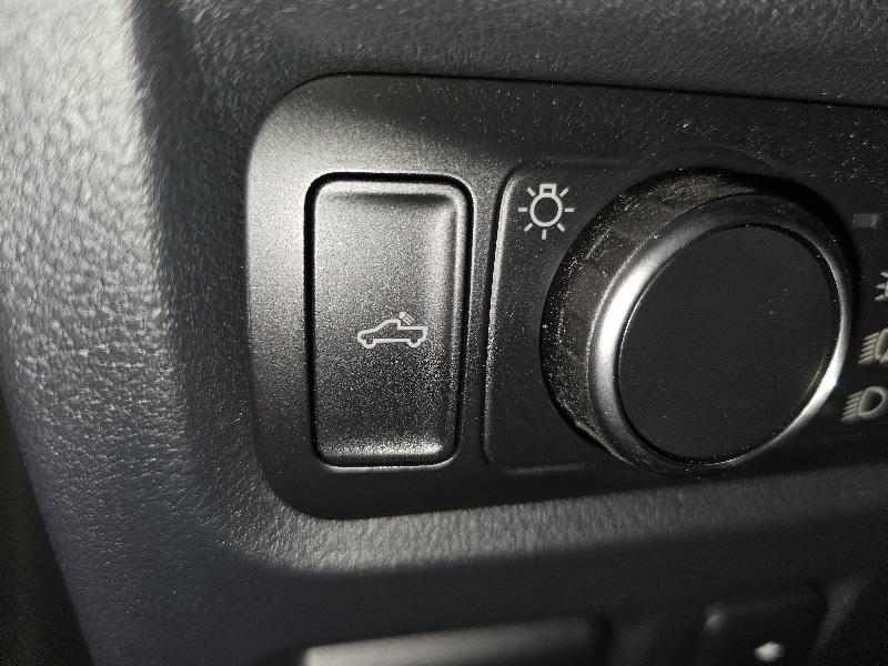

Your bed lights are on. They are turned on and off by the button to the left of the headlight switch.
